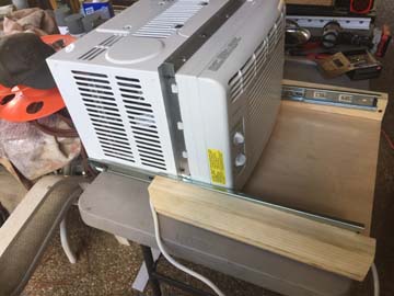

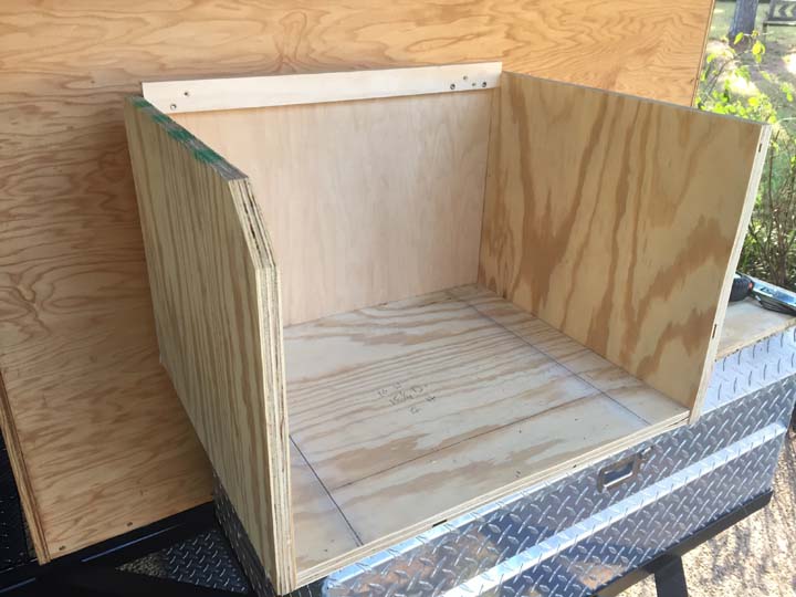

Well I ordered my window ac unit and it is supposed to be delivered today by UPS. I spent yesterday building a mockup of the shelf area that I am mounting it in. My plan is to build my mounts and cut the hole in the end wall for the ac to slide in and out of. Make the aluminum trim pieces for the hatch hole and the door. Get the sliding shelf brackets I plan to mount the ac unit on mounted to the supports. That will be much easier on a work bench to build and fit in my mockup. Then I will be able to take the ac with the supports and just slide them on to the shelf in my camper as a complete unit after I get the hatch done on the trailer. I can then put a couple of screws through the bottom of the shelf up into the support pieces to secure it in place. This way if I ever want to take the ac out for any reason all I will have to do is take out a couple of screws and lift the whole unit out along with the mount.
Patience was never one of my virtues so while waiting on UPS I went ahead and cut a smaller size whole out where the hatch is going to be. This allowed me to measure and mark out where the shelf, cabinet wall, and the roof trim is located on the outside of my trailer. Now when I get ready to cut the actual hatch opening I will have reference lines to help get it all centered and straight. I will have to cut a new hatch door out of some of my scrap and stain it to match the inside of my camper, but I have plenty and cutting the viewing hole was the only way I could make certain I layed everything out right. I will take and post more pictures as I do the different steps. Here are the pictures of my mockup, the viewing hole and layout on the back of my camper. Oh and I decided to try my hand and gas welding my aluminum trim pieces for the hatch. Here is a picture of my second attempt at that as well. My plan is to use 3/4" angle cut on 45* to line the hatch outside and cut. Then make another one to fit inside that one from the inside and offset the inside one 1/8" to the inside to allow room for weather stripping for the door to butt into. Both of those to be held in place with flat head screws into the edge of my wood and counter sunk flush. I have not decided what I will seal the inside piece to the outside piece with yet. Maybe just some rv caulk. It would be great if I could weld the two together since they would both be put in from the out side. What to do what to do.....
ac cabinet mockup

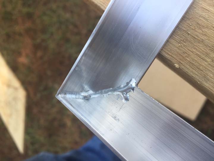

Second attempt at aluminum gas welding
2016-10-26 15.44.05.jpg (49.21 KiB) Viewed 2822 times

Wow. I didn't think you could gas weld AL, but that looks pretty damn good! :thumbsup:
Re: Away Wee-Go
Postby bbrider » Fri Oct 28, 2016 8:14 pm
KCStudly wrote:Wow. I didn't think you could gas weld AL, but that looks pretty damn good! :thumbsup:
It is really tricky. The aluminum melts at 700* and the rod melts at 650* and since aluminum doesn't change colors like steel it is hard to get right. I have a small acetylene torch with a regulator that doesn't use an oxygen bottle. It gets really hot really fast. I heat then touch the rod, heat, touch the rod, etc, etc. When it melts the rod without the heat you just need to touch the flame for a second to keep the heat. Some of mine looks great! Some don't look so great...

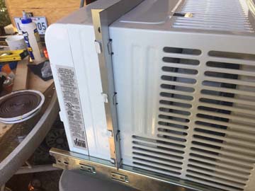

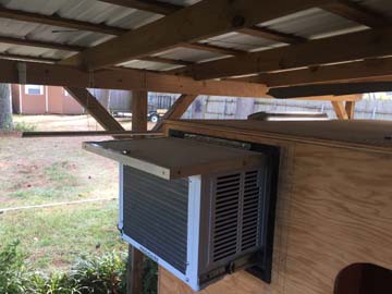

Today I opened my ac unit and marked where I could screw my drawer slides on. Got those mounted.
Slides and trim on ac
2016-10-28 11.07.15.jpg (38.32 KiB) Viewed 2757 times
Then I built the carriage assembly.
Carriage
2016-10-28 12.18.08.jpg (38.02 KiB) Viewed 2757 times

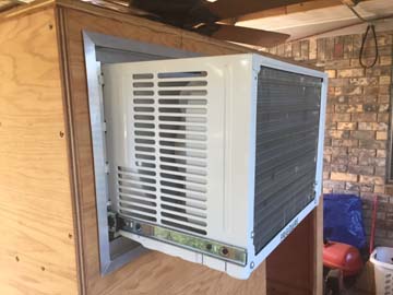

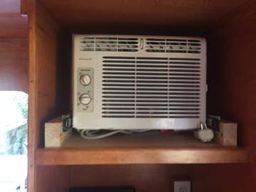

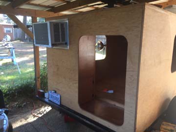

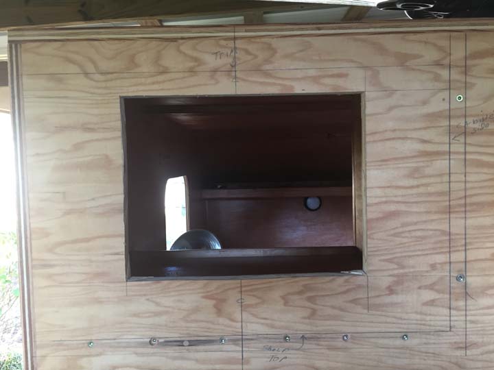

Then I cut the hole in my mockup to test fit. Ok so now or never, I transferred the marks to the wee-go and got out the saw. Put the ac and carriage unit on the shelf temporarily to test fit. Had to add a clamp at the front to keep it from tilting when the ac slid out, but it worked really good. Then I started cutting my 3/4" aluminum angle to make my outside trim for the hole. Gas welded it together and started cutting the angle pieces to go inside of the trim piece to act as a door stop for the door. After fitting those I spot welded those in place to the outside trim ring. Not easy! got too much heat near the corner once and it came loose so I had to go back and fix that. That corner doesn't look as good now. Lesson learned. Stay away from the corners! Tomorrow I will get some liquid weld to seal the lap joint between the inside and outside pieces of the angle to make it water tight. I haven't drilled the holes to mount the trim ring yet as I am waiting to skin the outside first. That will happen next week I hope.
I still need to make a latch to lock the ac in the opened and closed positions. My plan is to add a pin latch to the trim on the ac and drill a hole in the wood support runners for the pin to drop into in both positions.
AC slid out with trim ring
2016-10-28 15.51.26.jpg (36.34 KiB) Viewed 2757 times

A couple more pictures. I still need to stain and poly the carriage assembly and drill my holes on the under side of the shelf for the mounting screws that will lock it in place. I am thinking about making a drip pan to sit under the ac as a safety catch for any water that might spill out of the ac when in tow mode. This ac doesn't have a drain hole so it will retain some water in it's bottom. I might later on add a outlet in the ac area for it too. Right now I have to plug on the next shelf down to run it. I am beginning to believe there is no end to the things you can do to these...LOL. Money and time is the only stopping point. It is getting really close. If I can get it skinned next week all I will need to do is finish my corner trim on the outside and put my diamond plate trim around the bottom. Install the door and windows, the fantastic fan, and reinstall my finders. Oh and finish the wiring to my battery box. I can see the end! I am pleased to be where I am with it after almost 2 1/2 months.
2016-10-28 15.54.00.jpg (32.29 KiB) Viewed 2751 times
2016-10-28 15.05.05.jpg (31.88 KiB) Viewed 2751 times
AC and carriage setting in it's space
2016-10-28 12.08.43.jpg (26.63 KiB) Viewed 2751 times

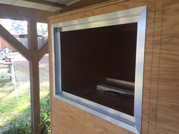

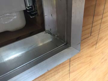

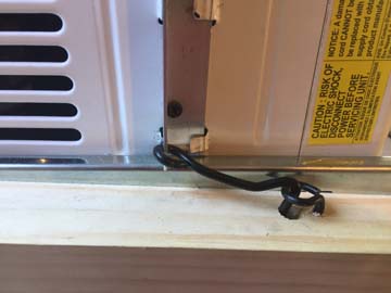

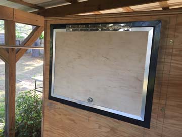

The devil is in the details! That is no joke. I thought I was done with my AC hatch and door other than stain, skin, hinge, lockset, and weather stripping. No big deal. Well got it hinged and lockset in no problems other than one hinge screw broke off. Then I realized there was not enough clearance for the door to lay down on the ac unit. It was hitting the unit at the hinged end before it was all the way down! Not good. Rain would have been funneled back towards the opening instead away from the opening.
Well I always said to walk away and take a break when there is a problem, heck sleep on it even. Came out this morning, looked at it and said "cut the hole at the top 1/4" higher and move the whole hatch assembly up. No harm no foul. Fixed it easy. The trim is still plenty wide enough to cover the bottom.
Also wanted a way to latch the ac unit in place when traveling so I made some latches out of gate latches. The only problem was if they fell behind the carriage when the ac was pushed out it was a pain to get the up again to close it back up. Not enough room for my hand to reach back there. To fix that I made a bungee cord with eyelets on each end that would go over the top of the ac unit. Now I put that on the latches and when I get ready to shove out the ac I just pull the bungee over the top of the ac to hold the latches up out of the way.
Thursday is looking like skin day. Found I was missing the screws for my window trim ring so I had to get those coming. That should have me ready to install the windows and door by middle of next week. I will be working on the corner trim and bottom trim in the mean time. Mattress is coming in tomorrow. Curtains are done. I may be ready to go camping in a couple of more weeks! Ayyy Eeee! That's Cajun for Oh Boy! LOL.
Anyway here are the pictures.
2016-10-29 13.49.40.jpg (28.89 KiB) Viewed 2610 times
2016-11-01 15.22.57.jpg (35.67 KiB) Viewed 2610 times
2016-11-01 15.37.29.jpg (33.33 KiB) Viewed 2610 times
