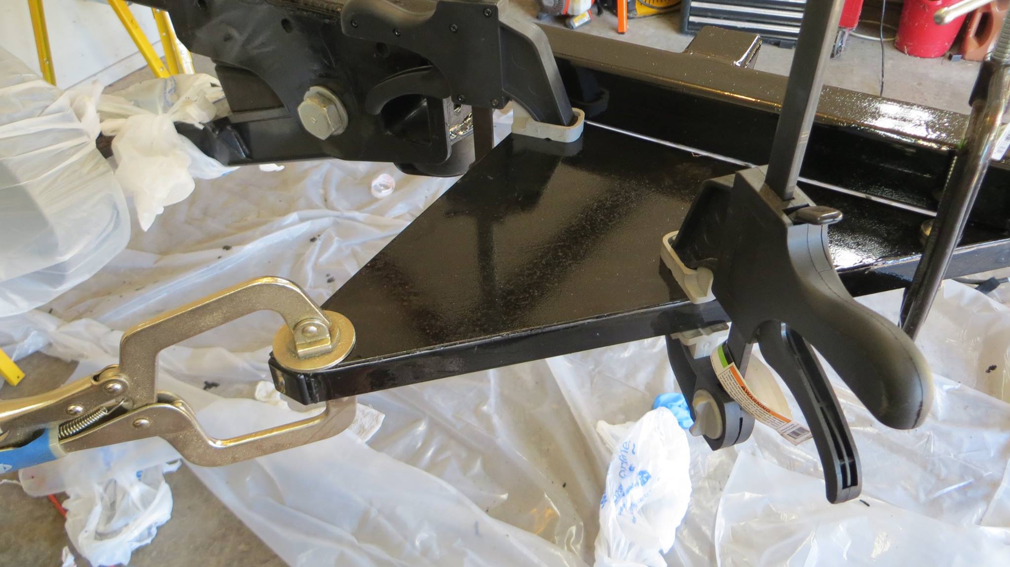

Got the side on
Used VHB tape on these and will tack the corners

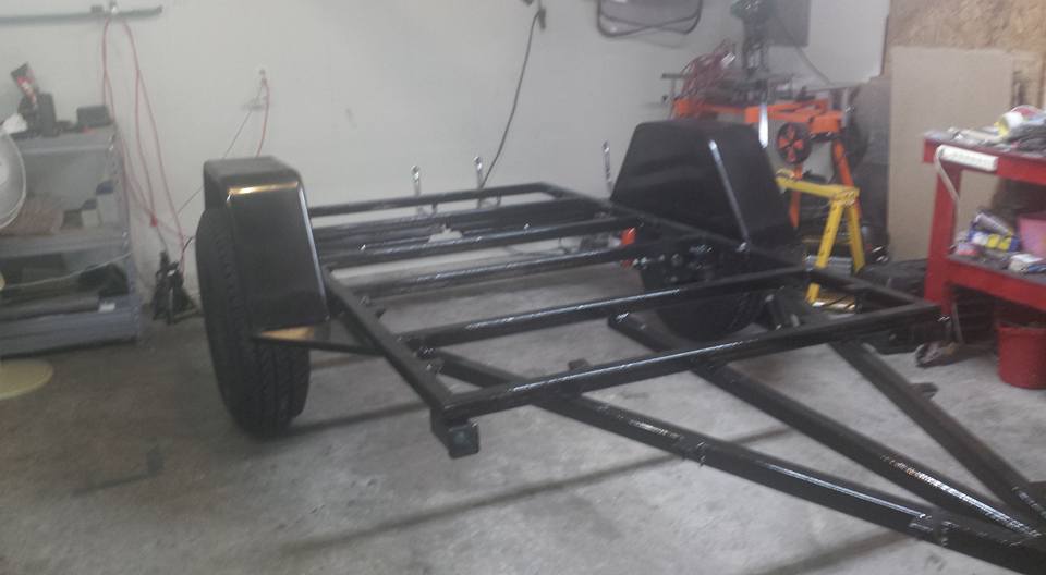

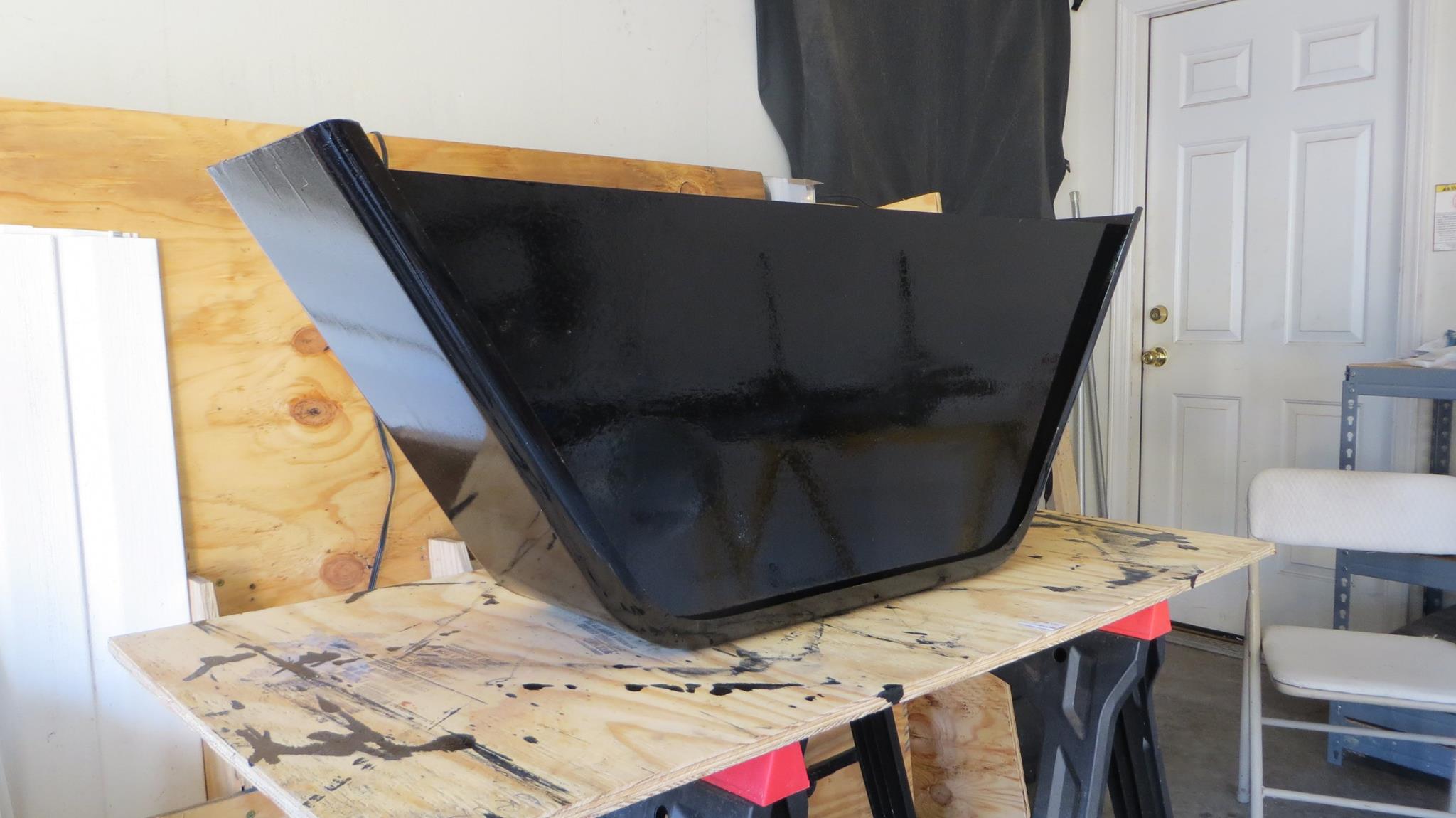

Postby DWT77 » Mon Oct 10, 2016 7:29 pm

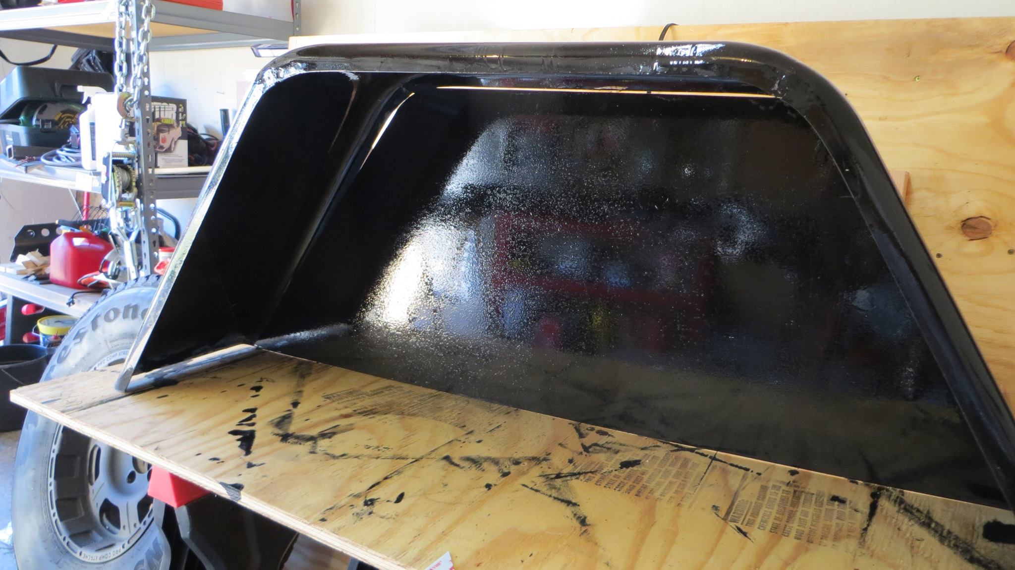

I'm going to have about a 1 inch gap between the fenders and the wall of the teardrop. I decided to put a backing on the fenders. I still need to weld them on

Re: Off Road Grumman 2 (5x5x10) Build

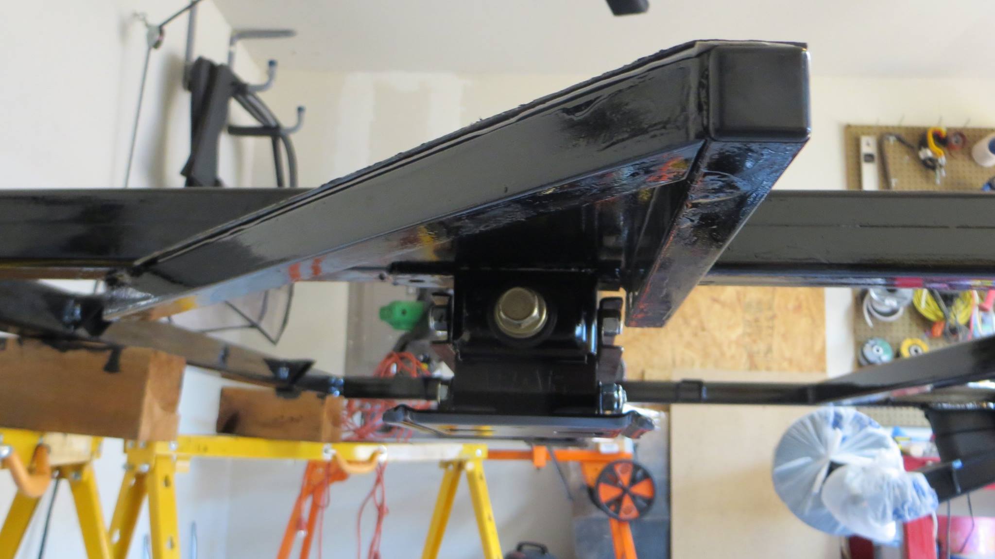

Postby DWT77 » Mon Oct 10, 2016 7:30 pm

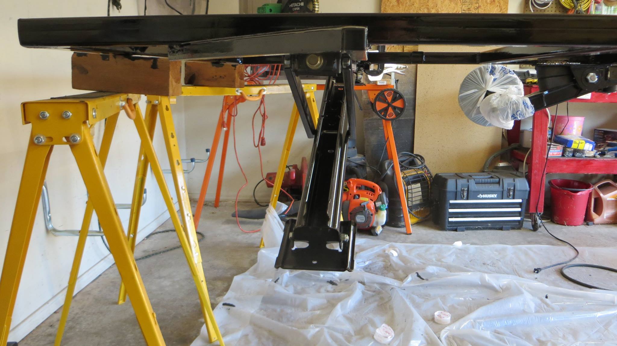

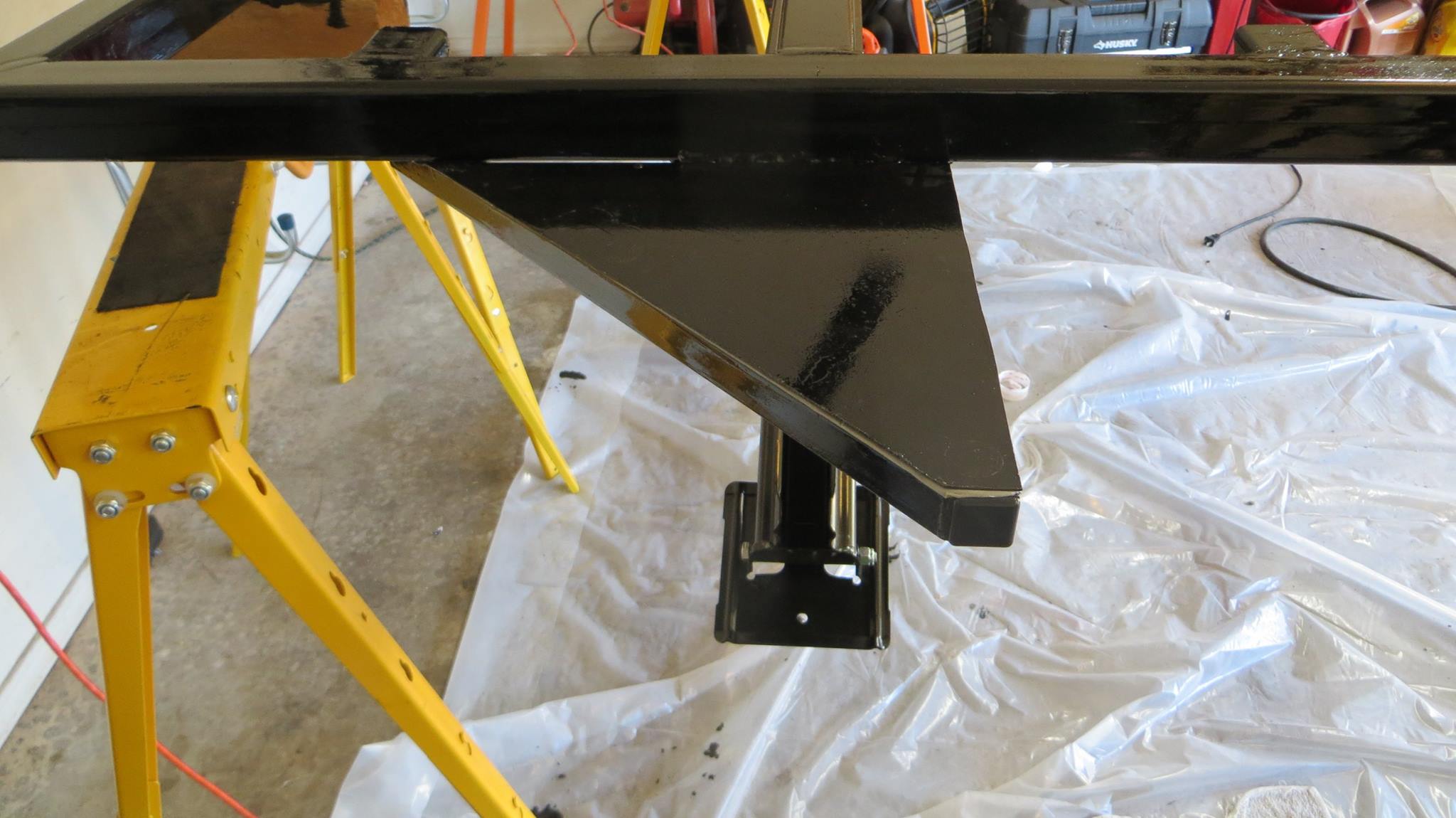

Got the stabilizers welded on.

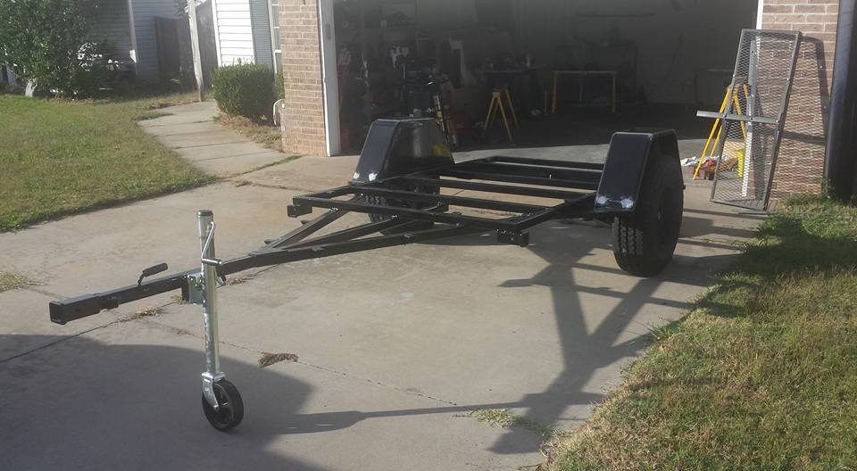

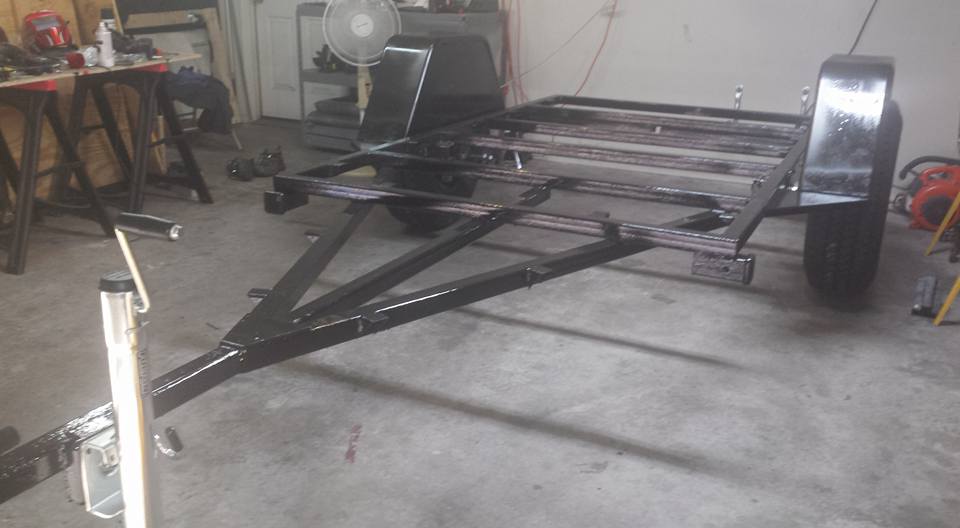

Postby DWT77 » Mon Oct 10, 2016 7:33 pm
I got the second coat of POR15 on. I have gone back and forth on spraying the frame with bed liner or painting it. I have decided to paint it with POR15 2K Urethane paint. Hopefully will get that done this week

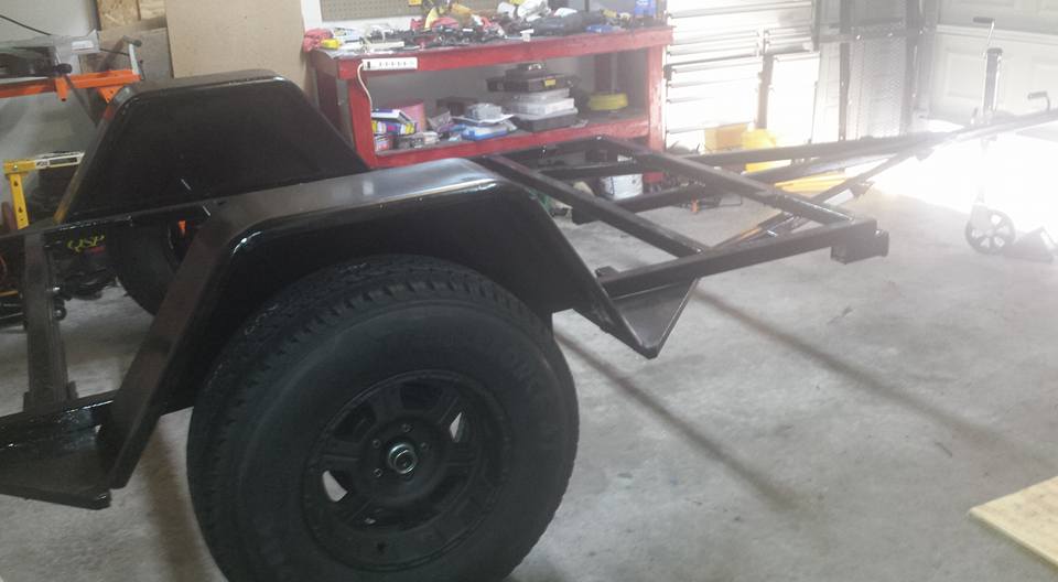

Postby DWT77 » Sat Oct 29, 2016 6:02 pm

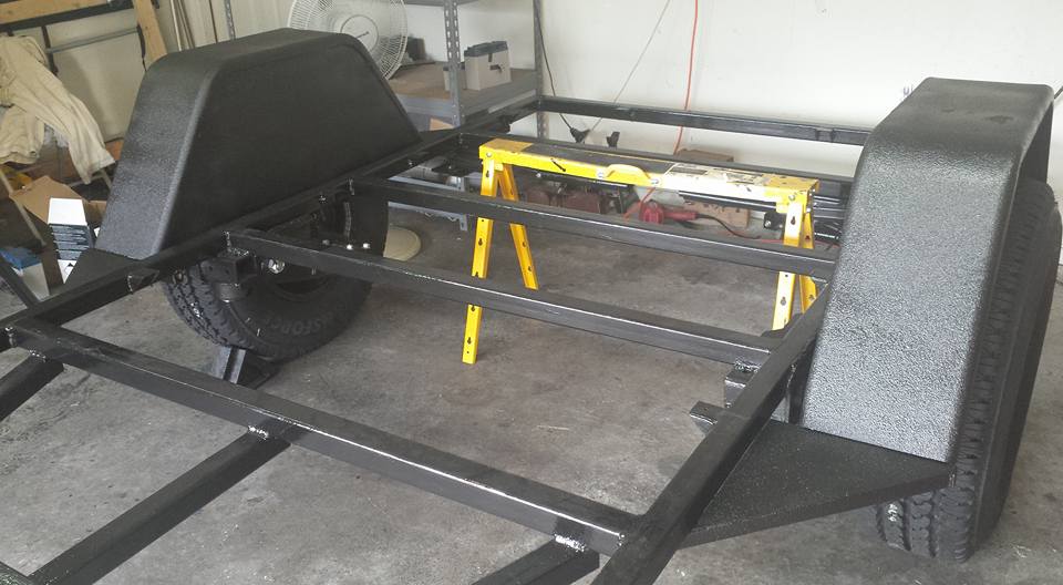

Got the fenders welded on. I was going to bolt them on so I could remove them when putting the teardrop sides on but run into some issues so they got welded.

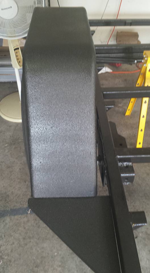

Postby DWT77 » Sat Oct 29, 2016 6:05 pm
Did a little more painting on the fenders after grinding down the welds.
Overall a Quart of POR15 gave me 2 coats and I was able to get 2 coats from the 2K paint as well

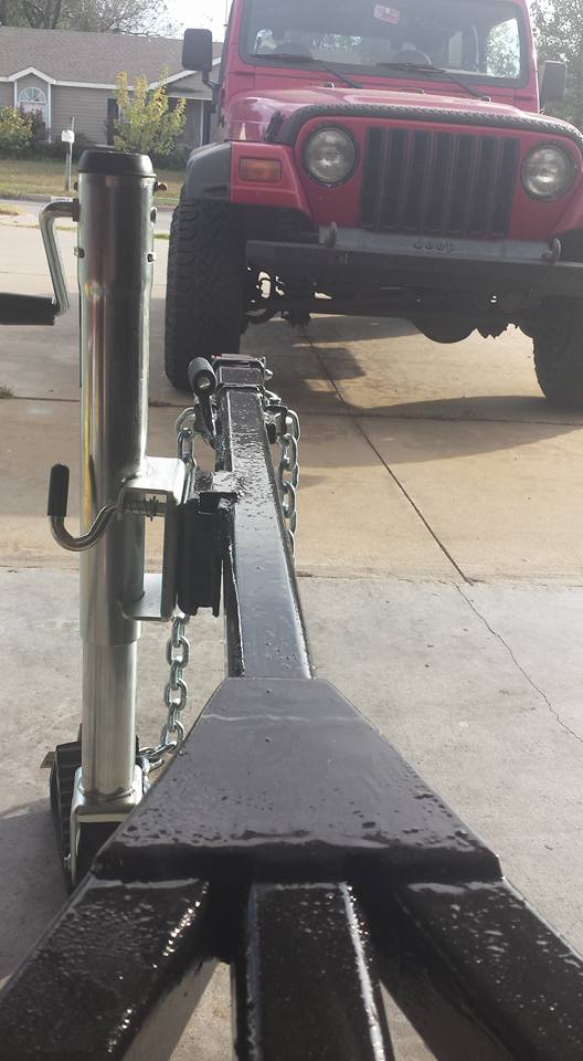

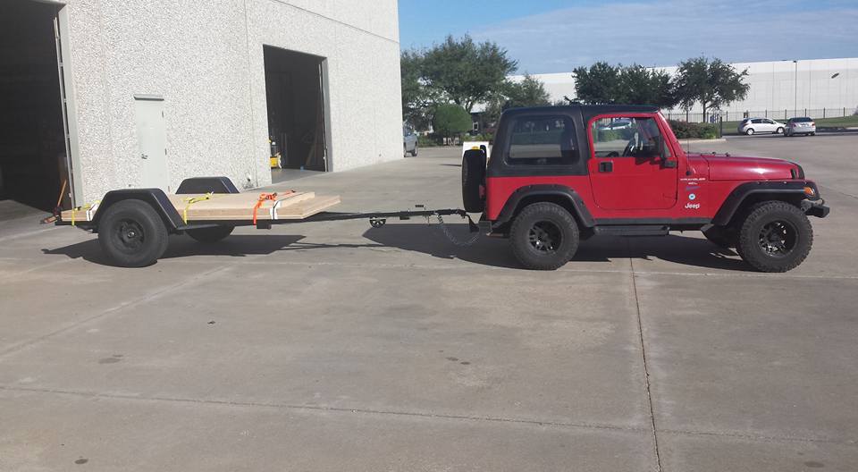

Postby DWT77 » Tue Nov 01, 2016 5:04 pm

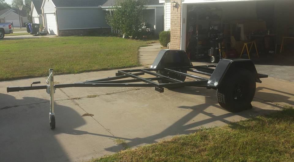

I am going to bed liner spray my teardrop red to match the jeep. I decided to bed liner spray the fenders too. That way they match the texture/look of the teardrop. I also got the chains and hitch on. So it is ready for a test spin. I measured and checked square as many times as I could so hopefully this puppy pulls straight!

Postby KCStudly » Tue Nov 15, 2016 7:50 am
Looking good. What fenders did you use, and did you have to modify them to fit over the relatively large tires?

Postby DWT77 » Tue Nov 15, 2016 6:04 pm
KCStudly wrote:Looking good. What fenders did you use, and did you have to modify them to fit over the relatively large tires?
I went with the Single Axle Jeep Style Fender - 10 Inches Wide x 36 Inches Long x 19.25 Inches High - Fits 13 - 15 Inch Tires. I did have to modify them. I looked at some pictures online without the fenders being modified and that just looked like the fender sat up really high on the teardrop wall. I wanted mine to be a little lower.
I cut slits in the 4 curved part of the fender. That allowed them to be push/pulled out pretty easily. I took the deflection of the timbren axle which was about 6 inches. So I put a 4x4 and 2x4 piece of wood on top of the tire. From there I just kind of eye balled it out to what looked decent. Which that took the length of the fender from 36 inches to 44 inches and still high enough that even if my wheel bottoms out it still wont hit the fender. It definitely was trial and error and made a couple of mistakes and learned a couple lessons.
I didn't find any that were wider than 10 inches. I would of liked a 12 inch fender. Given the time I spent with these fenders, I probably should of got some 1 inch tubing, 14 gauge sheet metal and try to make them myself.
