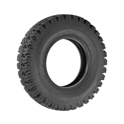

These are the tires I have ordered.

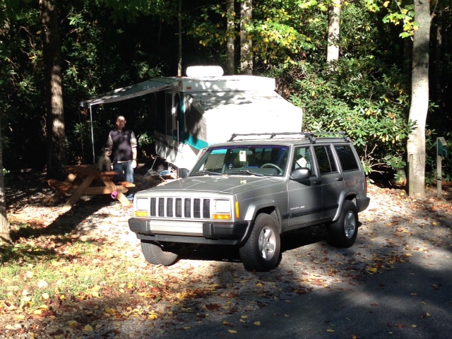

Here's a pic of the XJ and pop-up at Mama Gerties, near Black Mtn, NC.

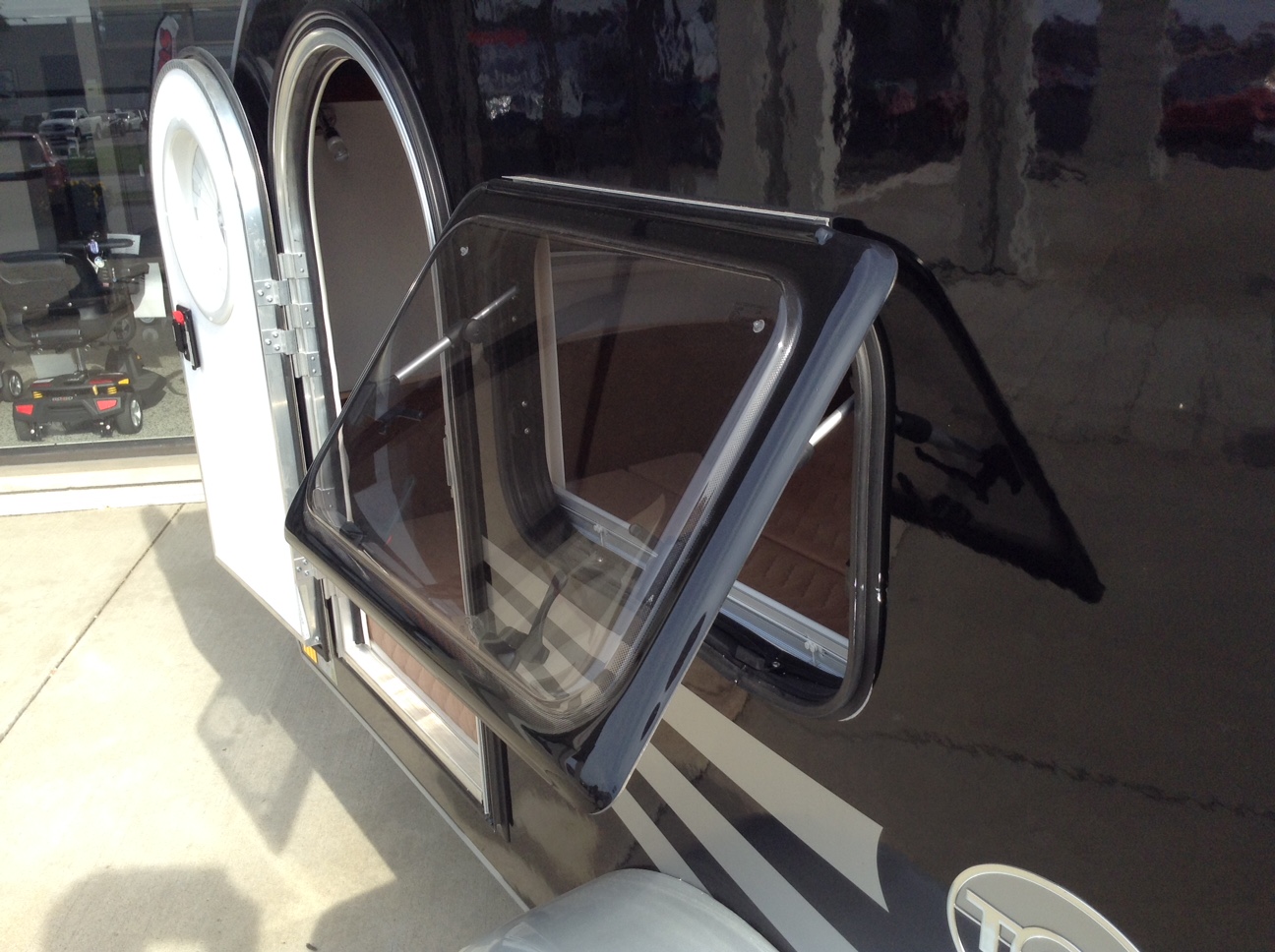

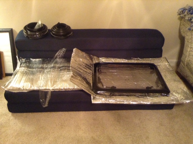

Postby kokomoto » Thu Dec 01, 2016 7:11 pm

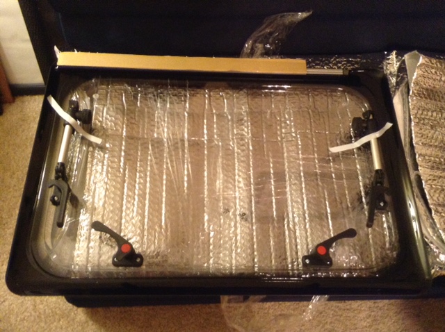

The tilt-out windows arrived today from the nice folks at Little Guy along with the rubber seal kit. The foil bubble wrap might double as sun shades when needed too. :thumbsup:
They are approximately 23" x 15".
The mattress in the top picture is the Milliard tri-fold. It's comfortable, and was less than $150.
RAKA 6qt epoxy kit arrived this week as well.
I plan to begin assembling the sandwich floor tomorrow. I'll be using 1"x3" spruce for the frame sandwiched between 2 1/4" birch plywood boards using the T-88 epoxy. T-88 is used in home built wood aircraft, is easy to mix correctly, fills gaps well, and doesn't require a lot of pressure to achieve a good bond. EPS will fill the voids, and insulate the floor. I'll use the RAKA epoxy to seal the whole assembly.
Bought a 1/2" x 1/2" rabbet bit for the router to use for the floor to wall joint. Planning to sit the walls directly on the frame tubing, glue to the floor, and screw the walls to the floor into the spruce boards. I'm willing to be educated if anyone has a better method to consider.

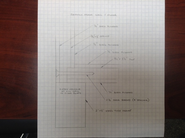

Postby kokomoto » Thu Dec 08, 2016 10:33 am
Wall to floor joint plan -version 1.0
Will this make a solid enough joint for the walls?

Postby KCStudly » Thu Dec 08, 2016 4:56 pm
IMO, yes. Just be prepared to pull the joint in tight during the glue up. You may get some slight bowing in the panels and a long rabbet like that might want a little "encouragement" to pull up tight. You should be okay, but I would be prepared to run some extra screws and/or consider a temporary cleat. You'll be able to decide better once you do a dry fit anyway; just my first thought.
Re: Off-road Teardrop Design/Build
Postby kokomoto » Thu Dec 08, 2016 8:27 pm
KCStudly wrote:IMO, yes. Just be prepared to pull the joint in tight during the glue up. You may get some slight bowing in the panels and a long rabbet like that might want a little "encouragement" to pull up tight. You should be okay, but I would be prepared to run some extra screws and/or consider a temporary cleat. You'll be able to decide better once you do a dry fit anyway; just my first thought.
That's good to know. So an internal cleat would avoid the need to draw the wall into proper position with screws. The internal cleat would use gravity, and serve to keep the joint straight with no bowing. Any problems in using an internal cleat that I possibly haven't considered?

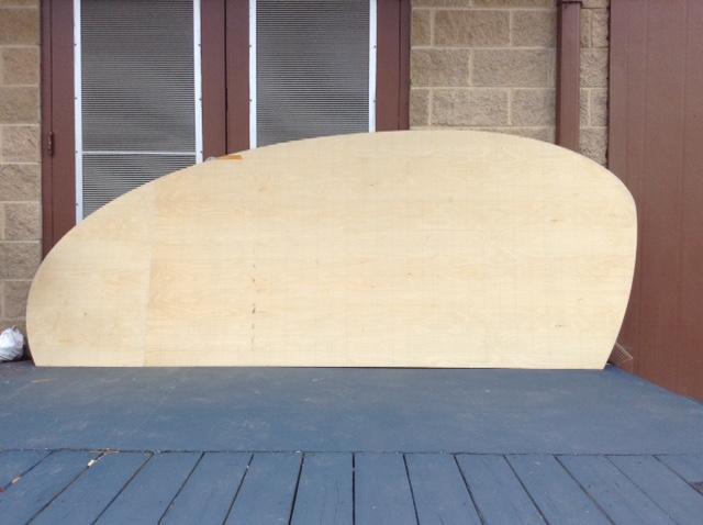

Postby kokomoto » Mon Dec 19, 2016 4:41 pm
Template 2
Template version 2. Ten feet long. Glad I went with the longer design. There should be no lack of storage space in the galley. Now I need to pick up a good tracing bit for the router.
