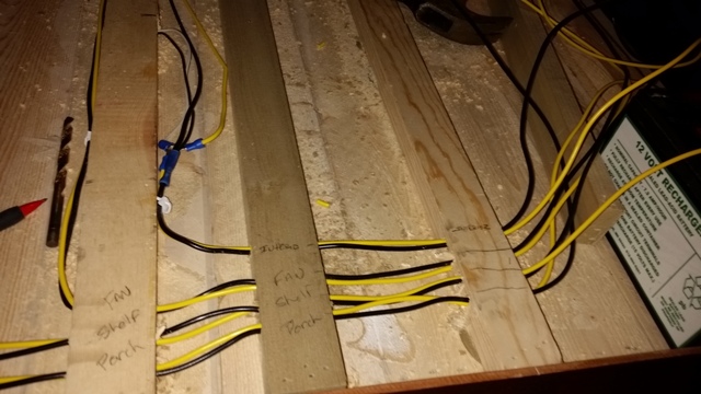

Holy Smoke there dakippen, you keep going like that and you be ready to get that new rig out before you know it!!! :thumbsup: :thumbsup:
It really looks good and the care in the wiring will pay off; wood joints look great, and again... Great job... :thumbsup: :thumbsup: :pictures: :pictures:

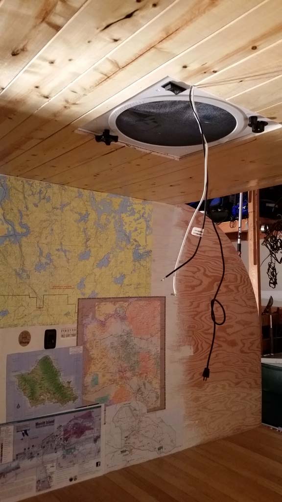

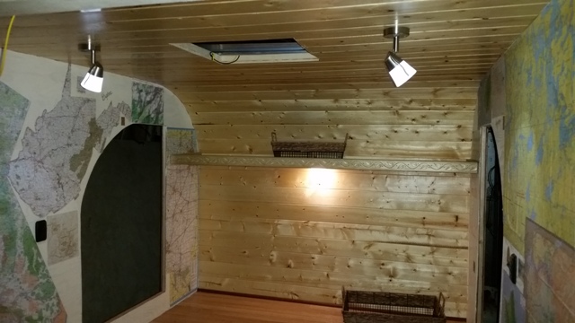

Making some great progress, the interior is just about done. While I'm out of town, hubby is working on the skin and galley hatch..I now have an over the head shelf, more wiring has been done and lights are in place.

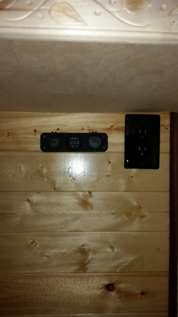

A lot has taken place the last couple of weeks. Most of the wiring is done, other then finishing off the vent fan, the interior is done including an electric outlet and USB outlet. The door frames have been trimmed out, new doors have been cut and epoxied, the last coat of spar urethane was applied tonite. I think we're on track to be done before Mother's Day wkend...

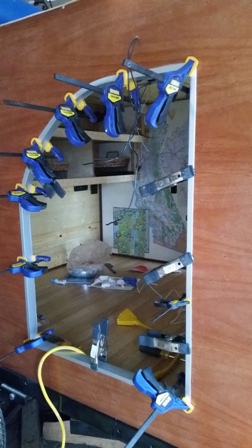

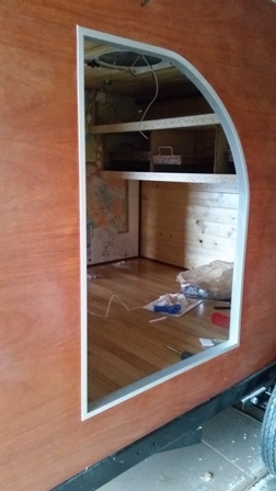

Postby dakippen » Mon Apr 03, 2017 7:15 pm
Door trim - this was a royal PIA! Didn't realize how challenging it would be to bend the aluminum around the curve, but we got it.

Re: Meet Max...
Postby flyguide » Mon Apr 03, 2017 7:41 pm
Bending the aluminum is a PIA. Did you heat treat it first? I took the temper out of all the alum that I put on first

Re: Meet Max...
Postby working on it » Mon Apr 03, 2017 9:05 pm
dakippen wrote:Door trim - this was a royal PIA! Didn't realize how challenging it would be to bend the aluminum around the curve, but we got it.
flyguide wrote:Bending the aluminum is a PIA. Did you heat treat it first? I took the temper out of all the alum that I put on first.
  • I was unaware that heat treating or annealing of aluminum would work for thicker cuts of aluminum, especially the probably inferior grade sold at Home Depot. When I was trying to bend/form my rain gutter/deflector to put around my doors, I tried heating the first piece with a propane torch...all it did was blacken it. I ended up using two extra pieces, after breaking the ends of them. Eventually, I bent the ends successfully, and made them merge into the other pieces. All straight cuts, some bending, no real curves; still took me several hours to get right. I can just imagine the difficulty bending it like you had to, making it conform perfectly to another surface.

Re: Meet Max...
Postby dakippen » Mon Apr 03, 2017 9:14 pm
The second piece we tried heating, but still had problems with buckling. Ended up putting in relief snips along the curve.
