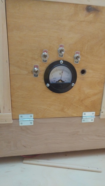

Also got my switch panel started, I misplaced one switch so the hunt is on. Retro looking volt meter in the center.

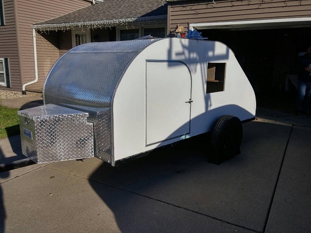

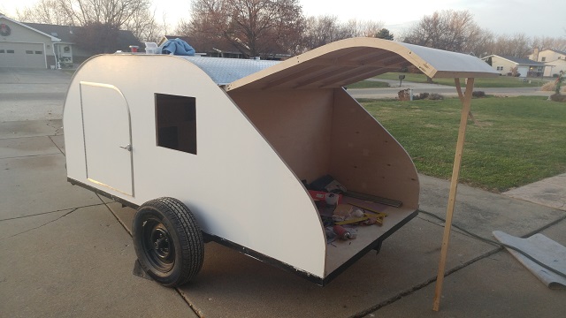

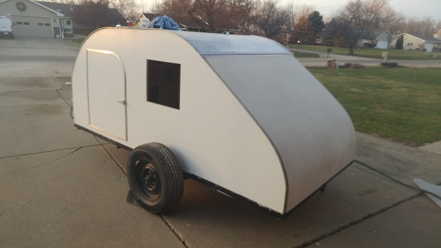

Wife took a couple pics while I had it out side while I hung Christmas lights.

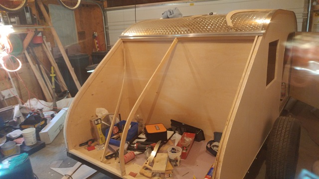

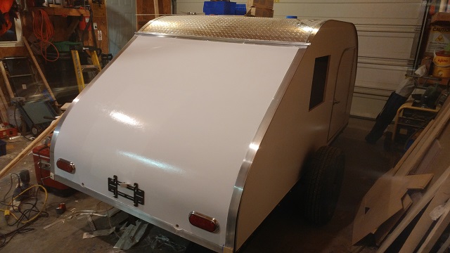

Had a great Sunday, got over the last major hurdle. Made up the galley hatch and test fit. I did put on the latches after the pics just to make sure there were no surprises after PMF. The hurricane hinge is only mounted temp right now, but I am going to mount the fixed side while I am PMF'n the hatch. I will also be building the galley between TBII canvas and coats of paint. I am going with some different products on the hatch. Canvas from http://www.bigduckcanvas.com/categories ... -yard.html and different primer and paint. Trying to get a more uniform texture, with what I learned from the walls, and how they turned out I am pretty excited. :thumbsup:
Wanted to make sure it was setting nice before adding all the ribs and cross braces/ taillight backer.

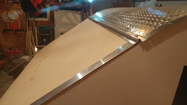

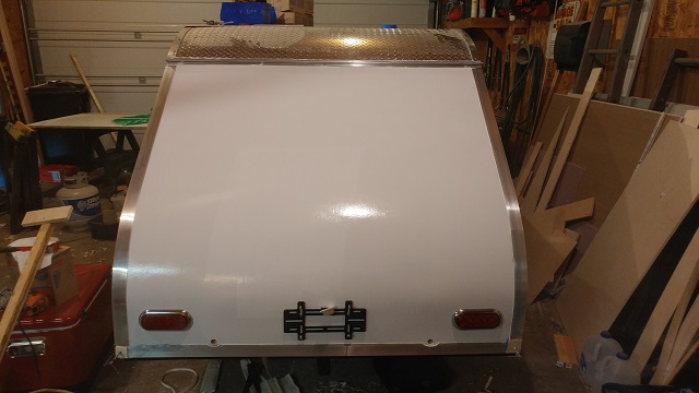

Snuck the hatch trim on for a quick look after pushing it back in the garage, was a great day yesterday for December in Illinois. Tdrop wont be seeing much sunlight after yesterday, until spring anyway

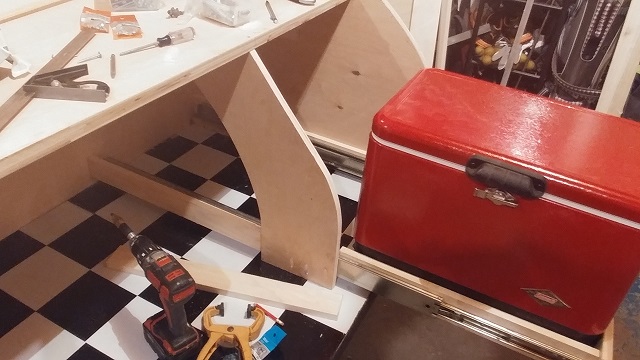

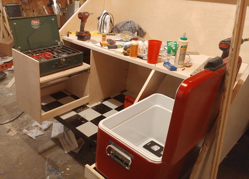

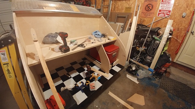

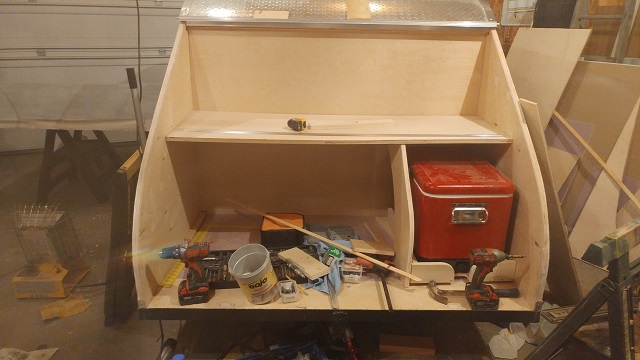

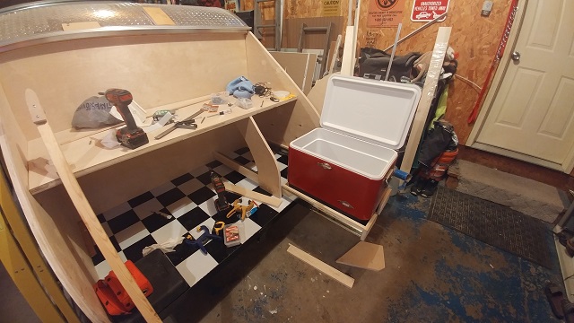

didnt get much done this week/weekend. Took the hatch off and started the PMF. Got my drawer made for the cooler and the counter top started. Nothing in pic is fastened perm yet. Still laying it all out.
There will be a drawer above the cooler, and cabinets on top of counter. On the left will be the slide out for the cook top, and inbetween will be a nother pull out counter top. Withthe long galley we dont want to have to reach in while meal prepping.
Canvas from bigduck canvas went on smooth. Ironed nicer and layed out way better than the drop cloth canvas. First coat of primer is down.

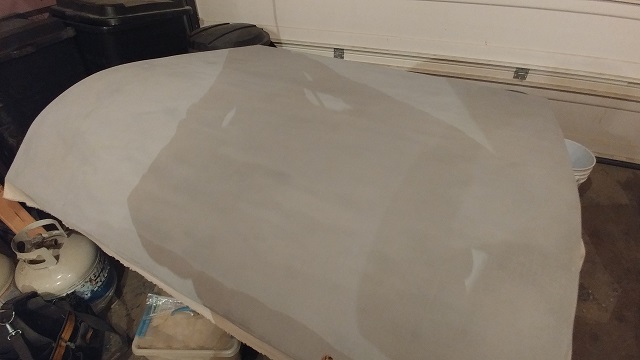

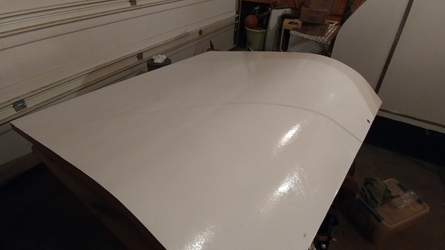

Made some more progress on the galley and the hatch. Got the second counter top cut. First one was set in too far, so I made a fake hatch to get a confirmation that the hatch would clear. Got the floor down, cooler drawer in and got the plan for the camp stove side ready to go in my head. Hatch got its final primer coat. I sanded between the coats. That brought up some fibers. So after it dried I used a torch to singe them and a razor blade to remove them. Turned out very nice and I threw down the first coat of paint.

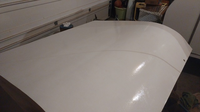

Really happy with how the PMF on the hatch is turning out.
