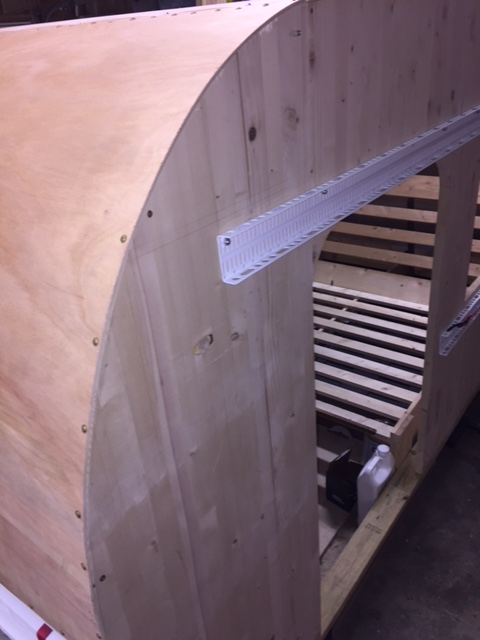

Postby jbell.louisburg » Sun Jan 21, 2018 6:11 pm
swoody126 wrote:DUCKWORKS BBS...don't wander off into their articles or you'll never re-surface ;-)
sw
Hazard noted - I'll try to restrict myself to just those things I can accomplish today (too much dreaming is hazardous !!)
Case in point, $9 lauan plywood, curved without a pop, break or issue.... although it took a couple days to gently coax it into this nice bend....
sometimes patience pays off.

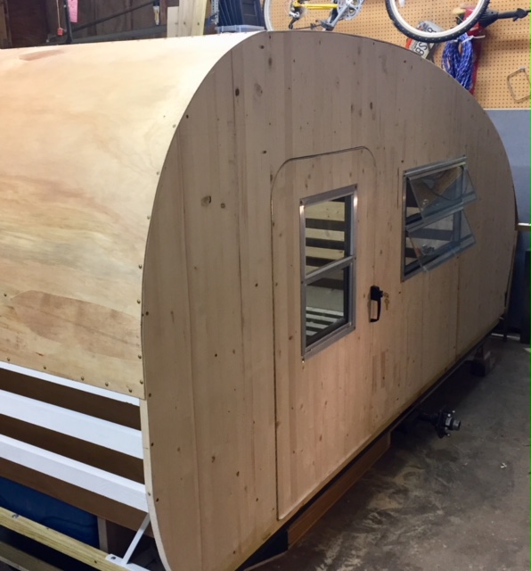

Postby jbell.louisburg » Fri Jan 26, 2018 11:37 am
Thought the aluminum door edging turned out good. I didn't think I could make aluminum angle curve smoothly/cleanly enough.
now onto the door window and the gasket/jams.

Postby jbell.louisburg » Sun Jan 28, 2018 6:48 pm
Staryder61 wrote:You're still moving along and looking good... :thumbsup:
Yea, this isn't a project that can delay... My son's maiden voyage in this is planned for a couple days wilderness first aid in bailey colorado, and then a week of exploring...
WFA in bailey is a week after spring semester is out -- so it's gotta get done by then.
My son LOVES the old shasta windows... these are 2015 reissues -- I still kinda expect them to leak.
Locking Screen door latch will provide strong latching, considering I made solid spruce doors.

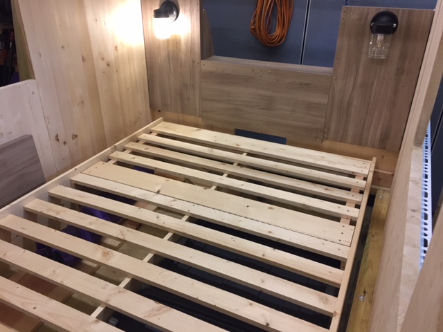

Postby jbell.louisburg » Tue Feb 13, 2018 9:52 am
ok, so these things are cool. I used them for my bed/lounger -- but I can see someone using these for a bunch of other uses, even for holding a hatch open.
