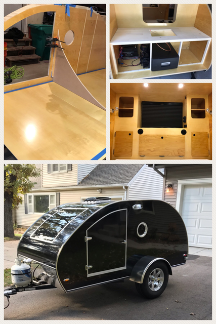

I cut out the door from my wall template intending to use if for the door template, however I made it with rounded corners. I decided that bending aluminum trim around the tight radius of the door corners would be a challenge. Since the door template was already cut with rounded corners I couldn't use that. So instead, I squared up the corners in the door cut-out hole in the wall template and used that for my template to cut the doors. I used a 1/4" upcut bit and a guide bushing. The 1/4" gap should leave room for the trim.

Hi Will, thanks. It's been fun to build. Your post also made me realize I'm way behind in my pictures. The sides and ceiling are on as well as the bulkhead. It actually looks more like a teardrop now. Hope to get those posted soon.
I ordered the axle from R & P Carriages. It's not a torsion axle. My reason for needing the new axle was that there were no brake flanges on the axle that came with the Ironton and I'd prefer to have brakes. I also haven't moved the axle (yet?). I'm going to wait until it's all together and then check the weight distribution and tongue weight. I cantilevered the teardrop towards the front and extended the tongue which should put the axle in about the right spot without actually moving it's mounting point. No welding needed for the tongue. I just drilled holes and bolted it in place.
It's been a fun project with lots of learning as I go. So as long as your willing to learn as you go there's nothing to worry about. Hopefully you will be inspired to start your build.

My trailer will be well under 2000 lbs so brakes aren't required and I think most people would just skip them but I've never liked the feeling of being pushed by a trailer when stopping. I haven't installed the brake controller in my tv yet. I'm not %100 sure I'll be using the same tv when I'm finished. I'll have to defer to others on the factors that go into the bigger wheels. About all I've paid attention to was the bolt pattern so far. I'm also hoping to find wheels with an offset that will take up some the the space between the trailer wall and the wheel.

And presto chango it's done! Turns out I'm better at finishing things than I am about posting progress. Just finished it last weekend. Time to take it out before it gets too cold.
