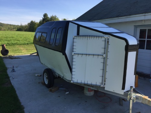

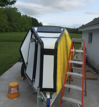

All the exterior panels are in place and zip tied. I ran out of tape so I will have to finish taping the seams tommorrow. I also have the door installed, the concept seems sound, but the seal integrity remains to be seen when my door handles get here Friday I will be sure to update. My solar panel came in and I doubled the weight of the trailer with the addition of the battery.
Solar Panel question...to tilt or not to tilt?

Postby Joel.brian » Mon May 21, 2018 8:19 pm
Looks pretty sweet! I didn’t bother tilting my panel.

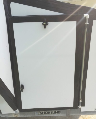

I got the door put on, used a couple of t-handle shed latches for door handles I went with two to ensure a good seal. I have to add a seal strip to the top still as I have a small gap from the contour of the fame. I also mounted the solar panel used some 3m VHB double sided tape to hold it down then gorilla taped the sides because I love gorilla tape and it made me feel better. I also applied some paint to see if it would hold up on the coroplast and tape, it did. So the paint scheme will be bright yellow and black stripes and it shall be called "The Bumbling B".
I even took it for a road test to see if zip ties and tape can handle 60 mph. It did. Now I have to tackle the interior.

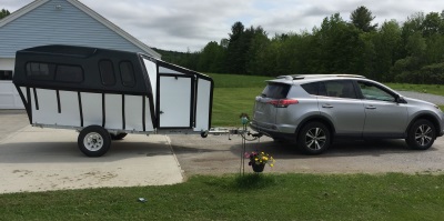

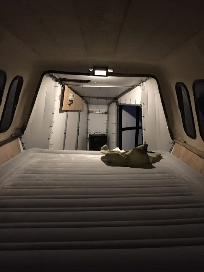

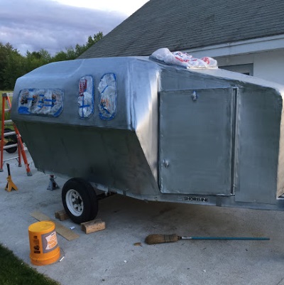

My better judgement prevailed and I abandon the yellow paint job in favor of metallic aluminum. From 15 feet away or going by at 15mph it looks like a legit camper. I used 7/32 under layment for interior panels then I spent a week building some convoluted bench/bed thing that I ended up scraping because Dick's had a great deal on a nice air mattress. I picked up a couple of low voltage landscape lighting fixtures for my interior lighting. I think it is a usable camper.
I still have some minor stuff to finish up but the maiden voyage is scheduled for tomorrow afternoon.
The Silver Bullet
The interior
