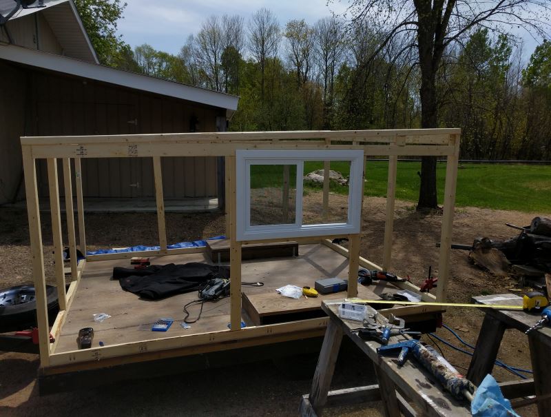

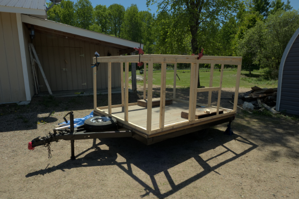

Now, if you look not too closely you can definitely see some.. not straight. I ran out of PL so I had to stop here.. and the hardware store in Barry's Bay was closed on Victoria Day (even though their website said they were open!!!). I have until June 1st To think about how i'm going to fix that. The wood split when I drove the screw into the base beam, so glue is holding that there. I'm probably going to have to carefully remove the screws and saw it out and place a new beam on either side of the crack which I will screw and glue horizontally and maybe file the heads off to keep it relatively level with the rest of the frame. I decided to fully embrace the wedge, once I saw in person how easy it'd be to just cut the ends of the top beam at an angle and not have to worry about fancy joinery. The plywood will still require something.. probably using some flexible tape and rubber roof if I can find a good product. Finding these things for reasonable prices has been somewhat difficult. In the end I may just end up using epoxy and fiberglass or PMF on the whole thing.
The window went in surprisingly well, with just a little bit of trimming. it was one of my major worries besides the door, so at least one thing is going to plan. I intend to see if I can get some vinyl dye once I get to the painting stage and give it a good coating of black along with my other various white plastic bits that will be installed.
*note Im' just using my cell to get these photos. I get glue all over everything, so my pro camera is staying safely packed away!

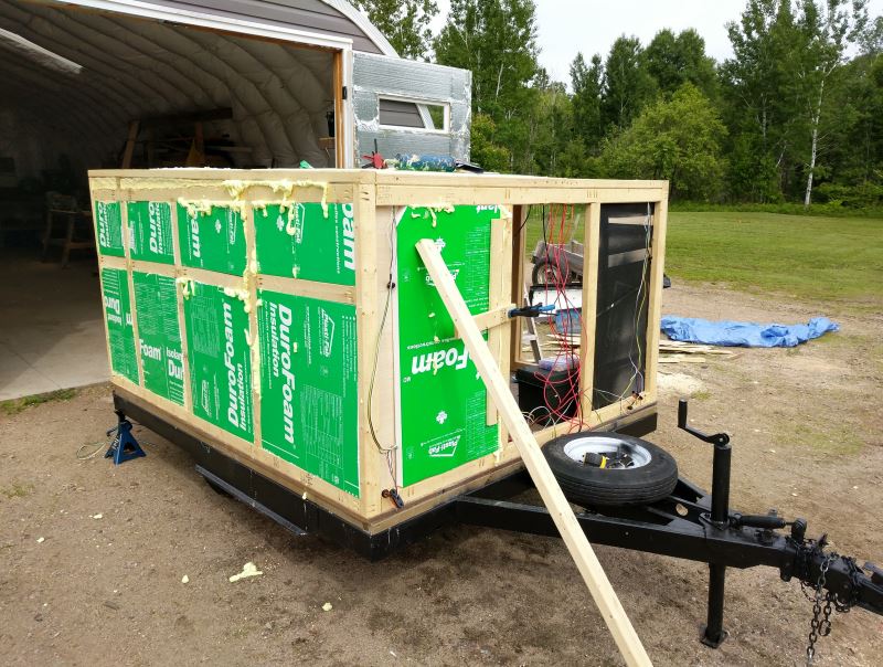

Here's a picture near the time I was starting to put most of the side sheeting on. All wiring in place, and internal lights were also installed. where all the wires are hanging is basically my 'command centre' where I'll be tying in all AC/DC controls and modules.
By the way, that durofoam stuff - it is cheap, but messy to cut if you don't have a very long, sharp knife - or better yet a hot wire. all I had was a utility knife so I made a huge mess. I don't really think it was designed to be cut at all, but it has a shiny side to help reflect heat inside. Next time I'd probably pay extra for the SM - because I ended up paying at least what I saved on spray foam to fix my 'mistakes'

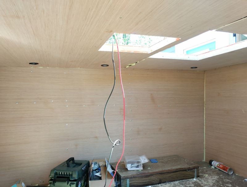

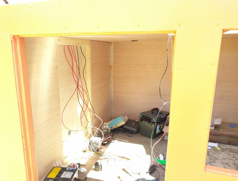

Here's a couple inside pictures, before I installed the window and vent. Quite a mess.. going to hit it with some sanding in places. There's also an issue with the wheel wells not being completely sealed.. but they are completely removable if I need to go that far to fix the issue - nothing is attached to them. I think i'm going to either find myself a good gap filler product, or extend them towards the wall (they will be supporting my 'bed/seat' when i build it anyhow - then get underneath with some spray foam and seal it with rubberized undercoating. have to be careful though, as it will melt foam if you don't spray from a good distance.
