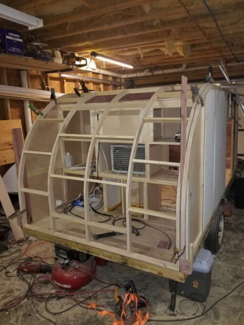

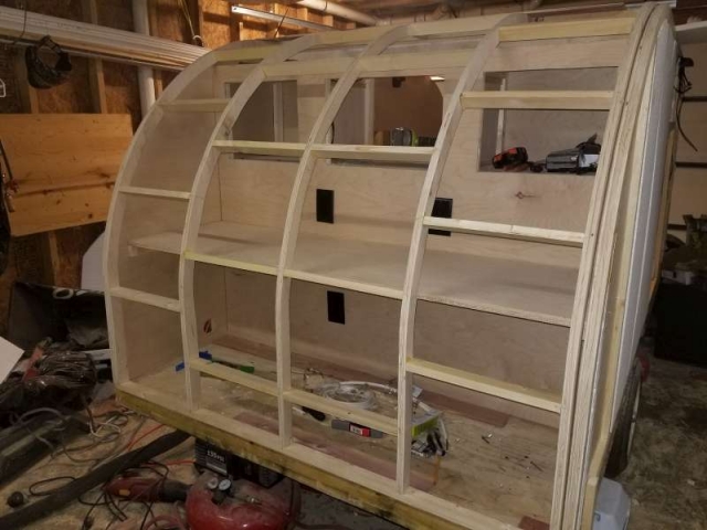

Postby Carl01234 » Mon Jun 11, 2018 7:51 am
June 9,10 2018

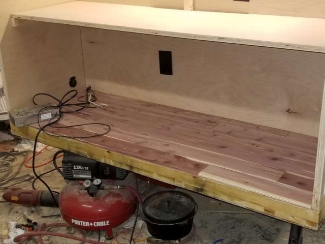

Got a lot done this weekend. It was one of those rare days, where every cut fit just right and and the mistakes were minimal. Was dreading my first ever hatch build. It went without a hitch in less than 2 total hours. Electrical is complete, tested and working. Installed the galley flooring. Was a little nervous cutting the hurricane hinge to fit, but the grinder cut it like butter. Test fit the trim and it lines up well. Not sure how the floor seal will work at this point though?

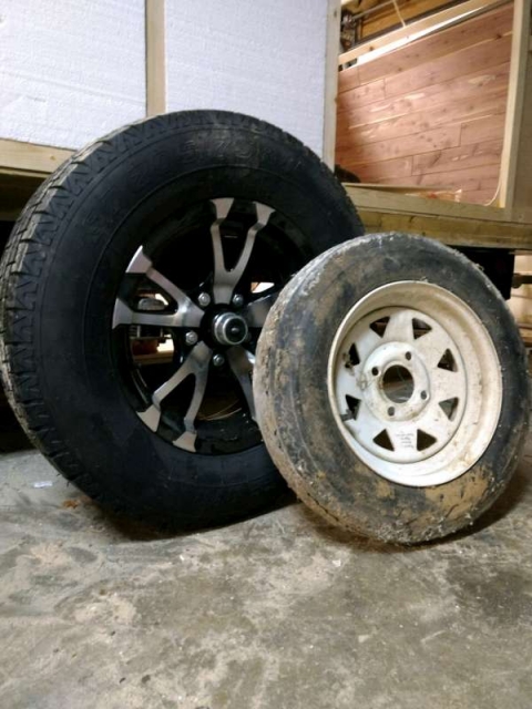

Postby Carl01234 » Mon Jun 11, 2018 8:28 am
New tires and wheels came in. Big difference!

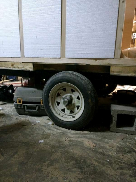

Postby Carl01234 » Fri Jun 15, 2018 6:16 am
June 14 ,2018
Slow progress, but progress. Installed another light under the counter top. I am going to have a swing out cabinet and this light should help light some outside. Installed new axle , hubs and wheels. Northern tool has a direct bolt on 2k replacement axle for anyone that want to go 5ft wide on the HF 4ft trailers. https://www.northerntool.com/shop/tools ... _200648951. This will leave 1.5 inches of clearance. You will need new 4" by 1.5" ubolts. The originals are just too short . I put my wall on top of my floor though and have 58" inside. If you put wall on the side of floor, the 71 inch hub face axle will not work. After putting these tires on, I cant believe, that I put that many miles on the little tire.

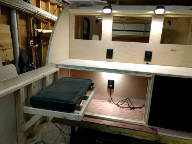

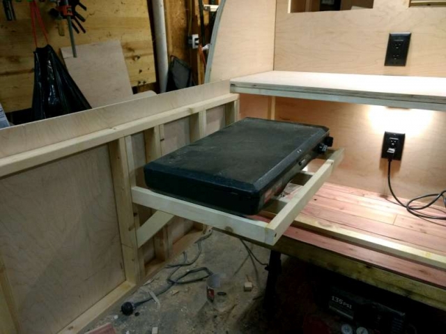

Postby Carl01234 » Tue Jun 19, 2018 6:20 am
Galley work nearing completion. Just need to finish the cabinet doors and add the trim.

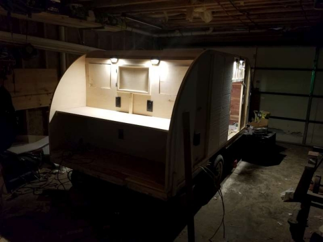

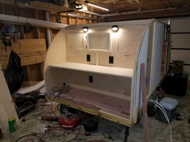

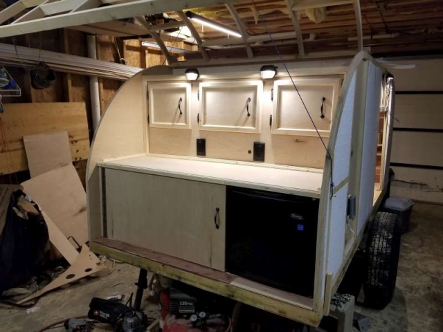

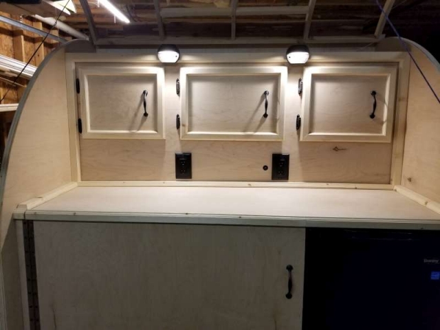

Postby Carl01234 » Mon Jun 25, 2018 6:16 am
June 23, 24 2018
Galley is complete! Finished up the doors and trim work. Also completed the headboard, with built in 3 outlets and 3 usb ports. Time to get the skin on!
2nd Build 5x10 Benroy Complete! viewtopic.php?f=50&t=70427

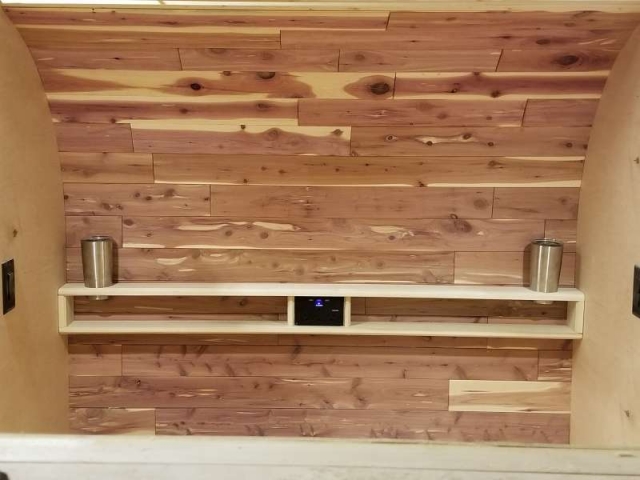

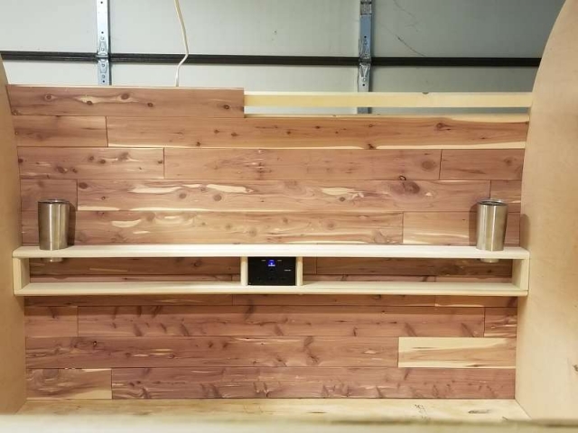

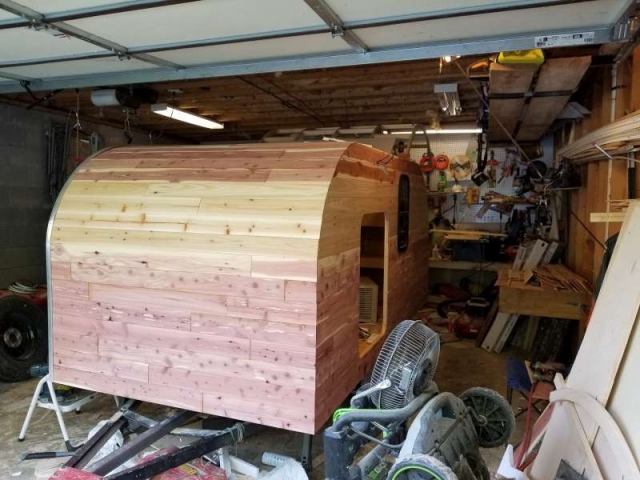

Postby Carl01234 » Tue Jun 26, 2018 6:01 am
June 25th, 2018
More cedar strips going on ceiling. This is going to take a while. Half way done on ceiling, then on to the sides, then the roof then the hatch. I have roughly 200 square feet to put down. Just finished box 2, so only 170 more square ft to go.

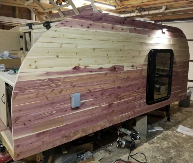

Postby Carl01234 » Mon Jul 02, 2018 6:56 am
June 30, 2018

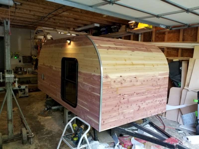

Finished the side wall skins. Took 8 hours for each side. I have half of the ceiling left, the roof, and the hatch to skin. Then it will be on to the glass and epoxy. I can see the horizon now.

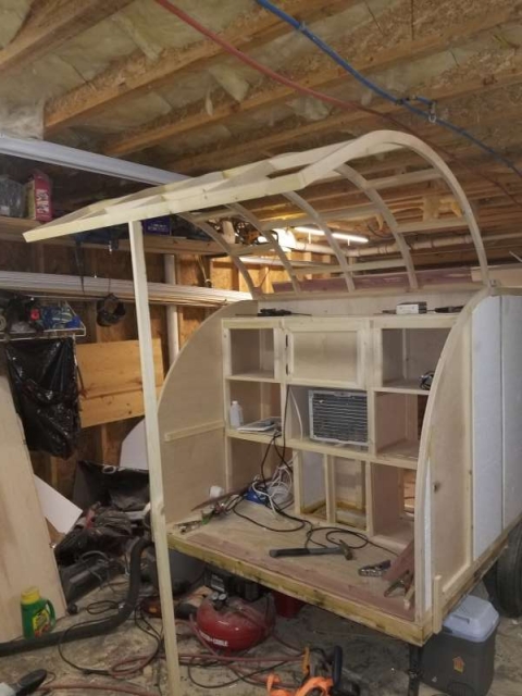

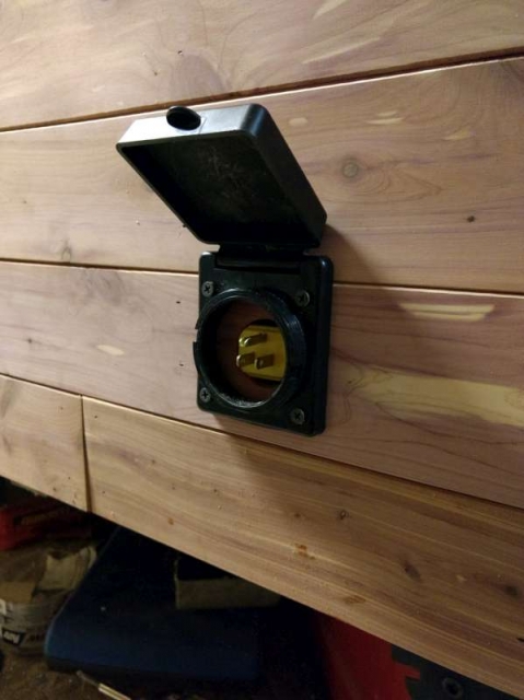

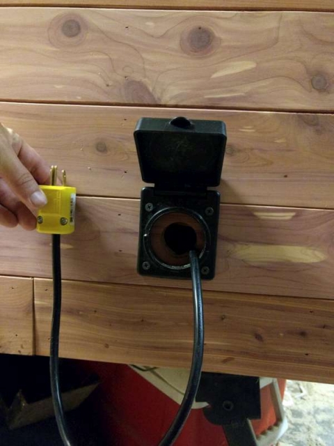

Postby Carl01234 » Tue Jul 10, 2018 6:56 am
July 09,2018

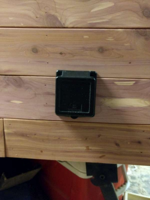

Waiting on the awning. Should be here today. Want to reinforce where it will mount, so im waiting to close up the roof. Added the a/c plug and used a retractactable cord.

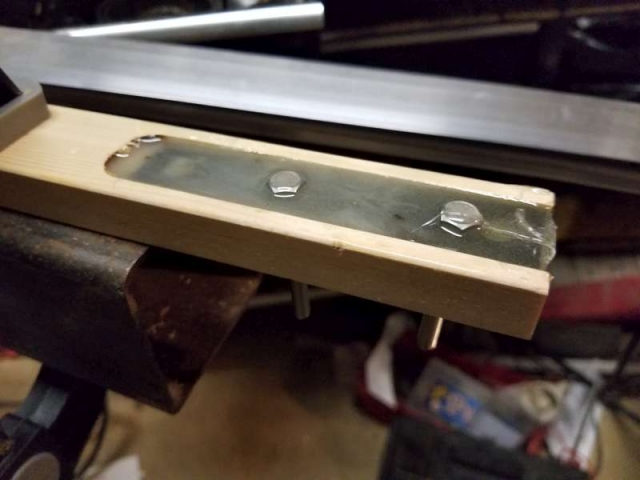

I embedded the bolts into the roof spars with epoxy. This should make a strong mounting point for the canopy.
