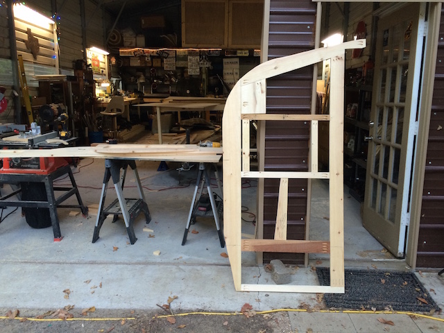

Today I only got the front half of the street side done. This side is taking longer because I am adding a window so all the skin comes off and I have to reframe it completely. I did get all the wood halfway cut and laid out for tomorrow for the back half so I should get it done tomorrow no problem.

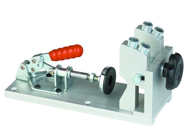

Those pocket screws are going to be way more strong! I got a Kreg setup as I started back and love it. That added window will be nice looking and allow more light in, more VIEW out! 8) Good Luck Coyote

I love these pocket holes except word to the wise, Home Depot post hole screws are horrible! They love to strip and they have a proprietary Phillips/mini square heard bit and the one they give you is too short so it gets stuck in the hole and won't go deep enough along with stripping! Horrible! I have to hand tighten each and every one. That's is alot of hand tightening!

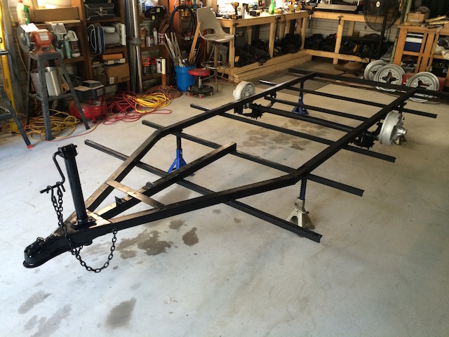

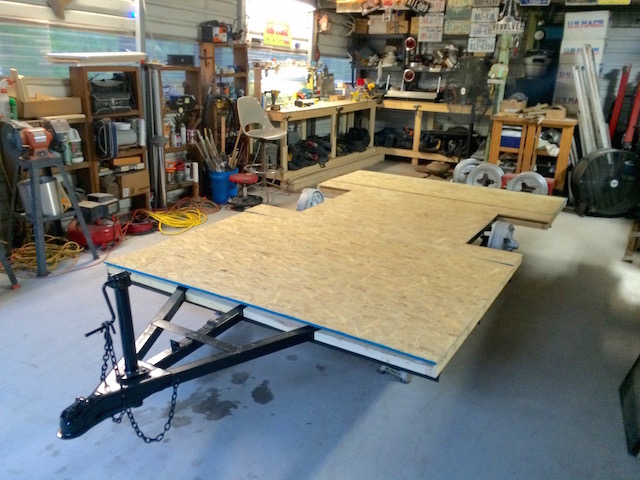

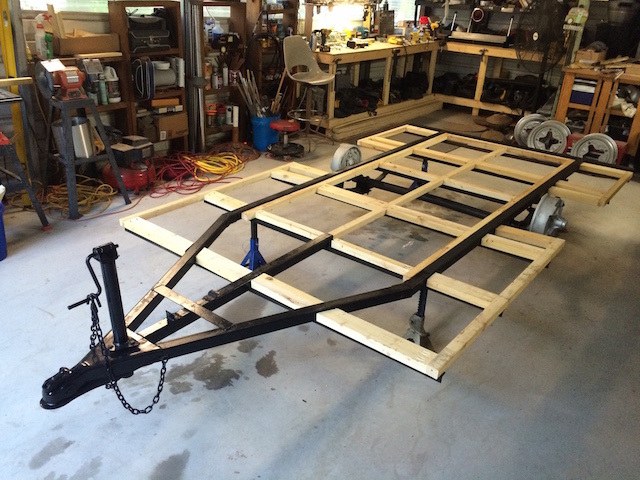

Postby 2bits » Thu Aug 02, 2018 8:56 pm
Made good progress today... sanded and painted the frame, then built the wood frame and the floor. Will get it all screwed down tomorrow then my already completed walls go up! It's only been two weeks to the day since I started! 8)

Postby KCStudly » Fri Aug 03, 2018 7:08 am
Chassis looks nice!
You gonna treat that wood with anything?
Re: Tiny Trailer Frame Up Rebuild - 1978 Play Mor
Postby 2bits » Fri Aug 03, 2018 7:40 am
Just undercoating, lasted the first 40 years

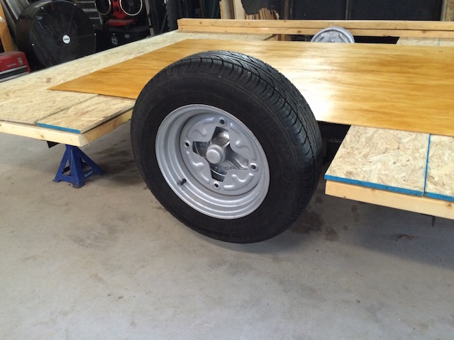

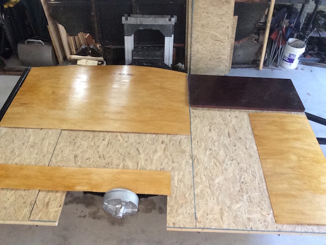

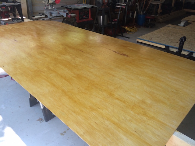

I took a day off today to let some minor cuts and bruises heal but I did get the tires put on the wheels and started thinking about sourcing the interior 1/8” plywood. I am only considering two options. I priced out the “correct” 1/8” birch at Plywood Co of Ft. Worth and as expected it was $25/ sheet. I found some 1/8 underlayment plywood at the big box and it looked great and super flexible and known for not having voids and has a similar hardwood face for $10/ sheet so I figured I would blow ten bucks and see how it shellaced since it was almost 1/3 the price of the Birch and not 2 hours away from me. Results were inconclusive since it was 90 degrees and I didn’t have any denatured alcohol around so the shellac dried super fast and got very blotchy in some places, this is also just one coat. An all around piss poor job haha but I expected as much with the temp and at least it gave me an idea of how it would look. At this point, it is certainly an option for me but I want to do a good shellac job before making a decision so I picked up some alcohol and will play with the other side tomorrow and see if I can get the grain to pop with a little more clarity. I have no expectation that it will match the thirty dollar Birch but at 1/3 the price I am willing if it still looks presentable.
I also cut up my test panel and laid it out to the floor plan to get the feel for it. Bed it upper L, Kitchen is lower L, Bath is upper R and the couch is lower R.

Postby Mr. Lahey » Sat Aug 04, 2018 8:35 am
I used the Chinese 3mm (1/8) birch under lay plywood from the orange box store in my build. It varies in species of birch used from batch to batch. Lucky for me I bought my full stock all at once. When I bought mine it was from a run of highly figured golden colored birch. The stuff stained and finished up just stunning. Awesome old school look to it.
When I went back for more the current run was just a white pale minimal grain pattern species. I see a lot of birch ply made from that type birch. Including the baltic stuff. Just not very interesting looking stuff. Nor does it stain and finish up to that cool vintage look. From what I see it looks like what you have in your pic's is from that plainer species of birch. It's still good, but not like the old school stuff.
So when you are at the box store keep looking at the birch pile. When the highly figured stuff is there grab a good sized stack and store it if you can. The have the same stuff in 7mm (1/4) too. Great for cabinet faces, shelves and so forth.

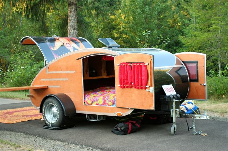

If you are the builder of the Luxury Tent just wanted to say it was your build that inspired me to switch from Kenskill style to a Cub. Love the look of the Cub.

Postby 2bits » Sat Aug 04, 2018 9:31 am
Mr. Lahey, thanks for the good info, they currently have a stack of about 25 sheets right now and I will need 12 for my interior so I will be "that guy" picking through them when I pick them up! They are on the top shelf too LOL...
And yessir, the LT was my creation, I am glad you remember it from the heyday of teardrop building and forum activity and that is cool that it actually influenced you! Mine is still gong strong in Washington state!
