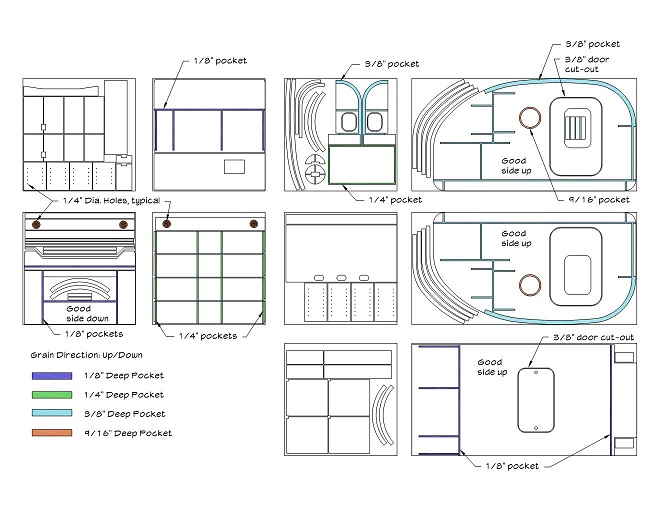

I've toyed around with this design enough!
Getting ready to release the CAD files to the CNC milling shop...
A lot more pieces/parts than I thought!

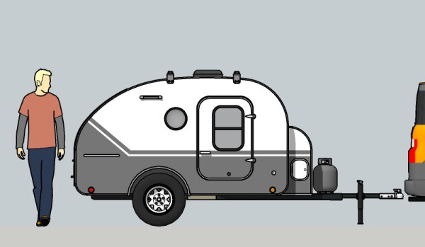

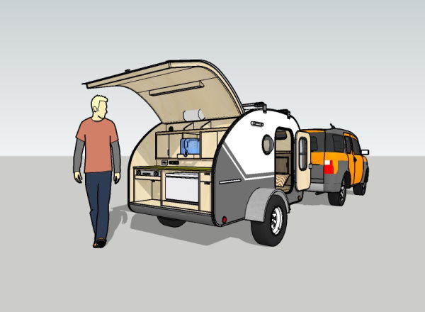

Postby eLink » Sun Nov 24, 2019 1:32 pm
This week I will be picking up my parts from the CNC shop! Can't wait to see how it turned out!
Meanwhile, I thought I would upload the latest design images.

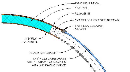

:o That's going to be a beautiful teardrop!
Just a word to the wise, other builders have found it difficult if not impossible to put a glass window into a curved surface. You may need to move it down to where the wall is flat or nearly so or use some form of plexiglass(?). But then, that may be what you have planned. (I haven't read your entire thread.) As a plus, plexiglass is shatterproof. :thumbsup:
Posts: 8865
Re: The Coddiwompler
Postby eLink » Tue Nov 26, 2019 1:28 am
Thanks Sharon!
I think I'm going to order a pre-cut and curved polycarbonate sheet from a plastics shop. It will be mounted with a Trim-Lok gasket.

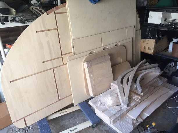

Postby eLink » Sun Jan 05, 2020 10:06 am
I finally picked up the plywood parts from the shop. Now it really begins!

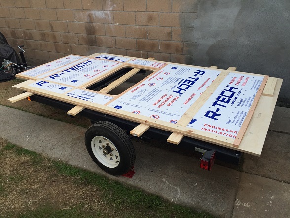

Postby eLink » Tue Jan 14, 2020 10:39 pm
Working on the underside of the 3/4 ply floor, here are the 1x sleepers and 3/4" insulation. Next comes a layer of 1/4" ply. It's already pretty heavy and I don't really need it, except to build up the floor height a bit. Coulda gotten away with a lighter sandwich floor, but I wasn't trusting my skills while designing it.
I'm guessing there will be a lot more hindsight to come as I build this thing. Oh well.
