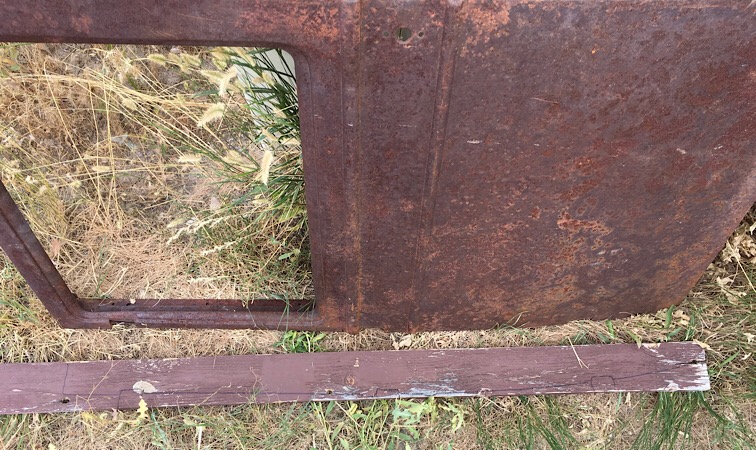

I need some advice here please. I want to use that HEAVY old car door and will of course have to rebuild the lock mechanism and replace all the missing wood. Installation will entail cutting the fiberglass topper and leaving a proper opening in the lower side wall on that side.
I’m thinking I should frame this door like a pre-hung house door. That is, build the frame for the door and install it, seals and all, maybe with a temporary threshold. That way, I will know exactly how big the openings in the upper and lower wall need to be. Make sense? Oh, the door, being a car door is curved on the outside. A 1x6 frame will readily accommodate that curve.
This pic shows the line of the outer door on a 1x4 which isn’t quite large enough. The hinges will need to be 3 different lengths too.

Postby Squigie » Fri Sep 27, 2019 9:13 am
My own preference would be to frame the door with steel and then trim with wood. If you're going heavy, you might as well make the whole assembly out of the same material.

Postby Pmullen503 » Fri Sep 27, 2019 9:57 am
Does that door have a functioning window? I get why you would want to use an old car door, especially if it had a working window. I would suggest putting the door on the back and making the box the same height as your door. Then the curve of the door won't matter as much. You'd have kind of a Dutch door with the topper glass and the car door.
Unless you really want to do the work to blend the box and the topper to fit the door on the side.

Postby NevadaBlue » Fri Sep 27, 2019 10:48 am
The door is just the frame and skin, no window. My plan is to install a crank out awning type window in it. I do want it on the side, since I am planning a sheltered galley in the back. I’m digesting 59,362,994 photos I have saved off the site to get the best ideas and tips included in that galley. :shock:

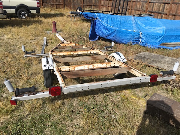

Postby NevadaBlue » Mon Sep 30, 2019 5:16 pm
My Dilly is naked! :shock:
I decided I had to do something today, so I stripped off the old plywood floor from the trailer and all the huge eye bolts that tied down the sailboat. Next will be the cross arms that supported the pontoons.

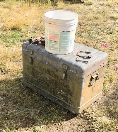

And, this will be the tongue box. It is a surplus aluminum box that originally held lighting for an army tent.
I hope to start cleaning and painting the trailer frame soon.
The trailer has a VERY long tongue (which also allows tilting) that will have to be shortened. I haven’t yet decided on how long to make the tongue. The overall trailer box itself will be 6’x8’.
