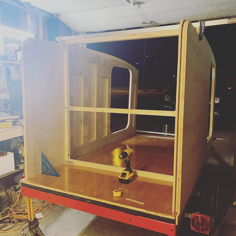

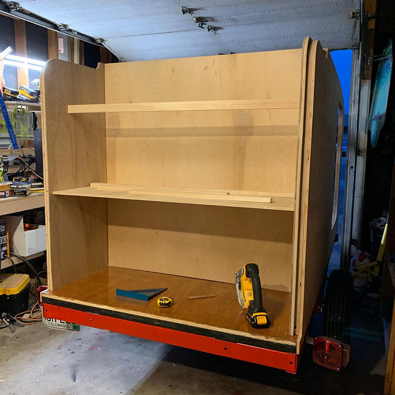

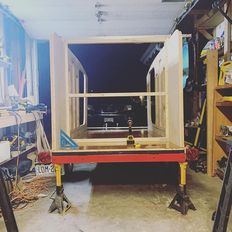

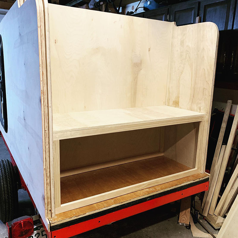

Postby joshwhite » Thu Dec 12, 2019 3:18 pm
More framing...

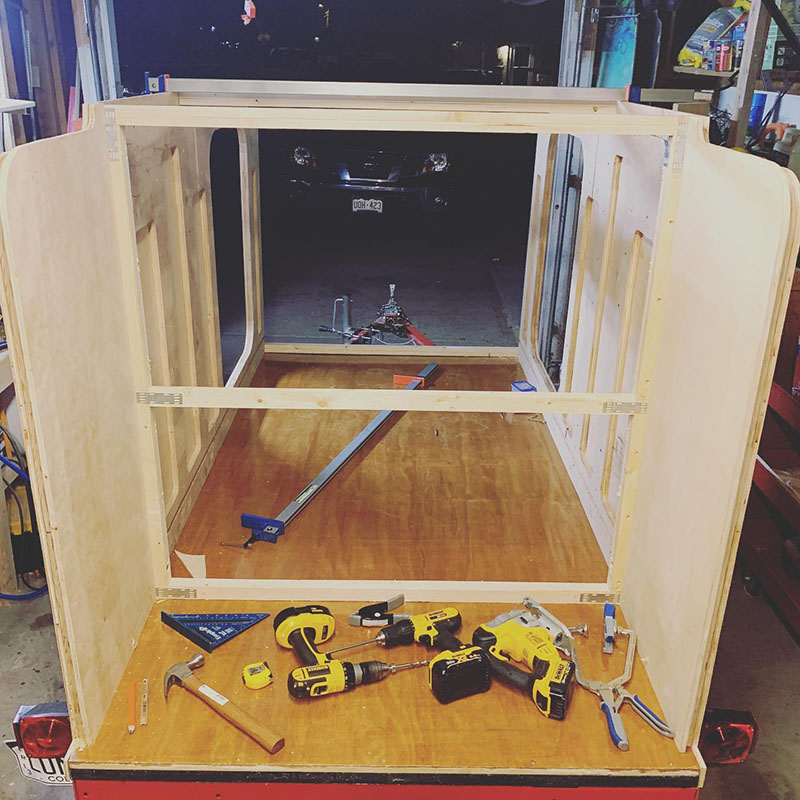

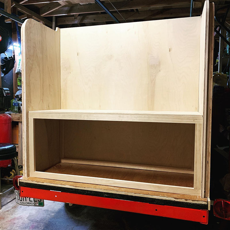

Re: My Harbour Freight Build in a Small One Car Garage
Postby joshwhite » Thu Dec 12, 2019 3:19 pm
More framing and press fit bulkhead galley wall...

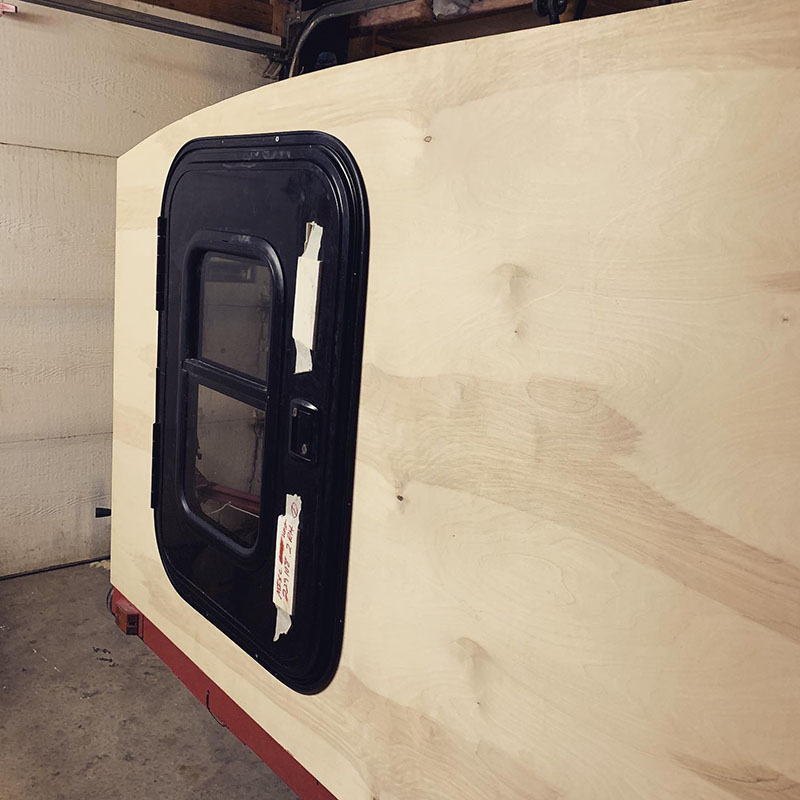

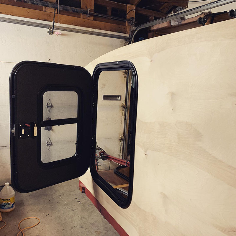

Postby joshwhite » Thu Dec 12, 2019 3:20 pm
Just testing that my doors fit...

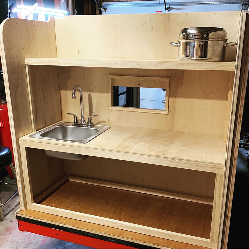

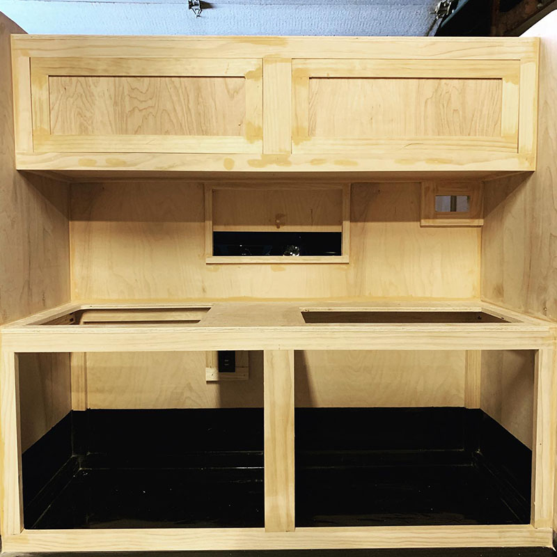

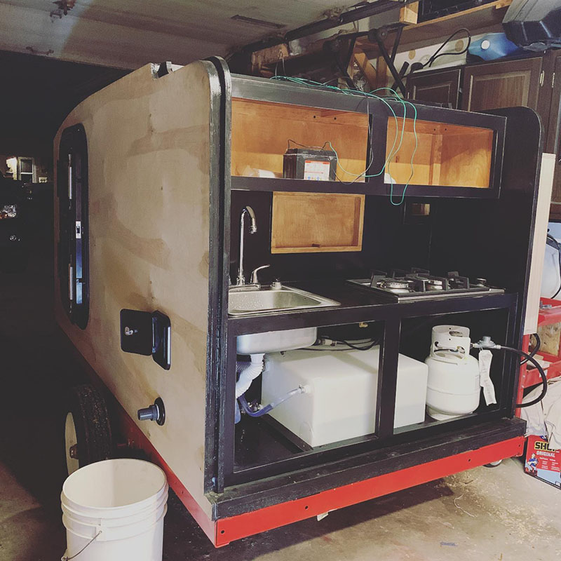

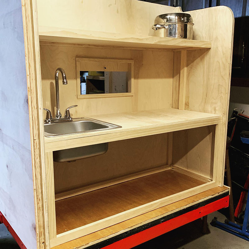

Postby joshwhite » Thu Dec 12, 2019 3:22 pm
Building the galley counter that will house the sink and propane burner...

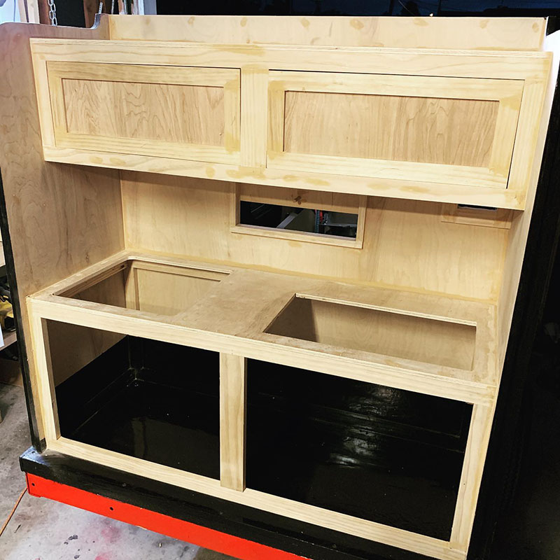

Postby joshwhite » Thu Dec 12, 2019 3:23 pm
Starting to build the upper cabinet for storage...
Also decided to create a pass thru area with this slide up window.

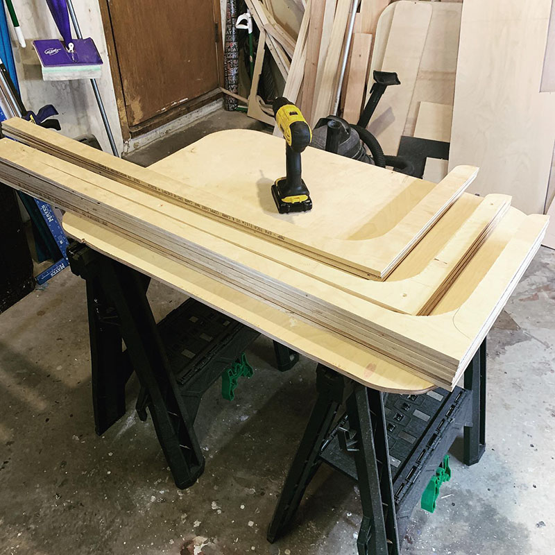

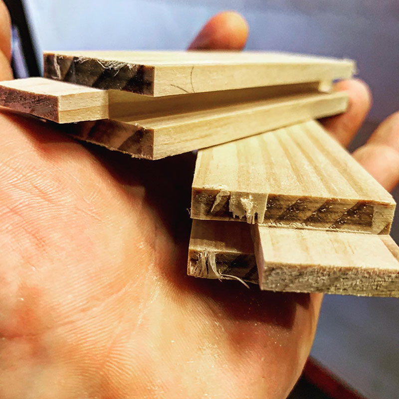

Postby joshwhite » Thu Dec 12, 2019 3:25 pm
Playing around with a router... I had no previous router experience.

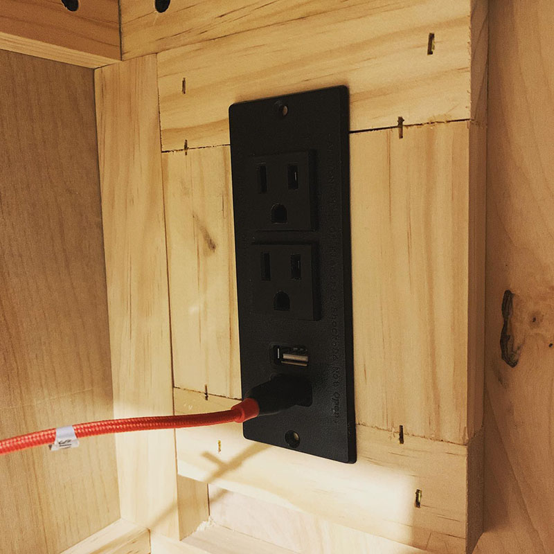

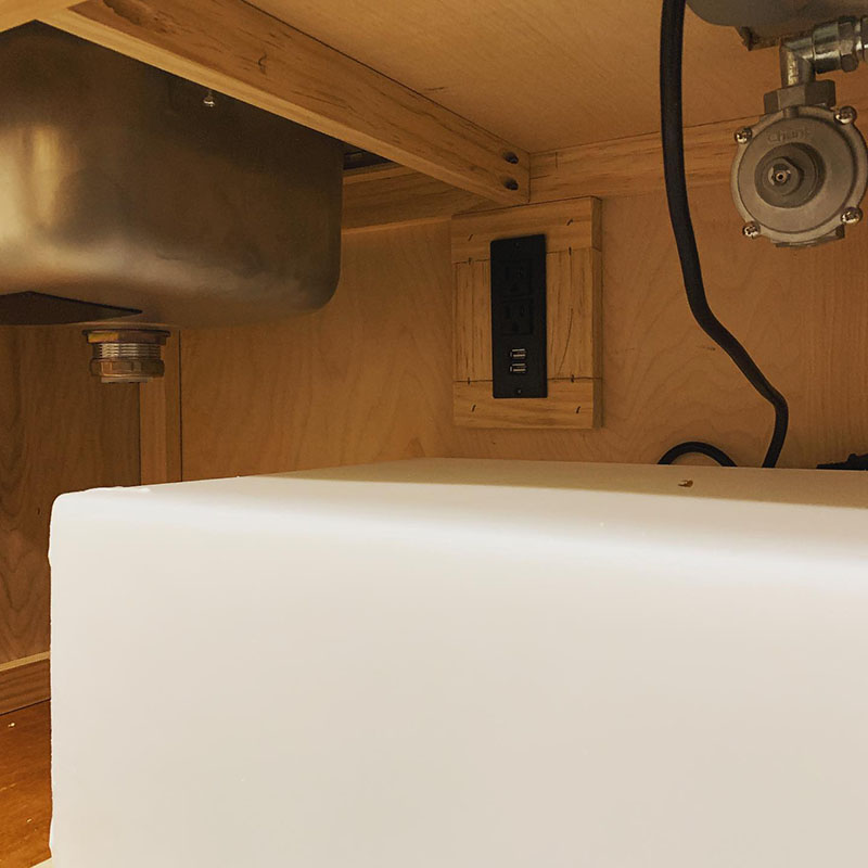

Postby joshwhite » Thu Dec 12, 2019 3:29 pm
Picked up these combo plugs to install. One is inside the upper cabinet in the galley, one under the counter for the propane burner ignitor, another is easily accessible from the galley area itself and two of them are in the sleep quarters... I think I overdid it on these but they're nice none-the-less.

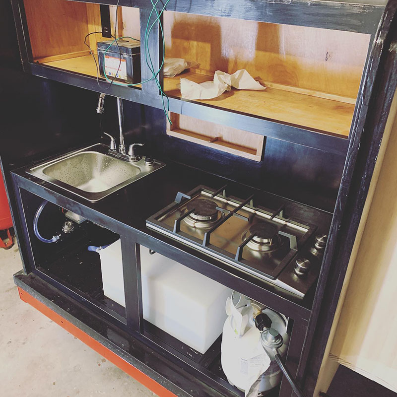

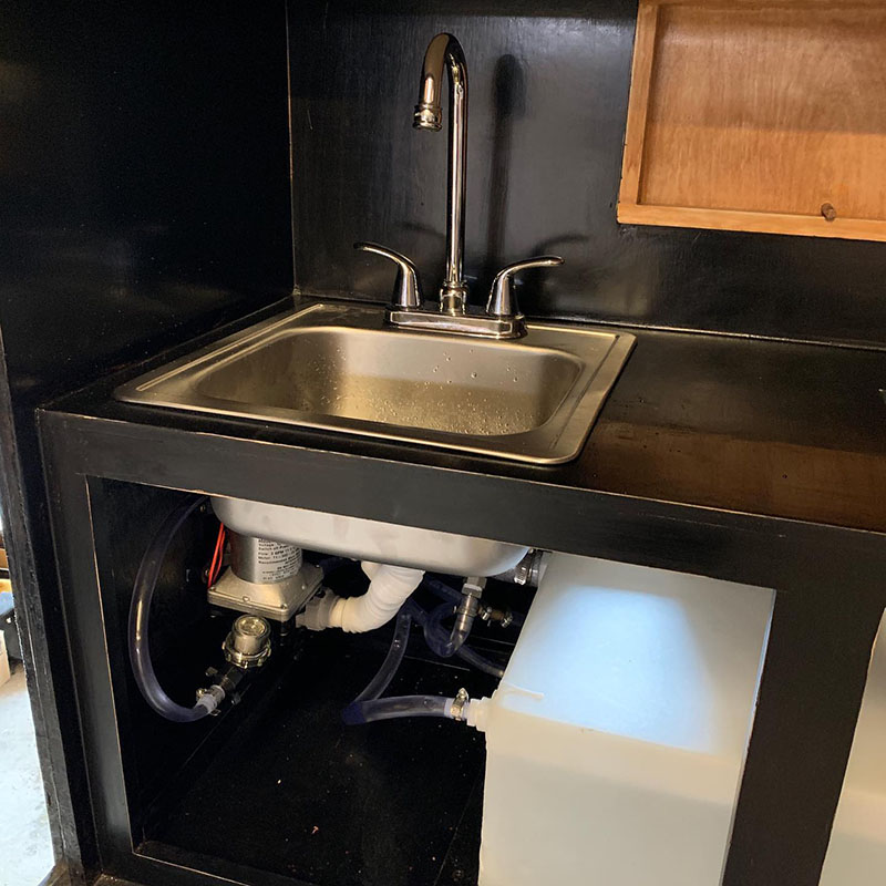

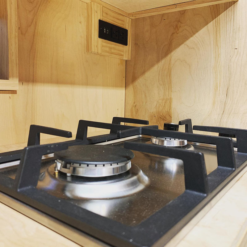

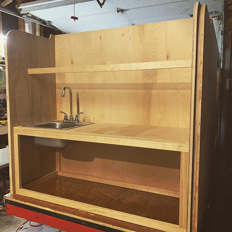

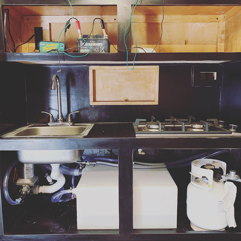

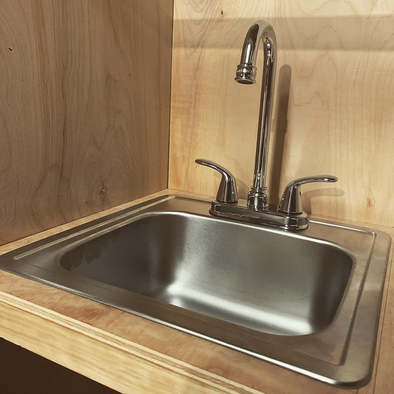

Postby joshwhite » Thu Dec 12, 2019 3:31 pm
Burner with easily accessible plug.
Plug under the counter.
10 gallon fresh water source, sink and burner test fitted.

Postby joshwhite » Thu Dec 12, 2019 3:33 pm
Upper cabinet doors...

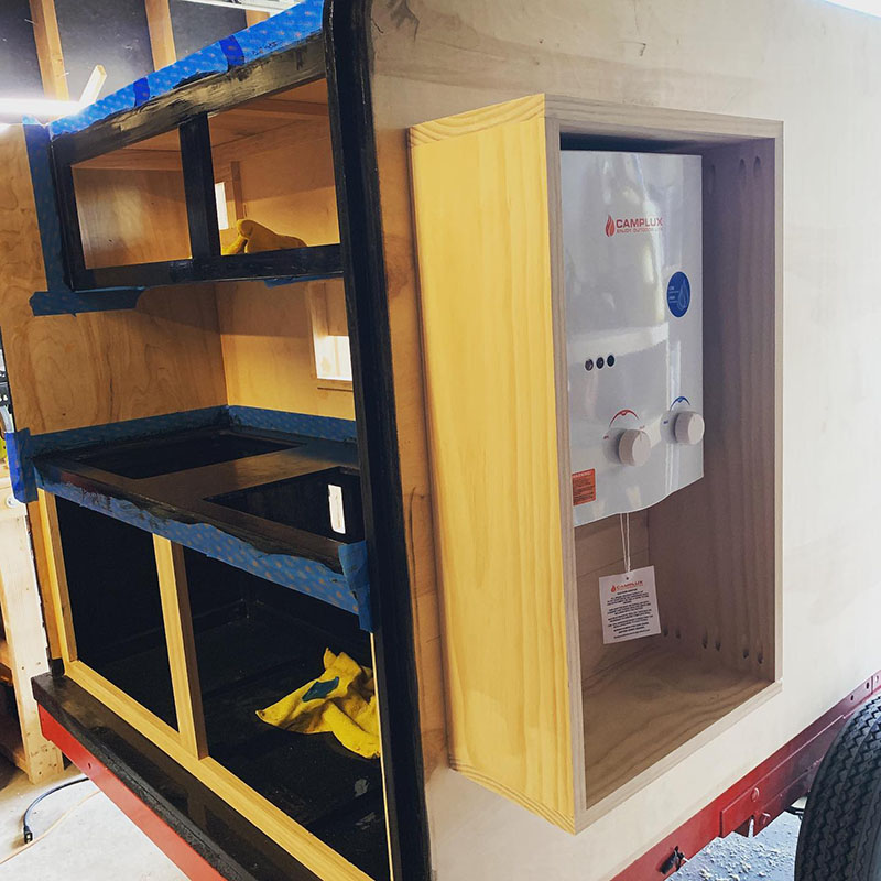

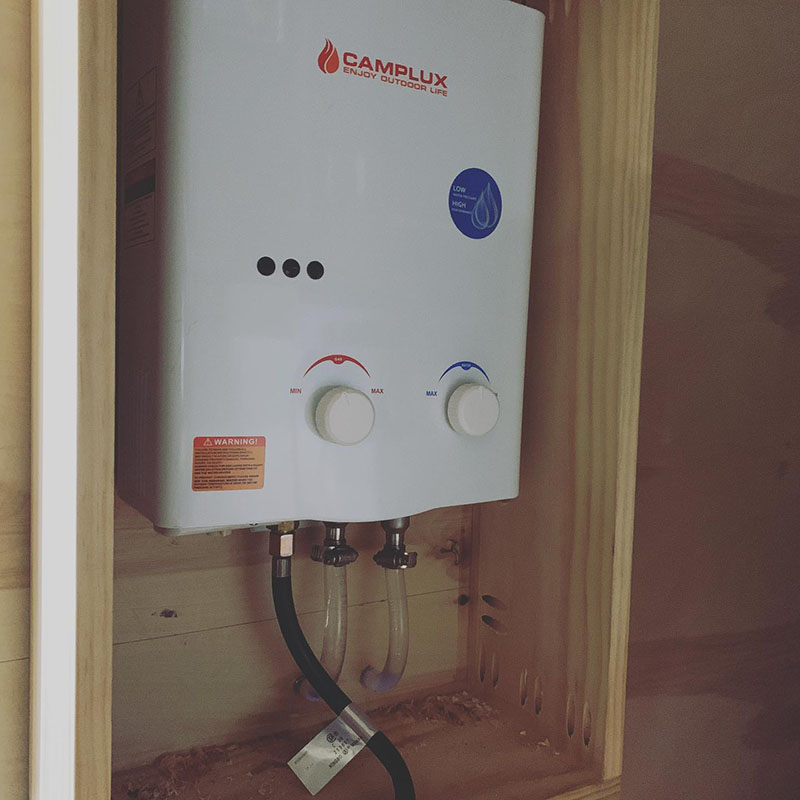

Postby joshwhite » Thu Dec 12, 2019 3:35 pm
On demand hot water tank box. I need to rethink some of this. I think I might create a door that includes the top part of the box along with it. That way when I remove the door, the box top will disappear allowing all the heat to escape and not cause any problems. Obviously the heater is way too close to the box top in this photo.
Also started to stain the galley black. Ended up staining everything in the galley black. I regret this decision and will eventually strip it and do something different.

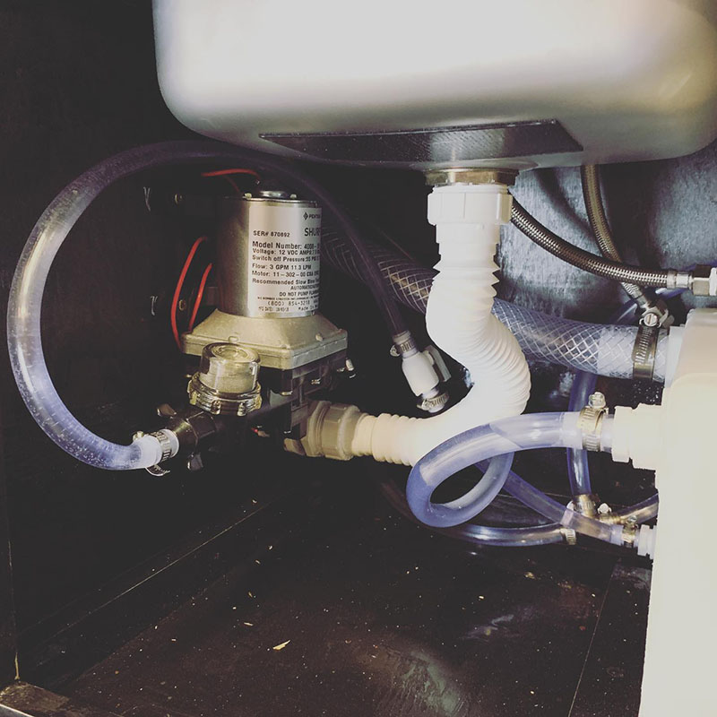

Postby joshwhite » Thu Dec 12, 2019 3:39 pm
All of my sourced plumbing parts started to arrive, so I started putting that together. I have some questions about this I'll be asking about later on.

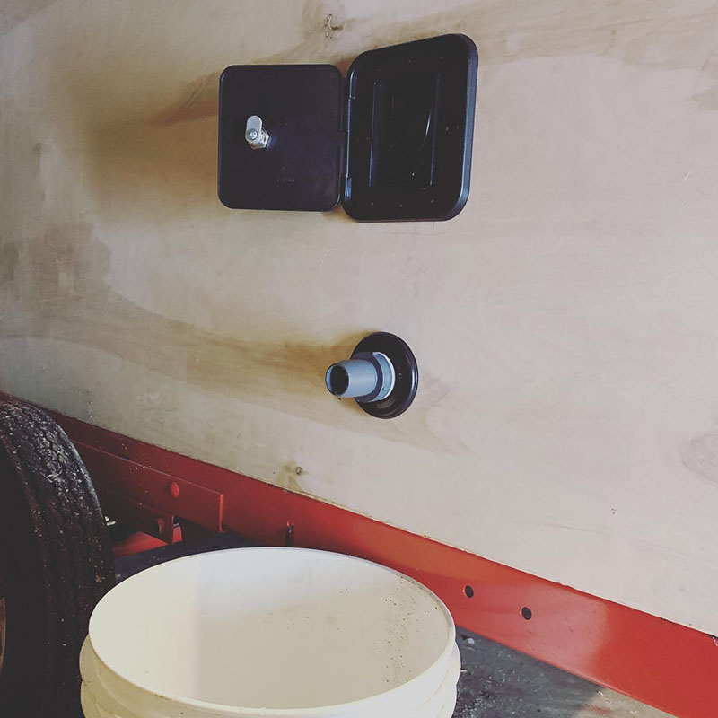

Postby joshwhite » Thu Dec 12, 2019 3:45 pm
Here I have my water fill up and my sink drain.
I can drain sink water into a bucket and dispose of properly and keep the ground area from getting too wet.
