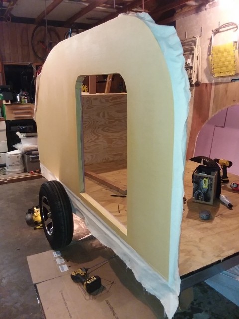

Those were the wall insides? Covering one side can make the wall warp if it sits around too long.

Pmullen503 wrote:Those were the wall insides? Covering one side can make the wall warp if it sits around too long.
The previous pics were the exterior PMF on the walls. But, good to know. We were going to wait to PMF the interiors as we have to run a few wires inside and some anchor points for a headboard shelf first. I think we'll have to address that sooner than expected.

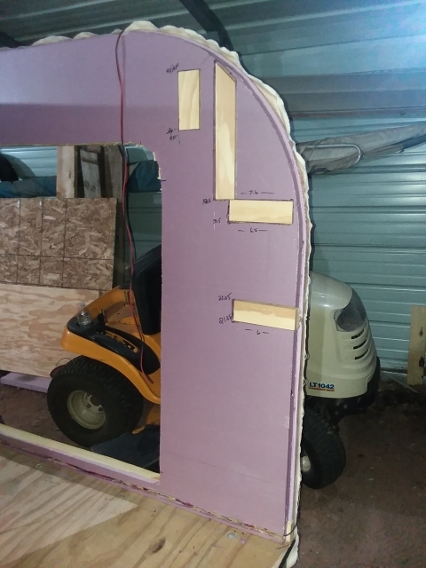

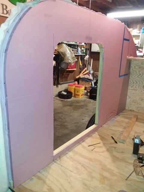

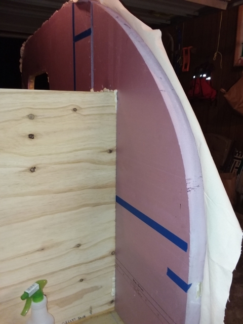

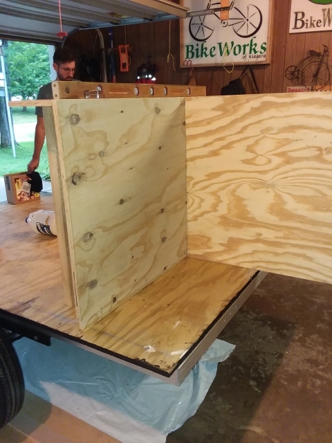

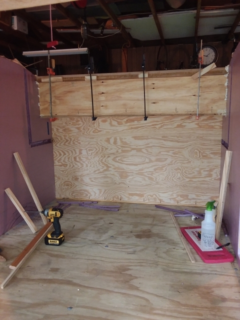

Installed the walls and lower 2/3 of the bulkhead. Will finish building the upper bulkhead tomorrow so we can add the ceiling panel and possibly start the roof. We'll regroup and discuss getting all the interior wall work done so we can PMF the interior soon.
Bulkhead installed.
Temprary brace to square it up.
One sidewall installed.
Fastening second wall.

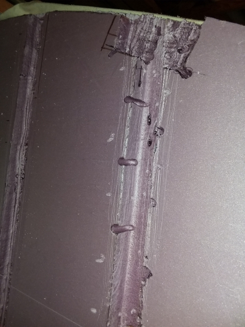

We had some trouble yesterday with Great Stuff pushing buried cleats of wood proud of the surface of the foam instead of staying flush with the surface. I've read some posts that have warned about this so we wired the cleats into and through the foam to hold them in place. That didn't work and we ended up routing the protruding wood faces flush with the foam.

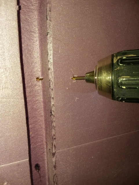

Andy came up with an idea to provide "relief valves" along the dados to allow the foam a place to escape from the back of the dado. He thought that we could drill weep holes at an angle along the dado for the foam to come through.
As you can see in the following photo none of the foam exited the weep holes. It may be because we were very conservative with the foam application and maybe there wasn't enough excess to push through. Or the idea may not work. It's worth doing some experimenting in the future to see if this will relieve some of the expanding pressure.

Andy headed back to Milwuakee after a marathon work weekend. We managed to almost get everything done that we hoped. Bulkhead is mostly installed with a little clean up to finish up. I'll be on my own with remote directions for at least the next two weeks so things will move along slowly.
I'll focus on the pmullen warning of warpage if the interior walls are not PMFd. I'll spend the next couple days organizing the wiring and plywood cleats to be installed then will PMF the interior.

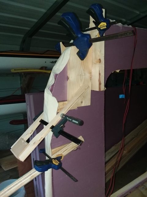

Top section of the bulkhead work.
And we tried an experiment with pressure relief holes around the bulkhead dados. Andy tried bigger holes with the hot wire gun. The jury is still out on this method. of course the bulkhead had little chance of being pushed out of place since it was anchored to the floor prior to glueing the last section. I'll try to document the process better when I anchor some ply cleats into foam over the next couple weeks.

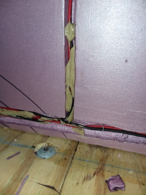

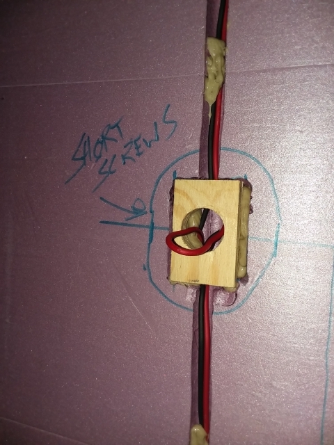

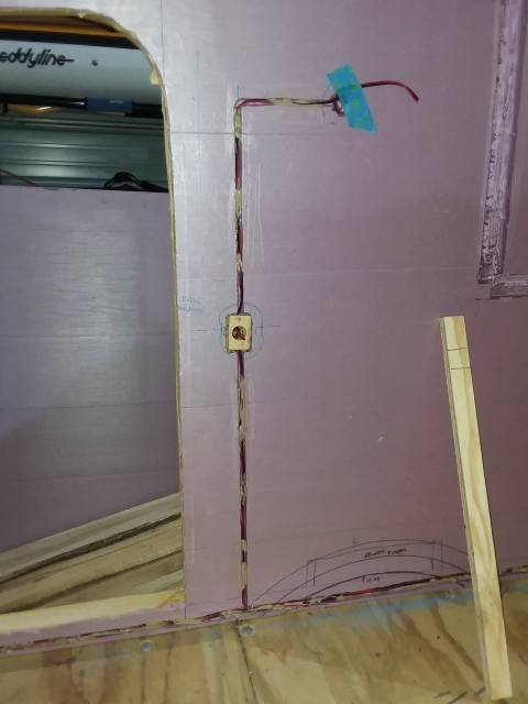

Burying wires for headboard USBs and porch light and its switch. I tried hot glue to "tack" the wires in the channels, but, all that did was melt the foam and make a big mess. I ended up using homemeade 18g wire staples to keep them in the groove and then used PLP to lock them into place. Any suggestions of what to use to fill the void without making too much work. I have GS original, GS window and door. I'm thinking spackle and drywall mud would eventually just shake loose. The channels will be covered with PMF, so...
Porch light switch location

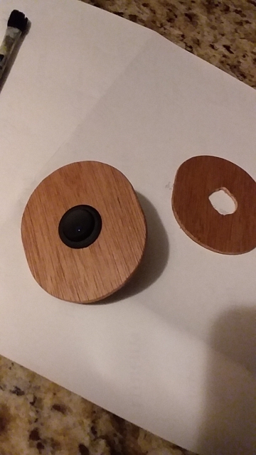

This homemade switch cover will mount on the above block.
