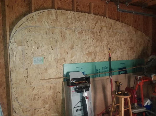

Some update info on the build. Still making some progress on the planning and acquisition side of this camper. While the build is sidelined, I'm still making some changes when time allows. First up is while doing other work of been looking at the profile board on the wall. I decided to rework the front wall to reduce the long flat spot in the original version. I pulled the front bottom corner in 7" and formed a curve. Then I eased the radius at the top a couple inches too. Now there is only about 14" of flat to the wall. Just what I need to install the front window in.

Modified front wall profile
