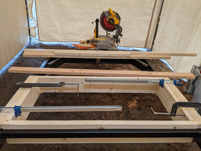

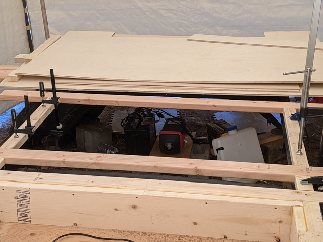

It's been a few weeks since I posted. We've had a few more snow and ice storms here in MD that have slowed my progress. But the past week was in the 60's and 70's and I was able to get the frame painted and glue up some flooring. At the time of my build, a 2x4 at lowes is $7!!! I ended up using 1/2 birch for my flooring panels because it was cheaper the anything pine!

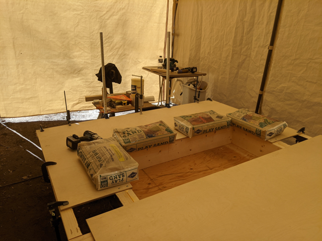

two of the three floor panels complete
My "helper"
step down area
crxtech

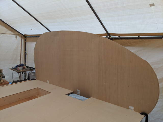

Postby crxtech » Tue Mar 30, 2021 8:10 pm

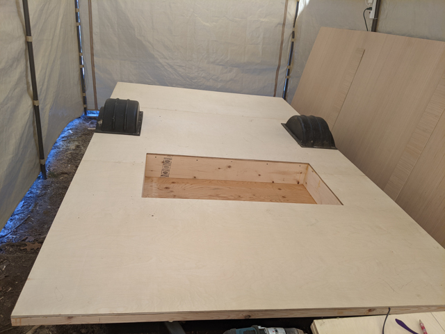

Finally finished the floor!

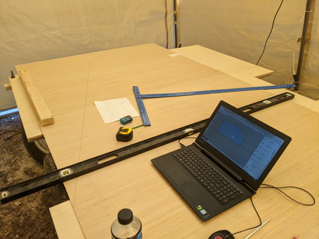

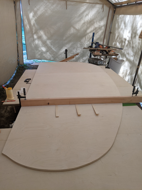

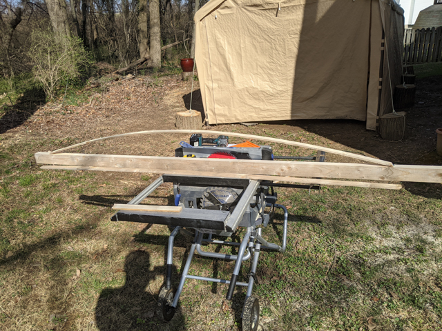

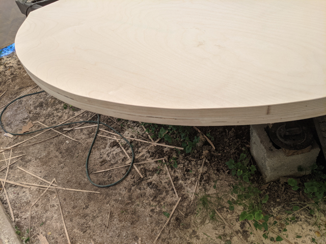

I'm making a template to trace for the walls out of 3 sheets of revolution ply glued up. It's 5'x12'. Ignore that straight line, its temporary.
Front Curve:

Postby crxtech » Thu Apr 01, 2021 6:59 am

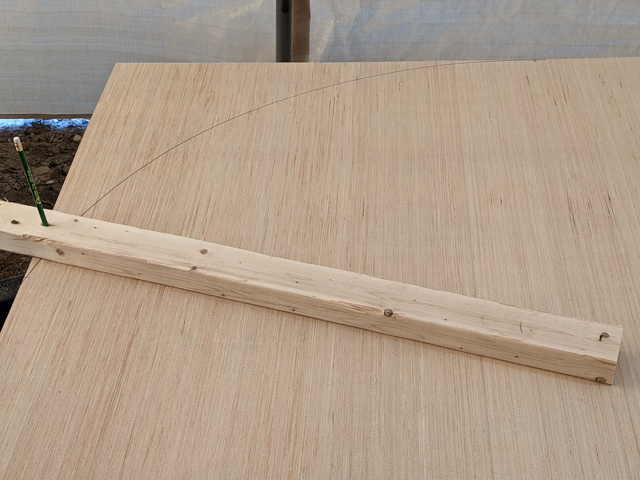

I did the big curve this way, because the radius was 10' 7", and I don't have that kind of room in the tent.
Here is the template clamped to the trailer to see how it looks. What do you think of the shape? I left an inch on the rear curve to rave room to modify it if needed. It's size is starting to show. She is big.

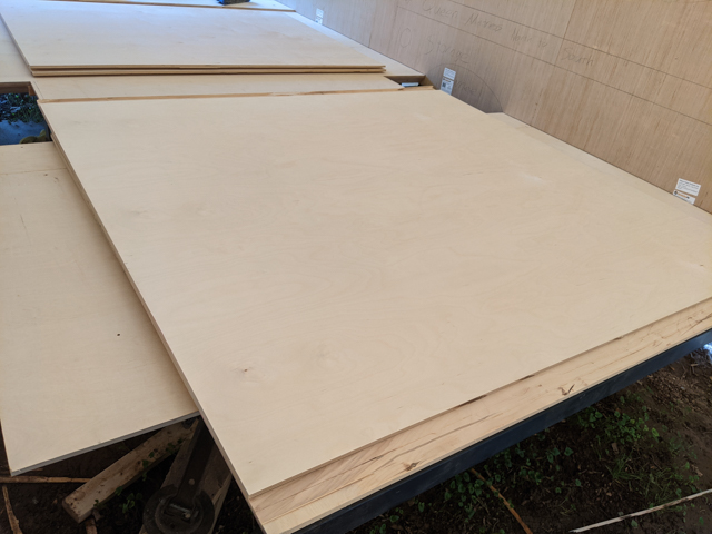

Postby crxtech » Fri Apr 16, 2021 6:09 am

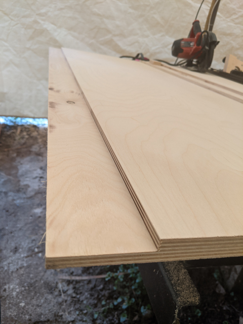

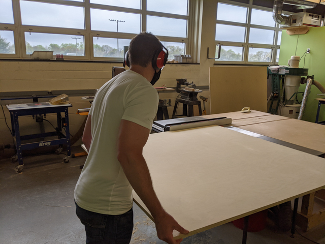

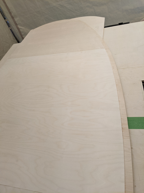

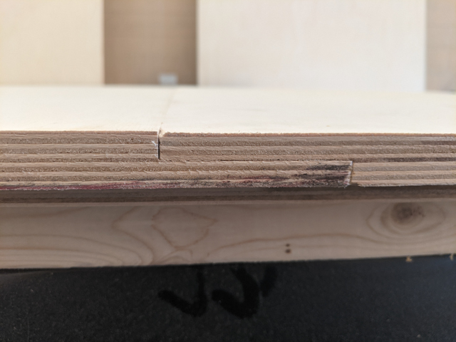

Doing lap joins on 5x5 sheets of 3/4 birch was much harder then I expected. I used a 3/4 dado on the table saw and did 3 passes per edge.

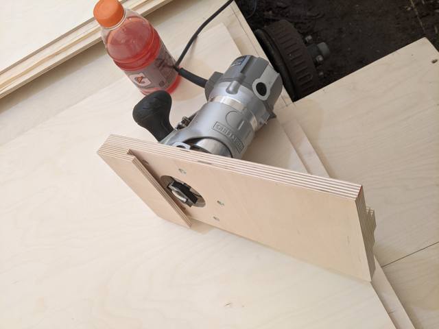

Postby crxtech » Fri Apr 16, 2021 6:12 am
I made this router jig to clean up the lap joints and make them a full 2.5" wide. It was very loud and messy, but it turned out great.

Postby bartek » Tue Apr 20, 2021 2:36 pm
Your router jig looks better/cleaner than most of my cabinets :) Nicely done

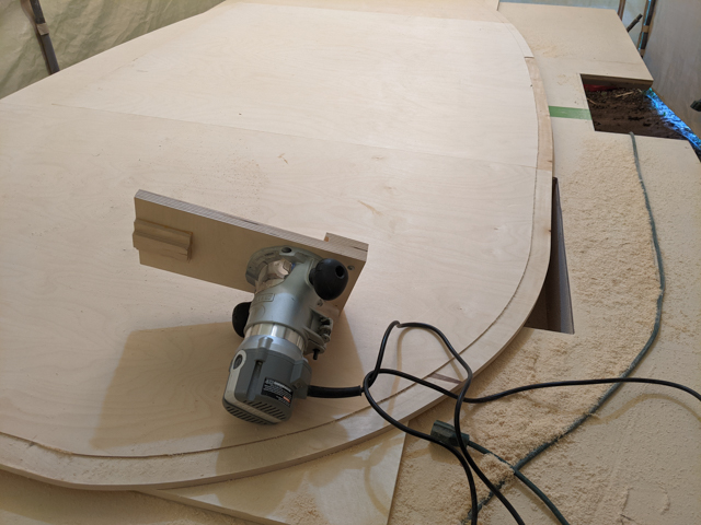

Postby crxtech » Wed Apr 28, 2021 5:35 am
I've made a good bit of progress the past week. Both wall panels are glued together and cut to shape. The lap joint were much more work then I thought they would be, but they seem to be very strong and lined up nicely. I purposely cut one wall panel 1/8" over size, then flush cut it on top of the other wall, so they are exactly the same.

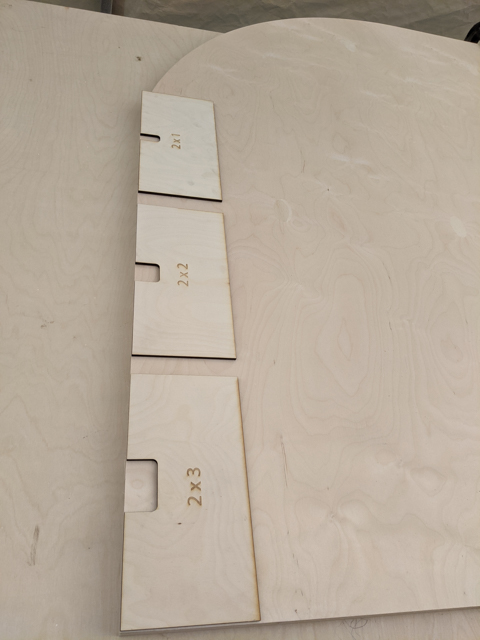

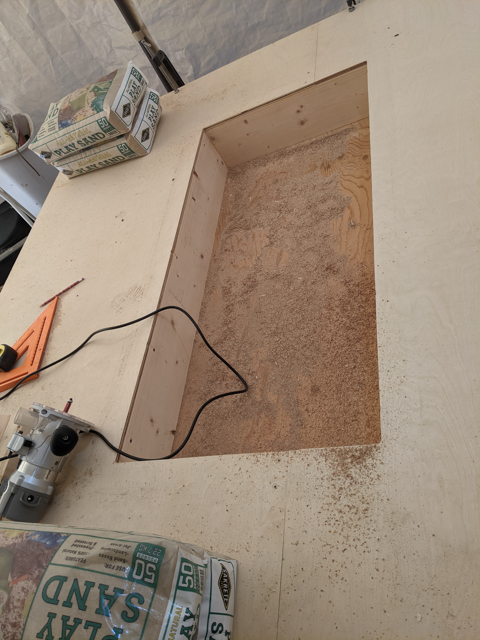

I really liked how @bartek(I don't know how to tag someone?) did his spares, but I don't have access to a CNC, but I do have access to a laser cutter, so I made these router templates to cut the slots for my spares. I still need to make the router jig for the actual spares.
Routing out the groove for the inner roof panel was soooo messy, but one panel is done.
