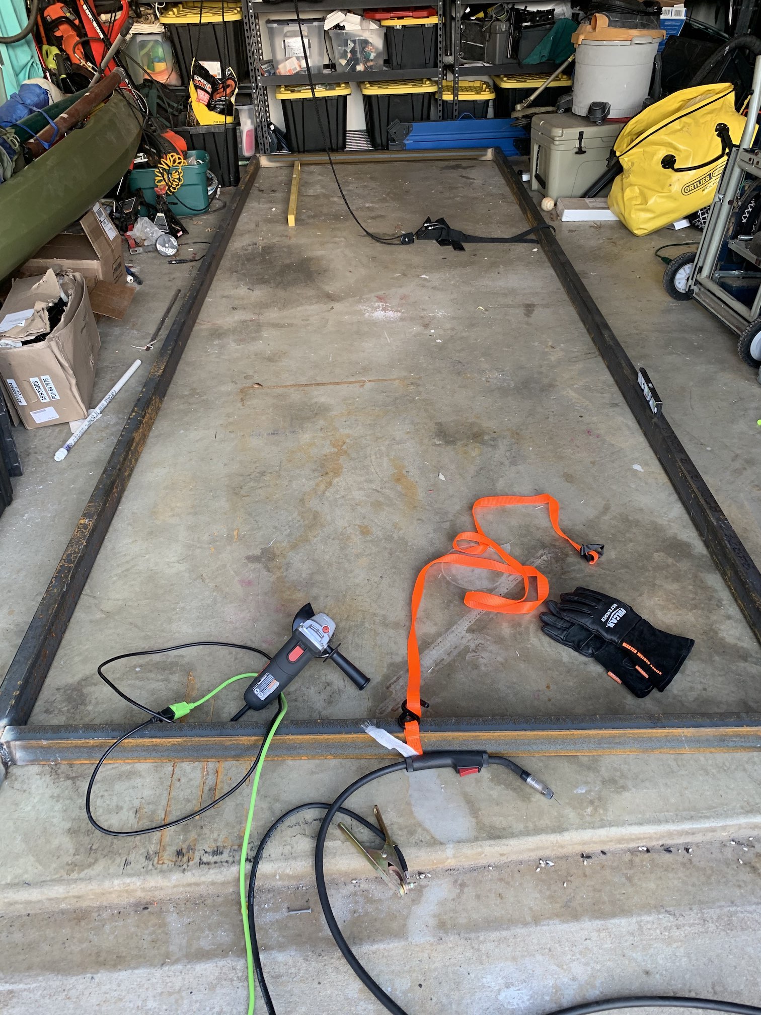

Started the welding!
Right now I just welded the box section of the frame together. The little bit that sticks out on the end is to add a bumper to make attaching lights easier.

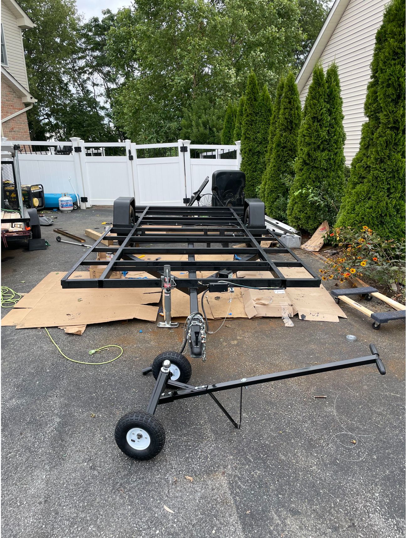

The frame is almost done. Just have some cross members to add to make it stronger and I need to finish an under the floor water tank storage box then paint it.

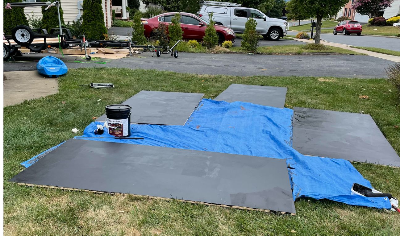

I've been spending today painting the trailer with rustoleum rust remover:
And then I've been painting black beauty onto one side of the 3/4" subfloor:
