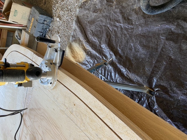

western traveler wrote:I have arrived at the worrisome place of cutting two $90 3/4” CDX sheets at one time. Yep, not a typo.
Ouch... I'm building a roof right now to protect our teardrop, so I'm bleeding too...
Are you going to cut it a bit proud and then use a trim bit?
Re: Serenity (Now) Tear Drop Build
Postby western traveler » Thu May 13, 2021 1:21 pm

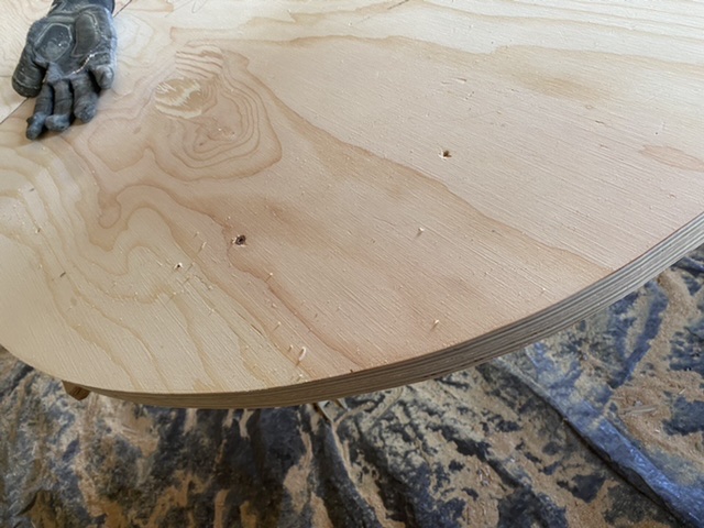

All and all it went well. I used three passes with the router. The last two without the pattern. I don’t know what happened but I had one small whoop-de-do on a curve. Operator error I guess. It will be an easy fix with some Phenolic Micro-balloons and epoxy and a bit of touch up with a sanding block...

It Tony does it that way I am likely to follow. Not trying to reinvent the wheel here. Thanks for the tip to level out the jigsaw with a piece of scrap as well... :thumbsup:

If you are referring to the ply in the router photo, I think that is Douglas Fir veneer. The lumber yard I use pretty much only deals in grade one lumber but I don’t know how that applies to plywood. I do know I passed on the 3/4” ACX that was at Home Depot even though it was less expensive. I didn’t like the looks of it.

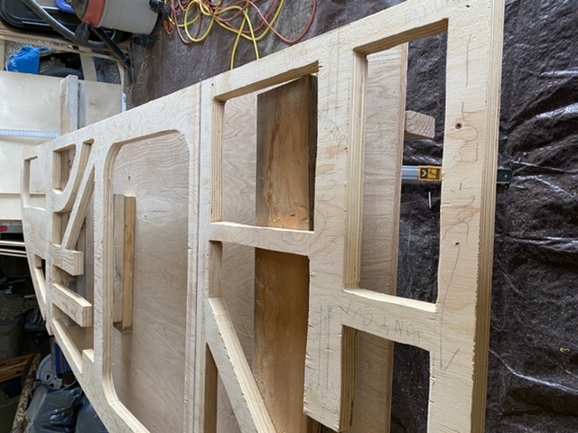

I spent yesterday transferring the layout from the template to the skeleton panels and measuring and checking the book and measuring and measuring again.
I also filled the woop de do’s with resin and micro balloons. I sanded that out first thing this morning and was pretty pleased with the finish. I wanted to hold off till fresh today to start cutting.
I set up my router and With a 1/4” up-cut spiral bit went slower than I probably needed (but it is a long way to the city and another one if I broke it). Probably 7-8 passes later the upper radius was done. I then made all the rest of the cuts needed except the dado’s.
I have a bit more trimming on the door cutouts but they are very close. I just couldn’t help myself from cutting most of the voids proud. I am mentally struggling with the concept though I get it. Just too many years spent out on the ocean in wooden boats and pounding seas.
I welcome any feedback regarding the negatives of leaving more meat. The biggest concern for me is condensation building up.
Also I think I should have screwed the sheets face to face rather than C to C. A bit of prep should take care of it.

Skeleton is close...
