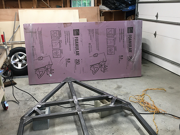

Postby Capebuild » Fri Jun 04, 2021 3:38 am

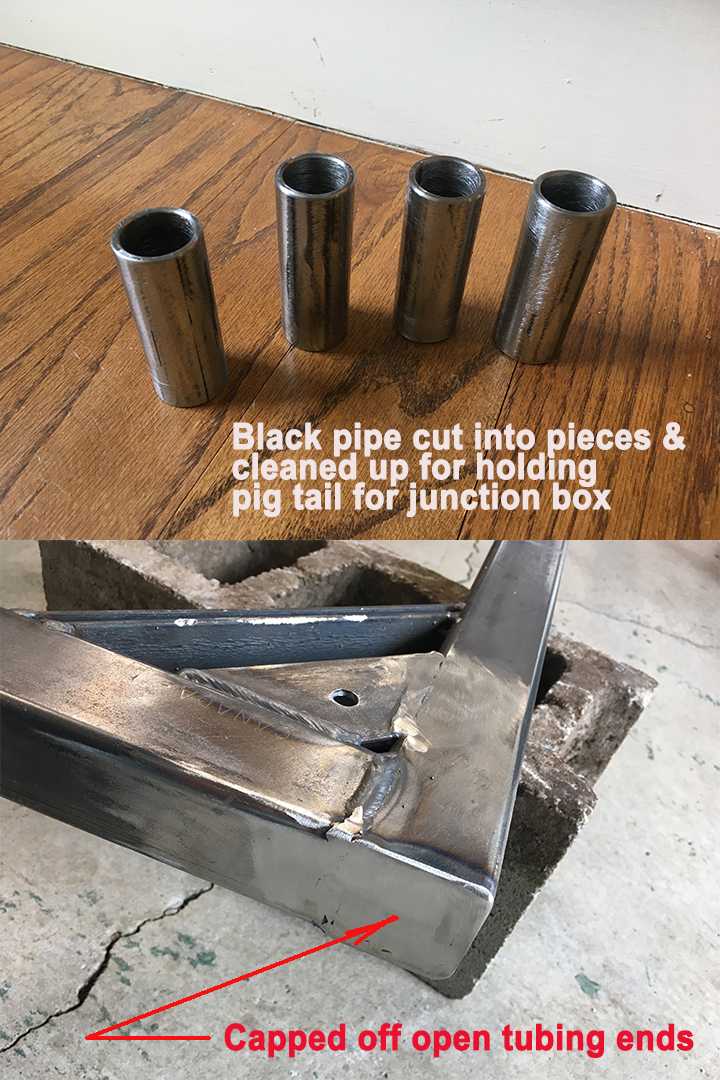

After being away for a week in California I got back to work on my trailer. Sharing some photos here.
After much searching I found a supplier for 3/4 inch rigid insulation board. That was delivered yesterday along with some 2 inch.
For the most part finished welding up the chassis frame. As noted in a previous post, frame weight came in at 170 LBS. If I had to do it again I would have mitered the corners. But closed off the open tube ends with welded on caps
rather than using inserted plastic caps. Used 3 inch long sections of welded on black pipe tubing to carry the pig tail from the 7 pin connector. Will screw on other fixtures to hold the various
wires soon as I determine where those wires will be located. Just waiting now for the Dexter axle. Will install that, paint the frame with cold zinc undercoat, and either silver or black
finish coat paint (leaning toward black).
Will start on the floor assembly next, now that I have the rigid insulation board. Also need to add 12 inches to 2 of the MDO board panels to make them 5 feet in height ( (what will be the middle board of the side panel assembly. The two outer 1/4 inch panels are already 5 feet in width). Bought a 1/4 inch rabbet bit to cut a recess for a spline to join the MDO panels. I'm having the side panels CNC'd.
That's it for now. Moving forward. Thanks for looking.

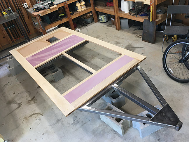

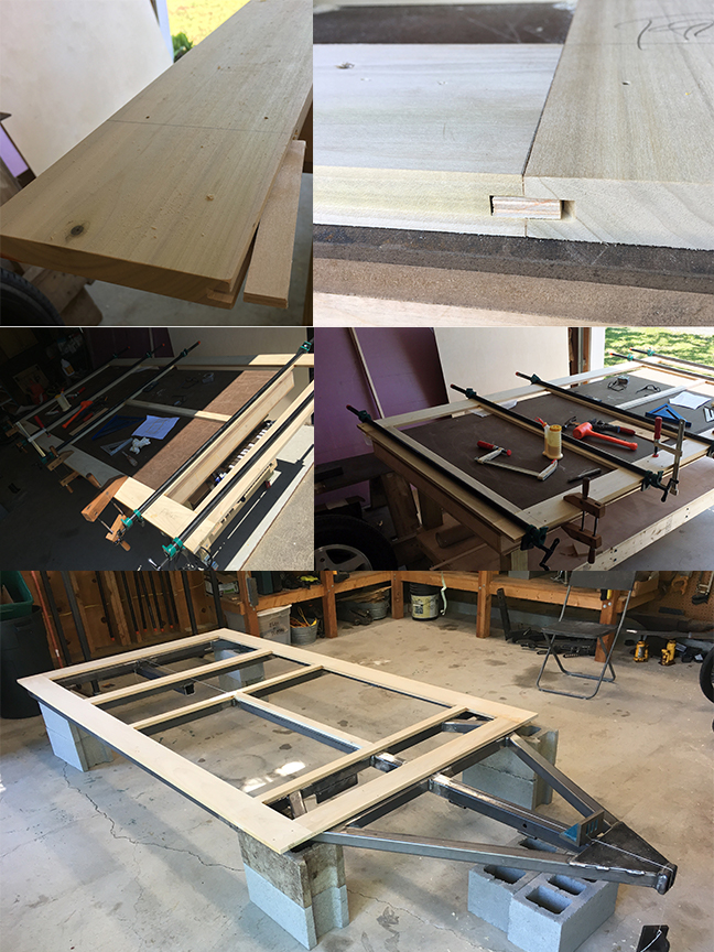

Postby Capebuild » Sun Jun 06, 2021 3:15 pm
June 6, 2021
Finished constructing the floor inner framework.
I'm finding, if I had to build it again, I'd make my construction table top a little over 5 feet wide.... instead of it's current 4 feet wide.
Used spline & rabbeted joint and TiteBondI ii to join and glued up members.
Will install and glue up bottom 1/4" okoume closure panel tomorrow and then look to seal all with something....
prior to adding insulation and MDO ply panel for where galley will go.

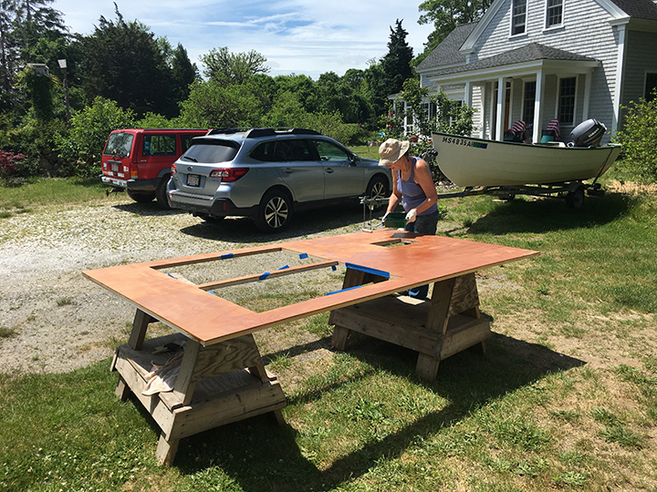

Postby Capebuild » Thu Jun 10, 2021 4:23 am
June 10, 2021
*Floor framing almost completed, minus battery box, 2 foot wells and other side of ply.....
*Shown being coated with 25% / 75% Helmsman Spar satin Urethane and then a coat of 100% urethane.
*A day off today but next will add 3/4 " rigid insulation panels and add 1/4" okoume ply panel to other side of floor framing.
*Being told my Dexter axle should be arriving next week (well, arriving at the place I ordered it from in New Hampshire. I have to go and pick it up)
2 Questions:
1) I'm trying to figure what undercoating to apply to the underside of the frame once floor assembly is installed. Any suggestions would be welcome. Thanks!
2) Should a 2nd coat of 100% urethane be applied to floor framing? (right now it has 1 coat of 25/75 and 1 coat of 100%. The ply on both sides is Okoume. Thanks (again)!!
John

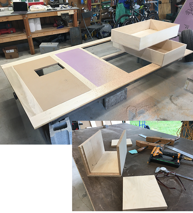

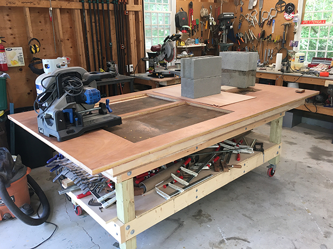

Postby Capebuild » Mon Jun 14, 2021 5:01 am
June 13, 2021
Thanks Rob and Tim.....
after a bit of research I think I'm going to go with the Henry's Asphalt Roof Coating. I had liked the elastomeric paint direction...Something about the henry's product seems like it would adhere better to the wood which has already been coated with varnish.
Yesterday glued the top ply panel onto the floor frame. Didn't use any nails, just a squeegeed a ton of TB on both ply panel and frame surfaces, weighed it all down in the middle and clamped around perimeter.
The footwell boxes and the battery box are completed. I think I'll wait to install them into the floor frame until after I bolt that framing down onto the chassis frame.
Speaking of axle, that might be ready for pick up this week. Need to call today and get status.
thanks for looking.
John

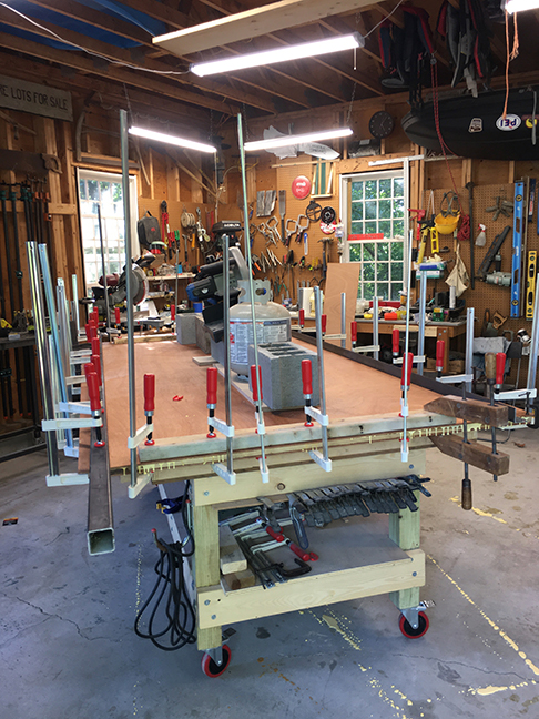

Postby Capebuild » Mon Jun 14, 2021 2:45 pm
June 14, 2021
Removed all the clamps and weights that were compressing the top layer of the floor framing after top layer was glued in place yesterday......and WHOAAHHHH.... What a warp in the assembly! The floor assembly developed quite a warp in the long direction. I guess if it was going to warp like that, it did it in a "good direction" as opposed to warping with the outer edges warping upwards. In the mean time, weighted the frame down to maybe try and reduce the warp. I think to resolve this I'll weld a couple of additional bolt tabs in the middle of the chassis framing so when positioning the floor framing for final attachment, I'll bolt those two tabs first which will pull the floor down flush with the frame and then fasten the outer bolts down. Should (hopefully) solve the issue.

Postby eLink » Mon Jun 14, 2021 3:18 pm
Capebuild wrote:June 14, 2021
I'm surprised it did that considering that both sides are now glued. I'm guessing that the large footwell openings had something to do with it, causing some uneven shrinkage. The sidewalls should straighten that out and, like you say, bolting it down will also help.

Re: CapeBuild Build Journal
Postby halfdome, Danny » Mon Jun 14, 2021 5:45 pm
Your foot wells should act like a stiffener and somewhat straighten the warp along with the walls as mentioned before.

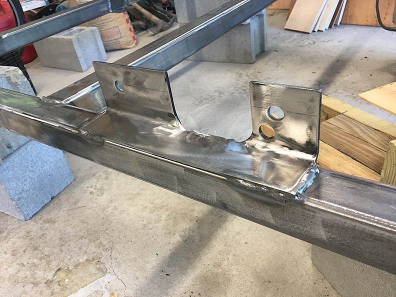

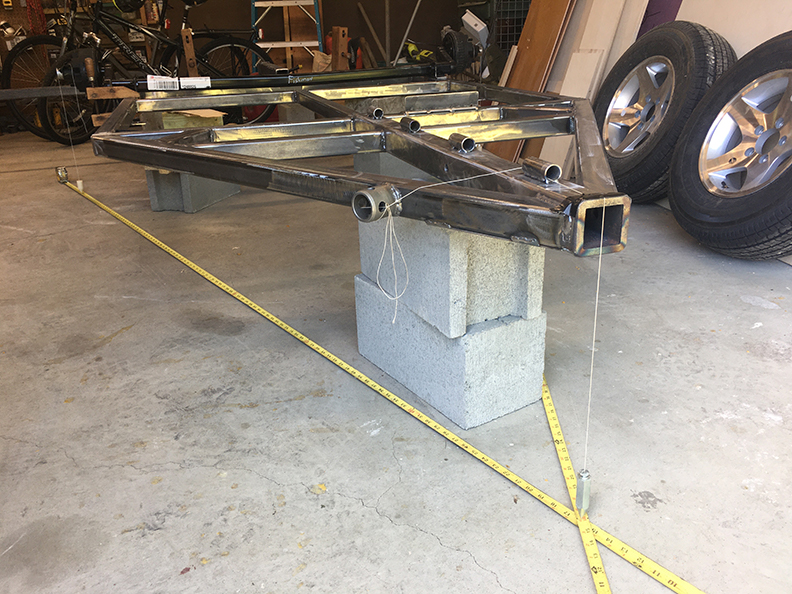

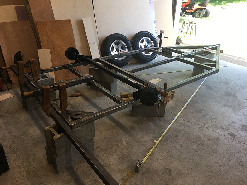

Postby Capebuild » Thu Jun 17, 2021 3:30 am
June 17, 2021
On Tuesday I picked up the axle and yesterday positioned it on the frame. I used Tony Latham's method described in his book to line it up on the frame.
In addition I also clamped a piece of square tubing (2nd image) onto the rear of the frame, extending it out from the sides, so I could have a 2nd way to measure
to the center of the wheel hubs. I only had one plumb bob so turned a couple of pieces of ABS with 60 degree tapers to create the other 2 plumb bobs.
Now that I have the 2 brackets (that hold the axle) welded onto the frame I can't believe the entire weight and structure of the trailer, and the axle that carries it all, relies on these two brackets.
I didn't measure the bracket material's thickness, but seems to be .125" material. Guess I'd feel better if they were a bit heftier, but I suppose this is what everyone's axle uses........
Planning on painting the frame today. 2 layers of zinc spray undercoating and 2 layers of black enamel. Then will bolt the axle in place, and move onto installing the floor deck.
John
