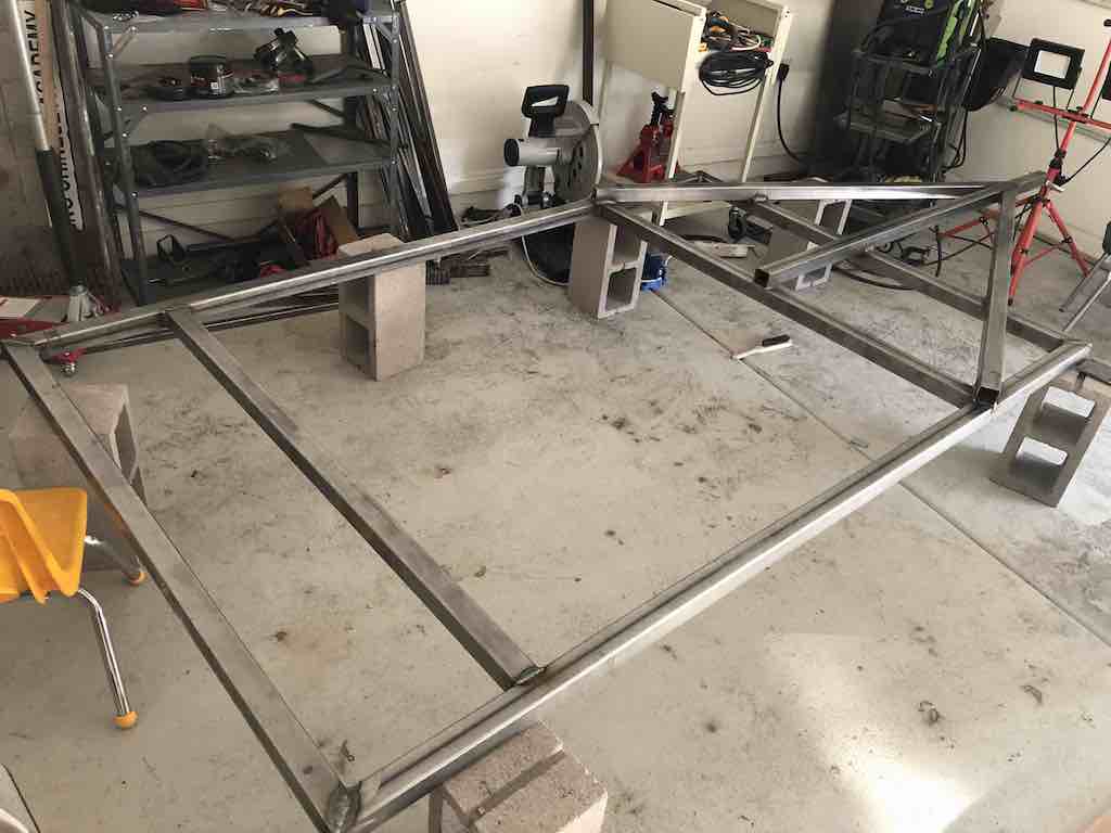

I took a long break. Restarted building again, and managed to weld the frame together.
However,I just found out it's hard to find a spacer that can fit perfectly to a custom hub. I just came back from a store, tried 3 different ones. The dimension is all over the place.
Now, I'm also looking into getting a set of wheels instead of the spacers. One question I have is, after everything is installed, what is the proper distance between the tire wall and the frame wall? (or fender wall) , 1 inch, 1.5 inch or even more?

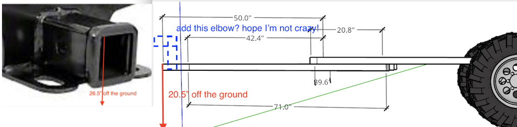

I have a somewhat solution to the problem of the Timbren bracket rubbing the tires. It turned out my bigger 37" Jeep tires have a negative (-18mm) wheel offset, that will give me the 1.5" clearance between the tire and the Timbren bracket.
Now, I see another challenge (I guess that's how DIY works :FNP). My Jeep receiver is 6" higher than the trailer tongue. With the 37" tires, my Jeep receiver is 26.5" off the ground, the tongue height is 20.5".

Normally, i can just pick a receiver adapter. However, I'd like to use an articulating coupler like Lock-n-roll or Max coupler. Both of them have a maximum 4" adjustable drop. So the tongue will still be 2" lower than the receiver adapter.
Questions: 1) how bad is it the trailer coupler is 2" below the adapted receiver? 2) This is a wild question, can I weld an elbow onto the tongue? essentially adding my own adapter. My guess is this is a bad idea. I don't remember seeing anyone doing it.

I think I figured out the answer for the 2nd question. I don't think I can weld the elbow to raise the tongue. I noticed the real hitch adapters are all made from solid steel, not square tubing.
I'm still not sure about the 2" gap between the hitch adapter and the tongue. Timbren has another suspension that may fit my Jeep wheels. That suspension will raise the tongue to 22", which means the top edge of the frame will be 24" off the ground.

I often see a square tube welded in parallel on top of the tongue bar...Maybe a foot or so of overlap down the tongue to have adequate weld strength. Doing this with a 2" square tube would get 2" of rise.

DrewsBrews wrote:I often see a square tube welded in parallel on top of the tongue bar...Maybe a foot or so of overlap down the tongue to have adequate weld strength. Doing this with a 2" square tube would get 2" of rise.
Thank you DrewsBrews! I have contacted Timbren. I may have a $200 solution to recover from my design( the lack of it) mistake. Timbren spindles can be purchased separately for $200 with different height requirements. I'm going to get a pair of spindles to raise the tongue to 24". Lock-n-roll sells 2.5" drop hitch, that should match my 26.5" Jeep receiver.

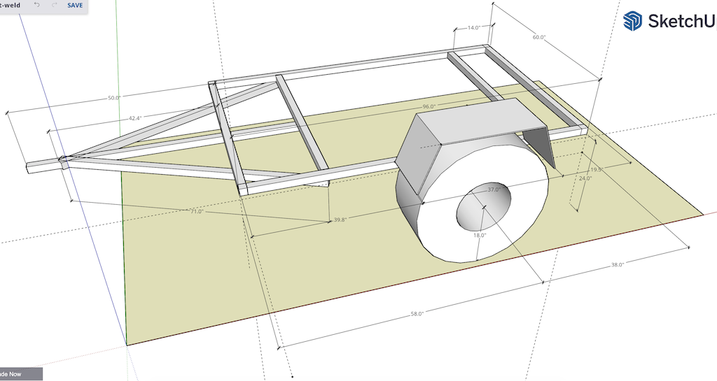

I'm struggling with the axle balance position...
Install the axle near the 40/60 point on the frame (excluding the tongue) and you'll be fine.

Postby DesertApprentice » Mon Sep 06, 2021 3:19 pm
Thanks Tony! That's where I have put the axle in my design now. The balance spreadsheet works out that way too.
The 37" tire solves the problem of tire space to the frame, but it skews the geometry. I'm willing to explore along this direction and hope it will work out. Here is the update as I rework on the design. The front of the fender to the camper front edge is less than 40". I'm drawing the new cabin and doors as we speak.
