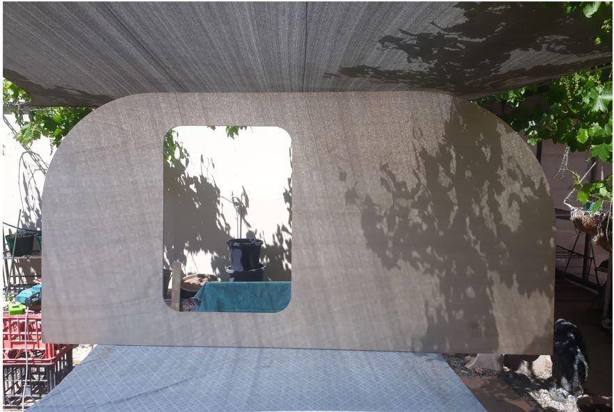

Postby MickinOz » Sun Oct 10, 2021 8:36 pm
Left side.JPG (95.5 KiB) Viewed 910 times
When I built Ol #1, it was prolly 3 or 4 weekends between dragging the wall sheets off the pile and finishing with a cut wall.
This weekend I have the first wall cut out, and will do the second when I've finished lunch.
I bought a new Ryobi jigsaw, as my very old secondhand when I got it Makita tends to wander all over the joint.
What a difference a good saw makes!
Still put the router on a compass and trimmed the curves, but I could have gotten through without it if I didn't own one.
Its basically a Rimple, but I reduced the front curve to 22 inches and increased the rear curve to 26 inches.
I reckon the asymmetry makes it a bit more Benroy-ish.

The floor of the trailer was sitting upside down on the chassis. I gave the underside 2 coats of the mix yesterday afternoon.
"She'll be right, son," I said to my youngest. "We'll put it right way up tomorrow after the poly dries. No rain between here and South Africa, surely."
On hearing the rain, I woke my son and we muscled the floor in under the carport, and stood her up on one edge so the water will drain.
Decided that the shed would muffle most of the noise, and fired up the compressor to blow a fair bit of the water out.
