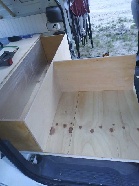

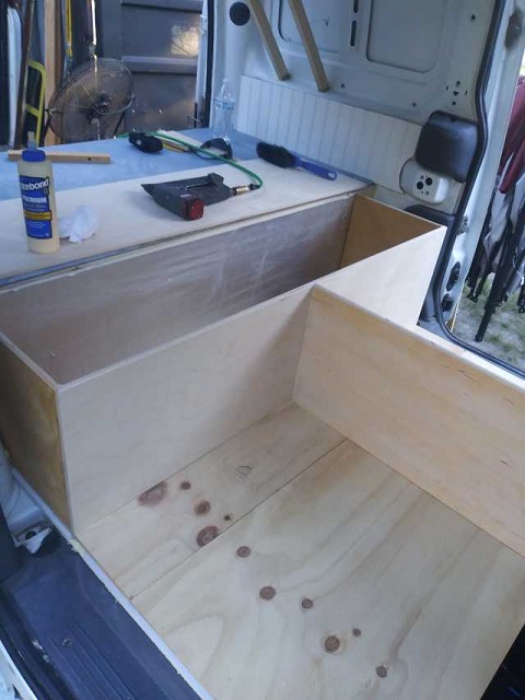

Next is the storage compartments under bed platform. Spent some time :thinking: things out in my head..
Area for the compartments is 4' wide x 44". Divide the area into smaller compartments and designed to have support for the mattress platform.
So right behind the cabinets, a compartment 12" wide x 47" long. Multi use area, over the fire cooking tri-pod, extra bottled water, rod and reels, extra fuels cells for the camp stove, etc. This compartment will have a completely removeable top, for easier access from both sides of the van..

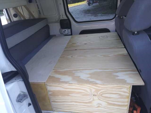

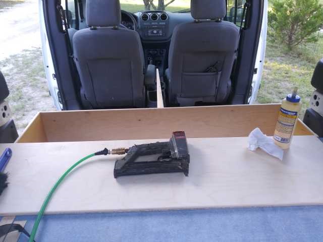

Moving right along to the compartments right behind the seats. This area will be split into 2 sections. One, for the battery, fuse box, battery charger etc. And anything thing else that can be stored out of the way. The second box will be for things like bedding (sheets, pillows, blankets). Complete first aid bag. To go bag, (this bag is for things needed away from the house camper, meds, computer or tablet, chargers for accessories).
I have these compartments back far enough from the backs of the seats. There will be room between them and the seats for things like jumper cables, 25' shore power extension cord, 50' drinking water hose, jack, battery lanterns.

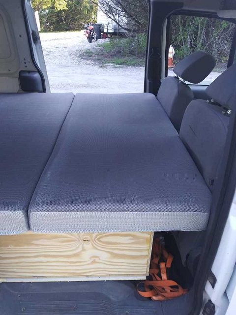

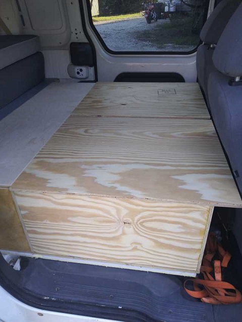

Plywood storage area boxes roughed in. Top plywood cut to check sizing. The 2 top pieces to be hinged in the middle, for easy access from either side of the van. Seats were put in the best position to be comfortable and leaving room for them to be adjusted. Which accomplishes 2 things, Top longer than the boxes, adds just enough length for the full-size mattress. And allows for storage between the boxes and back of the seats.

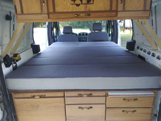

Pictures show the tri-fold mattress. Folded and laying in the back under the upper cabinets. Plenty of room for it. (Left click pictures to enlarge them).
No Baltic birch to be had in several counties here in Texas. Or cost 3 times what it did before Covid took over. So I'm using 1/2" BC ply, and could only find it in 4' x 4' sheets.. It will work good after sanding it and coating it all with spar urethane. Will thin it out for the first 2 coats, then full strength for the last coat.
Tri-fold mattress extended: fits perfect.. :applause: :awesome:

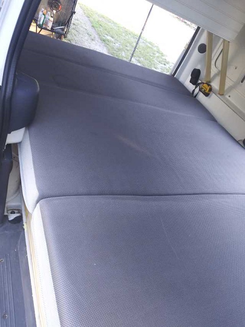

We did figure out, with the mattress fully extended. It works better if the front seats are tilted forward.. plus leaves a little more room for the pillows.
Sometimes, because of my age and the abuse my body has taken over the years. I have to sleep propped up sometimes. And the seats being tilted also allows for this position... a win, win...
Plenty of room for 2 adults, to sleep comfortable. Easy access from both side doors. Don't have to crawl over each other to get in bed or out.
Mattress folds up easy to allow access to the compartments under it.

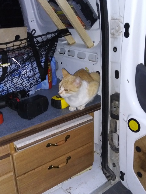

While working on the van, my supervisor showed up to check on the job. Her name is Precious.. She's a little feral or stray cat that has adopted us. She sure likes our attention..
