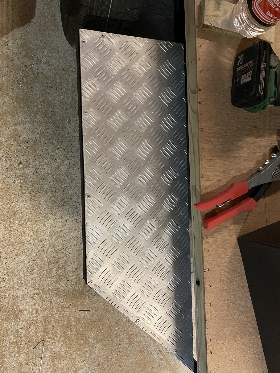

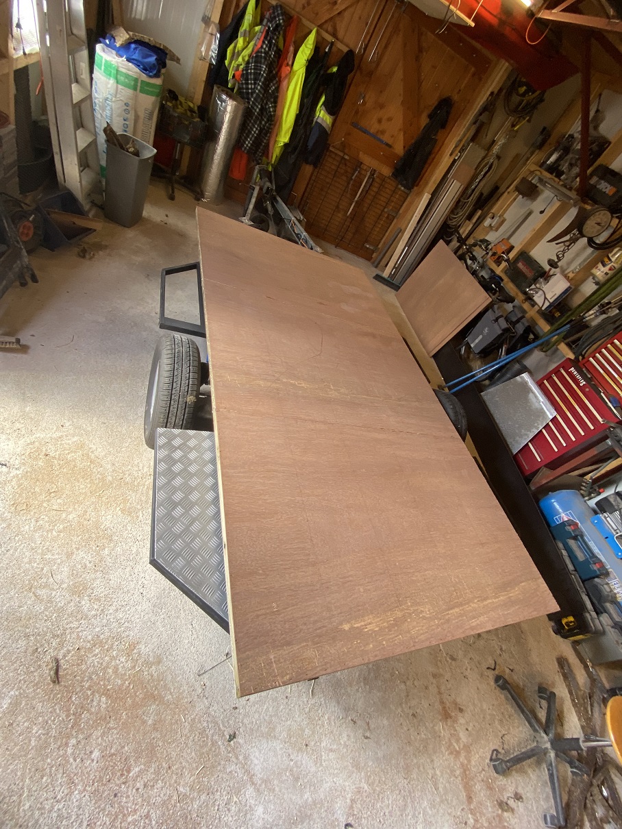

Last weekend i finished the insulation of the floor. Covered it with 6mm (1/4inch) plywood.
Also placed the first side step.

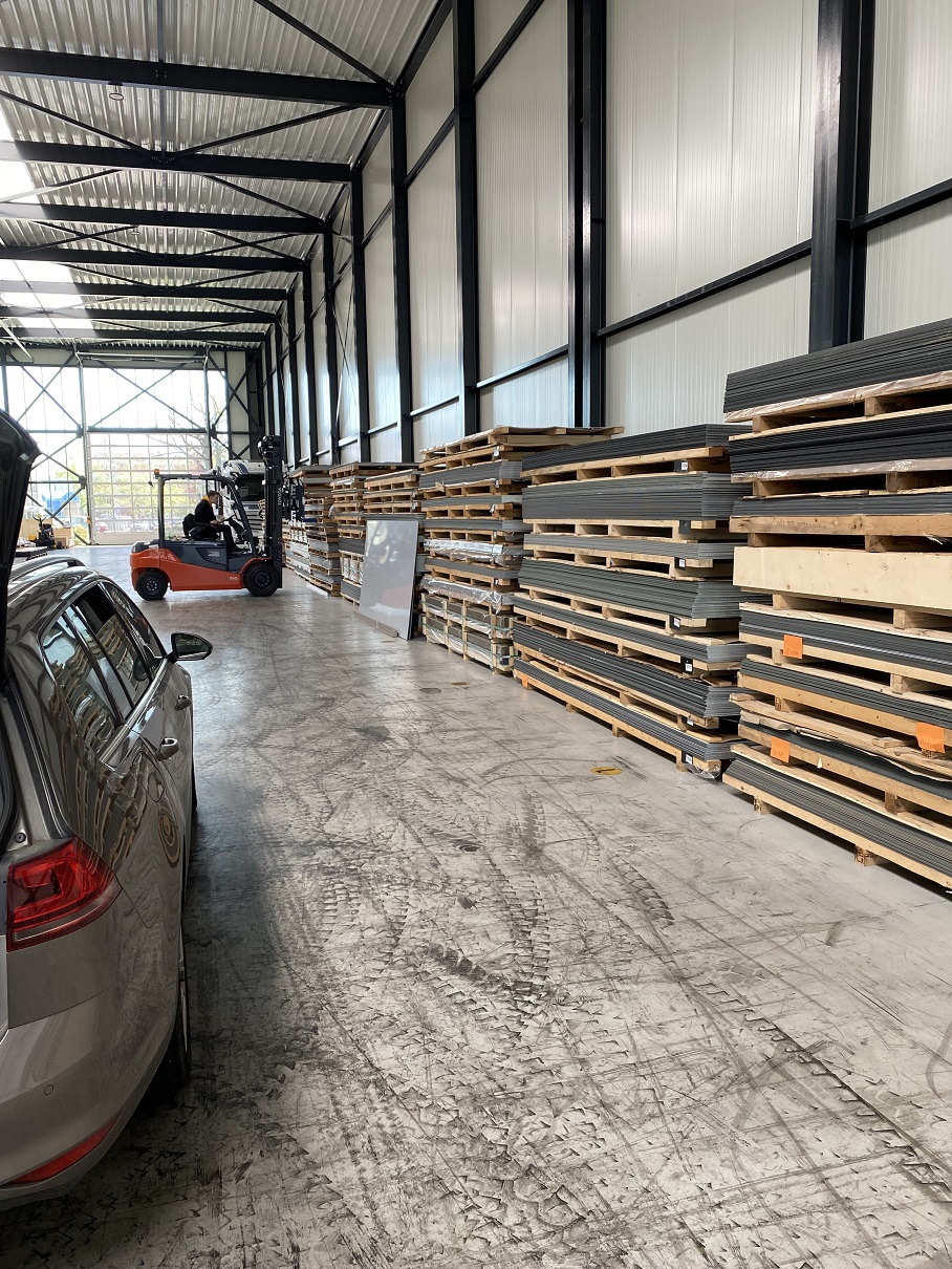

Postby Marcogs » Fri Apr 29, 2022 4:19 pm

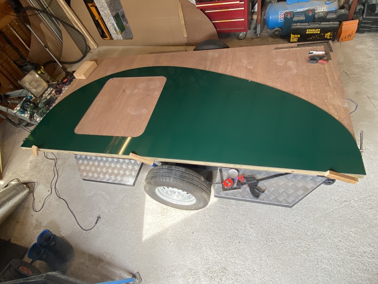

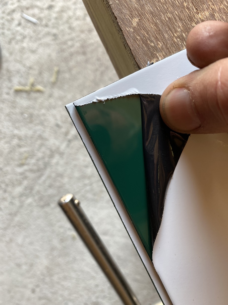

Finaly, some materials in house.
* Dibond composite plate in mat green.
* Aluminim square tubing for stiffness between the Dibond and the inside finishing.
* 2cm thick insulation
* the polymer bonding material
* and the (insane expensive) router bit
The final shape is ready, so tomorow is cutting day :thumbsup:

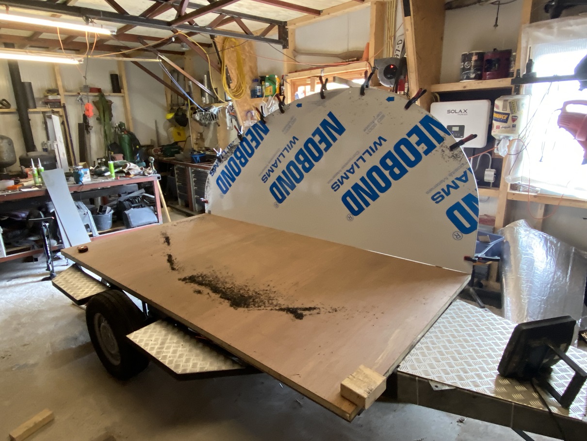

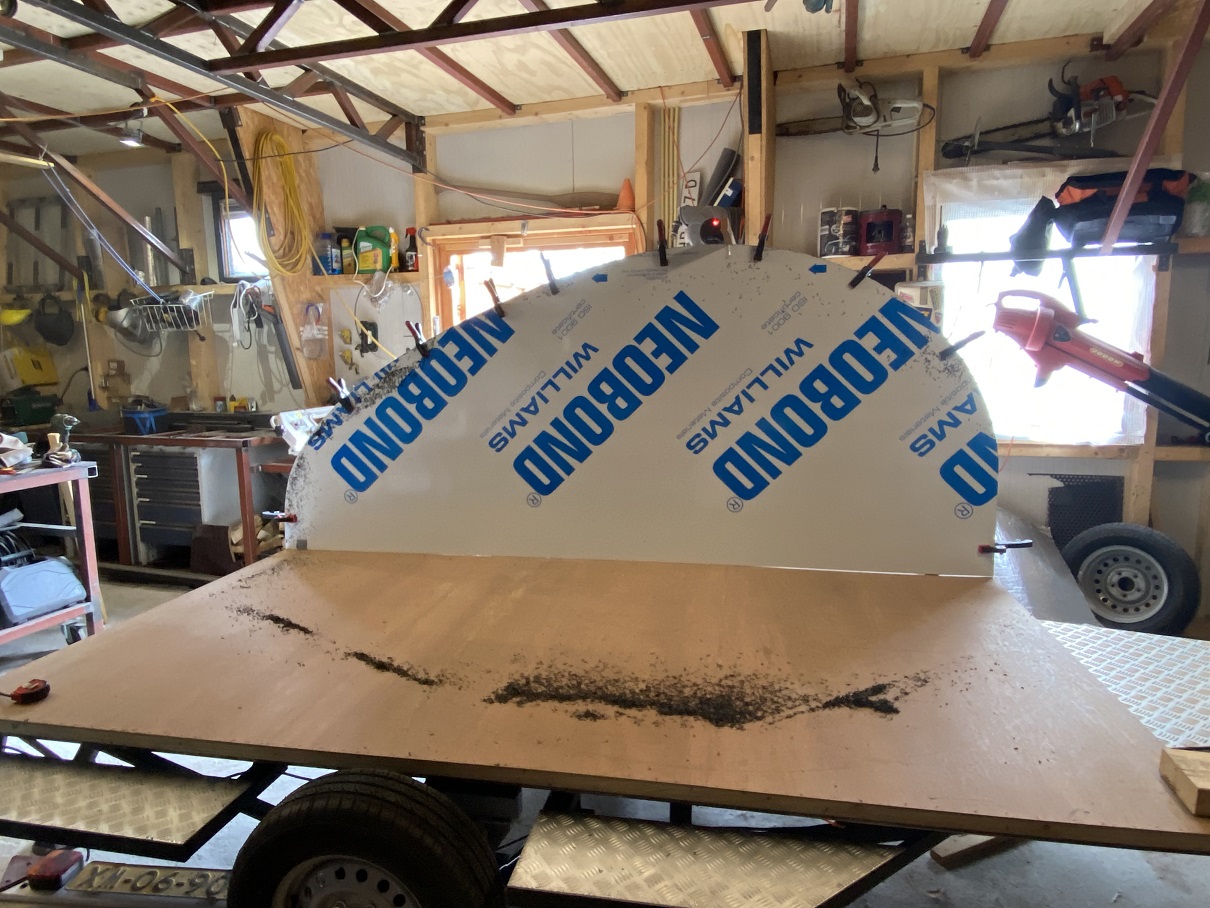

Postby Marcogs » Sat Apr 30, 2022 3:04 am
Litle explaning,
The two pieces of plywood i purchased last week are not being used for the walls. To heavy.
Instead i will make my own sandwich creation.
Outer shell is going to be the Dibond panel, then the 2cm insulation and at the inside a thin layer of plywood. Saves me almost half the weight.
The Dibond comes two color schemes actually. One side is high gloss and the other is matt finish.
I am going to use the matt finish on the outside.
This is the gloss side
Today is cuttingday, wish me luck. :thumbsup:

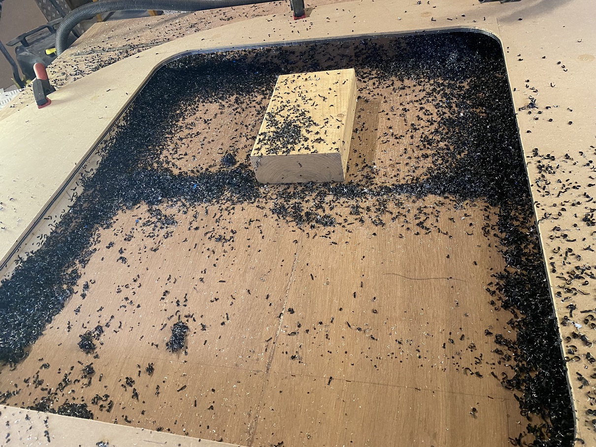

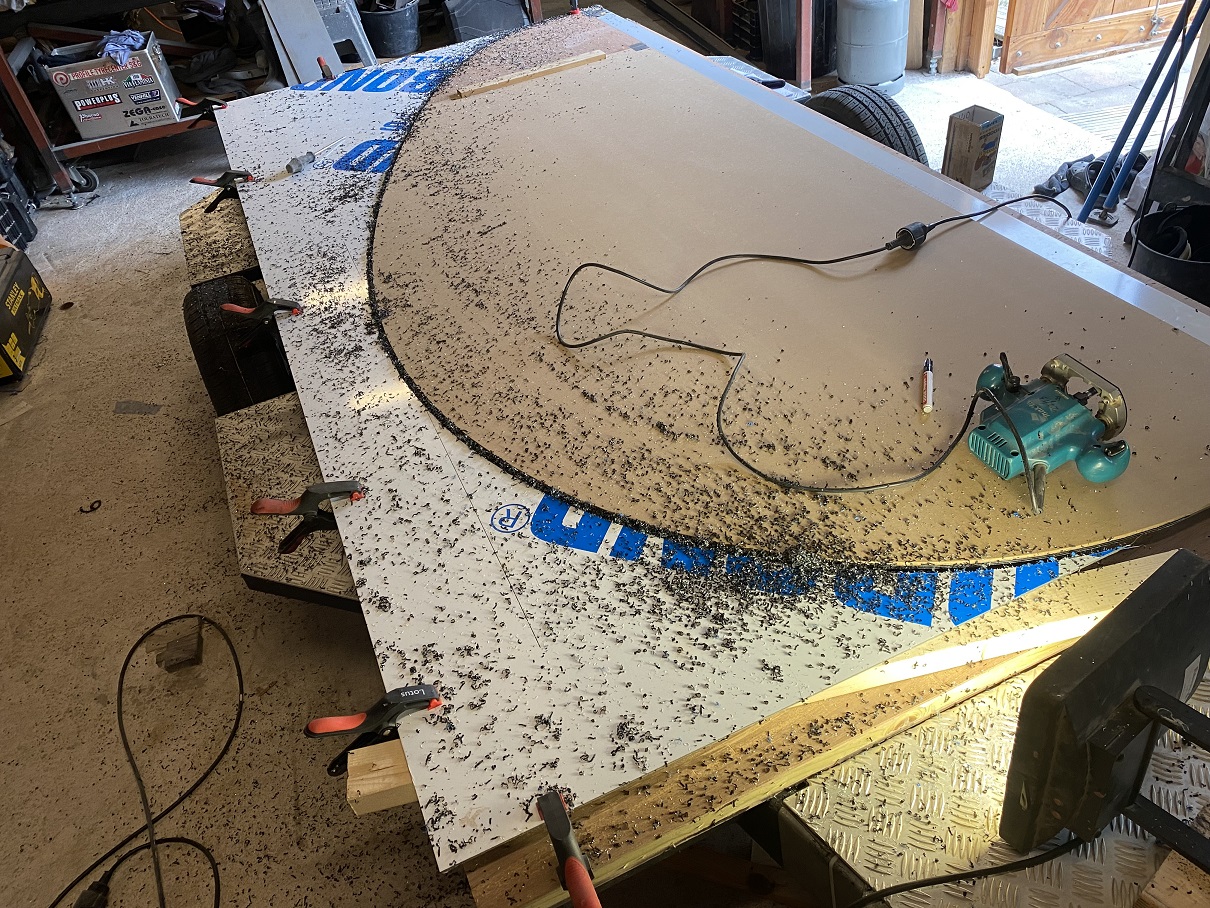

Postby Marcogs » Sat Apr 30, 2022 6:51 am

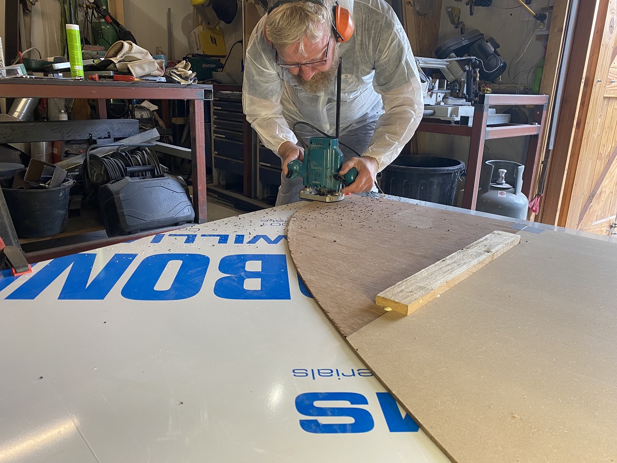

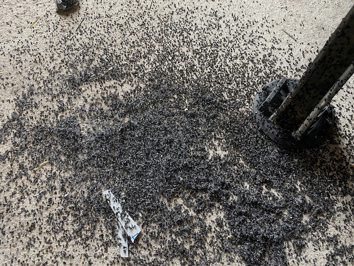

Within 20min the job was done. But holy f..... what a mess. :shock:
Marcogs

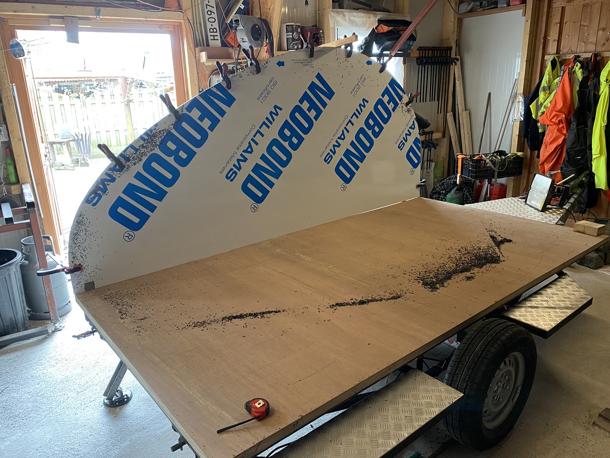

Postby Marcogs » Sat Apr 30, 2022 6:55 am

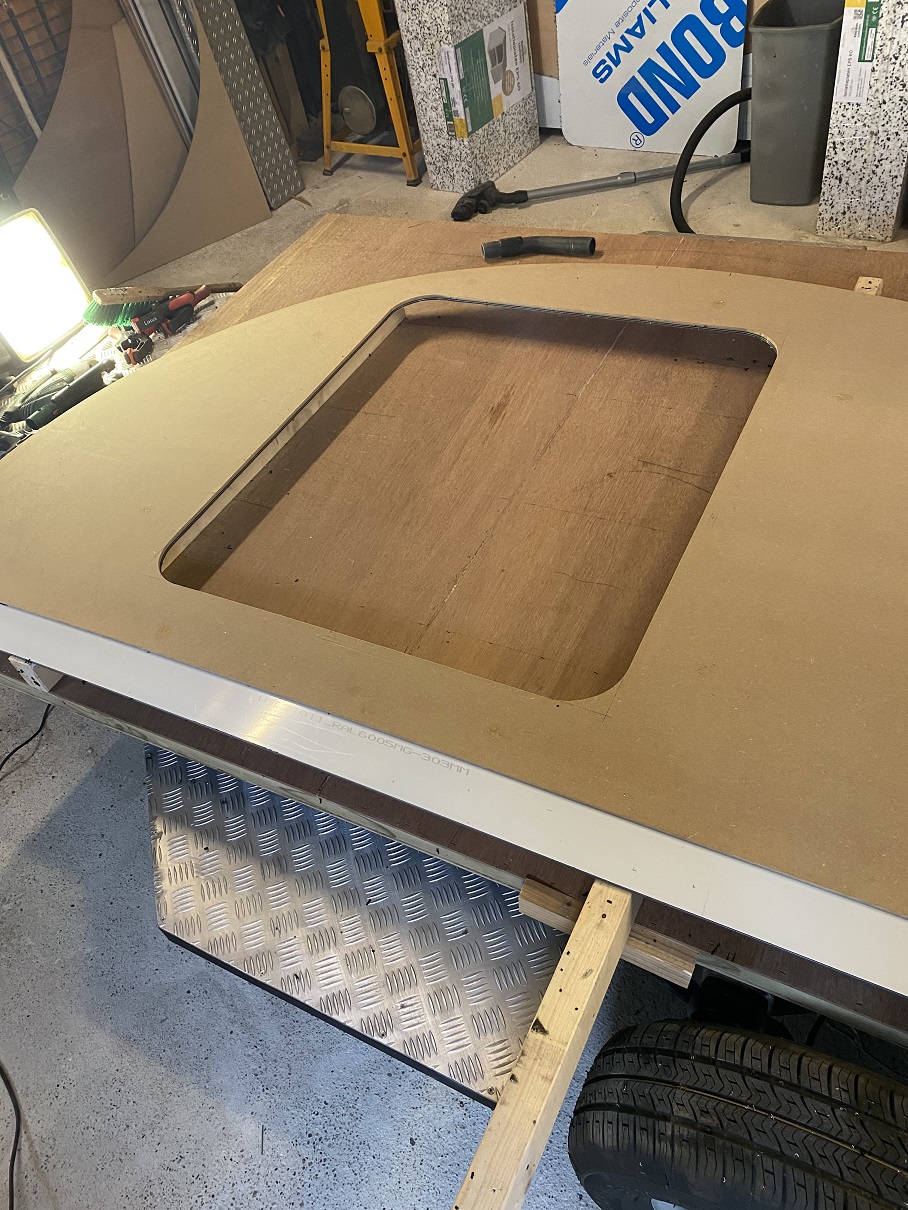

Next job is to cut out the doors, but the result so far is satisfying.

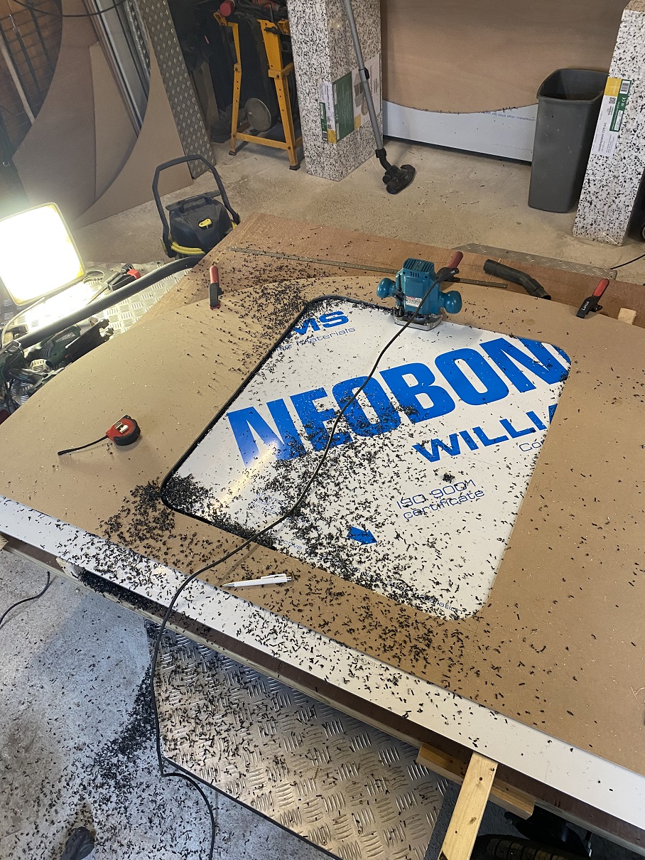

Postby Marcogs » Sat Apr 30, 2022 1:43 pm
Last action for today, the doors.
So the router was used well today. (dust collector even more :-))

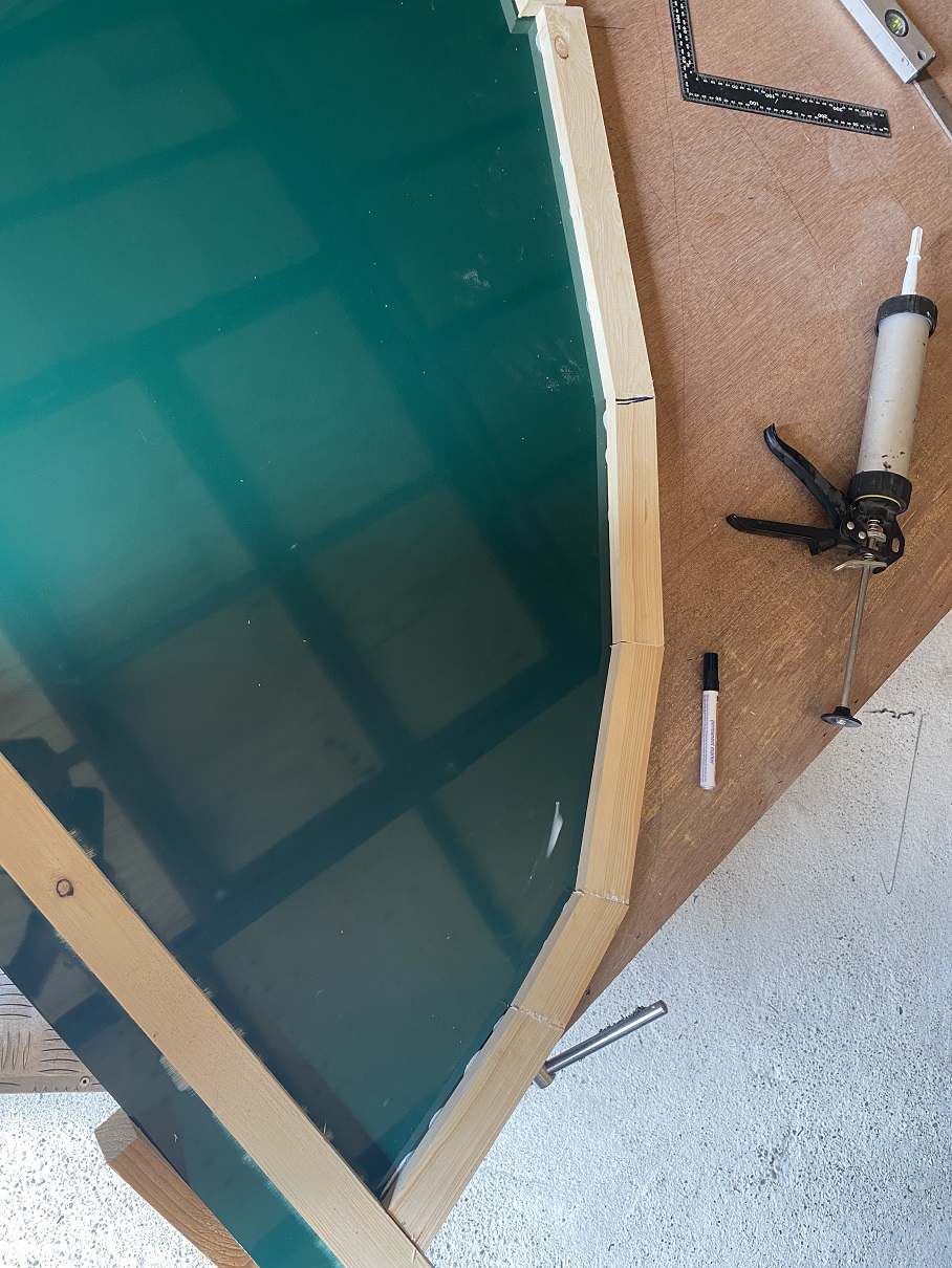

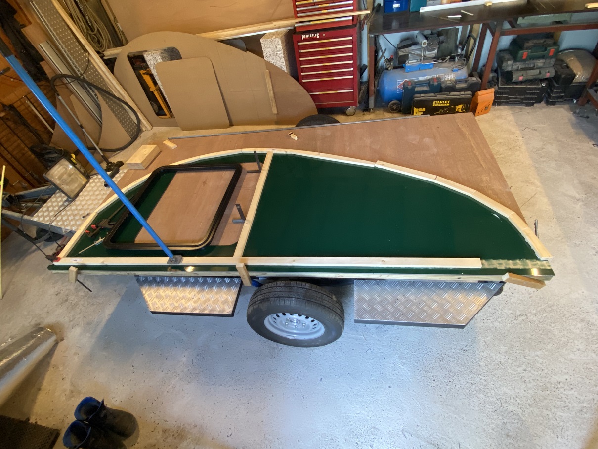

Postby Marcogs » Mon May 02, 2022 12:58 pm
Next steps is to make the backbone (is that the right expression :thinking: ) between the outside and the inside.
Was convinced that i purchased the right glue, but dicided to switch to another brand. So have to wait till tomorrow to go on.
Last photo was taken in an strange angle, so it looks like a very tiny thing.
The actual hight indoors is (give or take) 48"
So ready for today.
Good evening, or for you all over there good afternoon :lol:
Marco

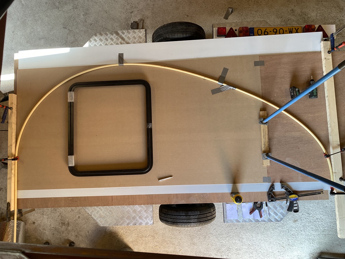

Litle update..............................uhh i fucked up the walls
How??

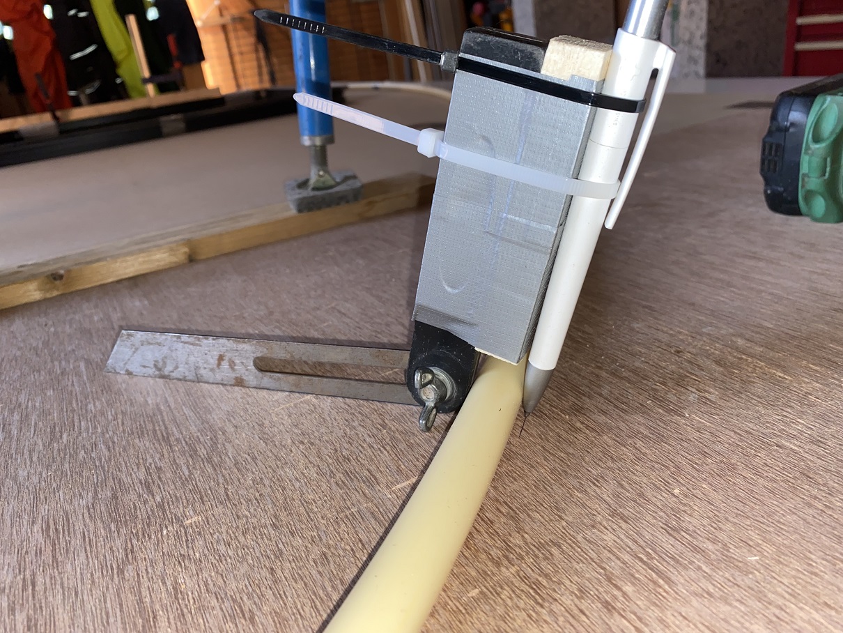

I'l try to explane. I hand drawed the outher lines of the walls. It seems to be perfect, but it didn't.
The rear end of the " drop" i made to steep. With the consequense that the countertop could not be close enough to my body, and so i had to reach to far.
I know myself and decided to buy new ones. :cry:
The design adjusted and the new ones are already cut. :applause:
Mistakes are made, but some costs more than others.
Marcogs
