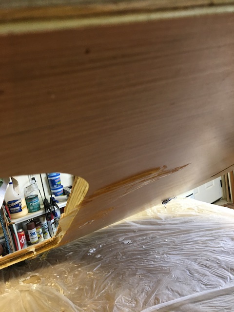

Well, a little bit of a setback. I did get the fiberglass work done over my exterior wall wood strips, but it turned out I had a leak in one spot underneath and got about a 6 inch area of epoxy on my inner wall. If you remember, I used poplar ply on the inner wall because I cannot find any 1/8 inch Baltic birch in my area. Poplar ply has such a thin veneer that there’s no sanding the epoxy off. I do plan to go to Houston next month (a 9 hour round-trip) to buy enough 1/8 inch Baltic Birch for my headliner and roof. So now I think my options are either wallpaper over it, or cut a new wall out of 1/8 inch Baltic birch and laminate it. Any votes or suggestions? :NC

Got a photo?
Re: Beyond the End teardrop (Tony Latham-style build)
Postby orourkmw » Fri Feb 18, 2022 12:11 pm
Hey, Tony. Here's a pic from below, as I don't want to flip the wall over till the epoxy is fully cured...hope you can see the mess. I see a couple of other spots, mostly behind where the door trim would be. In retrospect, if I had had the wood for the strips when I got started, it would have been much better to do the exterior wall first.

Ouch. I wonder what it might look like when the interior is varnished? You might saturate a piece of that plywood with a spot of epoxy, let it cure, and then varnish it. It may not be too eye-catching.
Thinned polyurethane becomes darker than the straight stuff since it soaks in.

Thanks, y'all. I am reluctant to epoxy the whole wall. I've actually got varnish on the interior already, and the epoxy spill has some dimension to it...I may try to sand it down to just above the surface and try Tony's thinned PU trick. I'll probably ruminate on it for a while and work on something else. The poplar ply was really not a good choice. I had already purchased some welt to install at the seam to hide the microchips on the edges...the veneer chips so easily and the yellow wood showing from the second ply underneath just makes it look ragged. Otherwise, it does make a pretty surface when varnished.

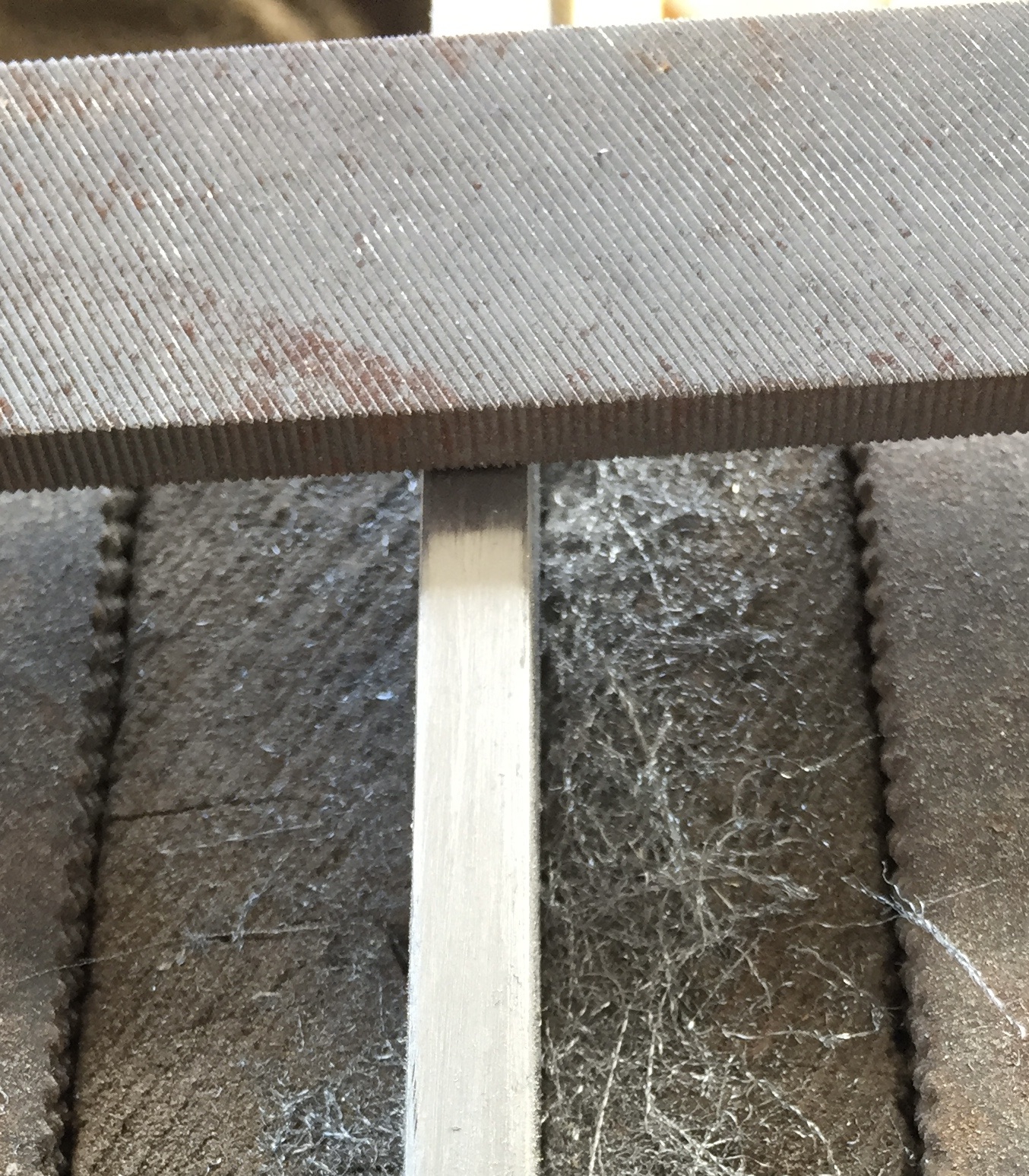

it is possible that can be scraped away w/ a cabinet scraper that has been sharpened to have a burr on the working edge
most sanders w/ rubberized pads will not produce a fair surface
once you are comfortable with turning it over try scraping it
make sure the ends of your scraper are curved gently away from the scraping edge so as to knot gouge w/ hard corners
i'm betting this could work by cutting/scraping down to just into the actual wood about a hair's depth(literally) and be touched up w/ some fresh varnish
this issue is knot uncommon in boat building and boatbuilders become good friends w/ cabinet scrapers
if you can carefully flip the wall and do this just before full cure(just barely soft butt no longer sticky) for easier pox removal
if you don't have a scraper i have found the sharpened edge of a plane iron works fairly well
by SHARPENING i mean putting a good crisp 90º edge on the metal not a beveled one
this can be accomplished by draw filing using both hands to keep the file balanced
i do it in a vice holding the iron between 2 blocks of wood
IMG_4997 ll.JPG (813.51 KiB) Viewed 1545 times
hope this helps/saves you some work
sw
