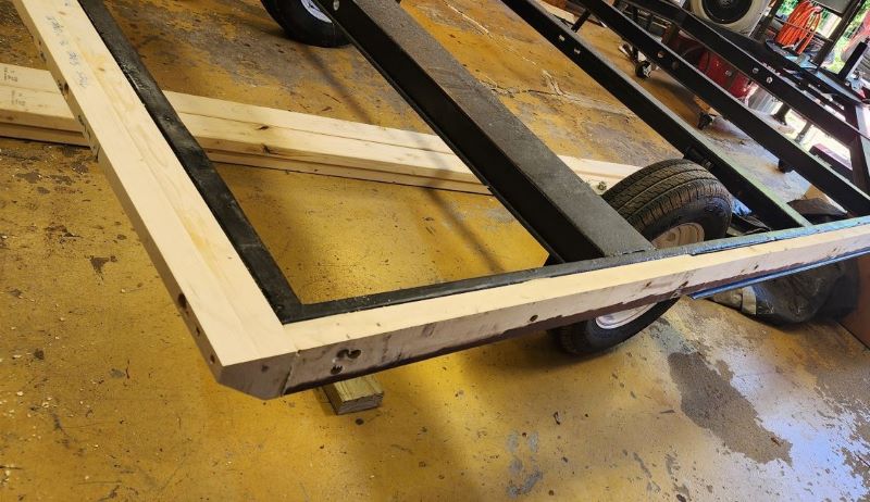

From the beginning, I knew i needed to have a minimum internal width of 75". The plan is to have all the beds configured "East/West", and I am aiming for a full size QUEEN.
This meant I needed to add to the frame I had. I mounted some 2x4s to either side of the frame with construction adhesive and 1/4"-20 Carriage Bolts. I also painted the bottom side of the 2x4s with a fence and siding paint that I found in the "reject" pile at Menards. $10/gal for a $60+ can of paint!
The primary wall sheeting will attach to the OUTSIDE edge of these 2x4s.
This adds 3" to my frame and gives me just enough wiggle room to squeeze a 75" mattress in there!

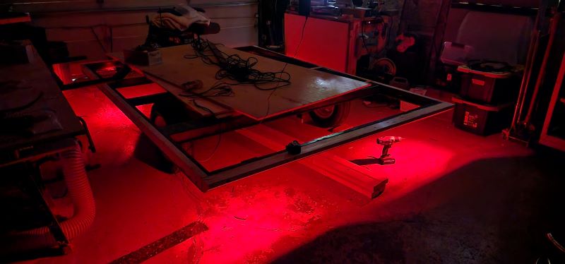

I have always loved to tinker with electrical, and this project will be no different. There will be some under body lighting on the camper. Red/Amber/White.
Red for low light clearance, and to protect the shins when walking around after dark!
Amber for some actual lighting for the inevitable case where the kids loose something under the trailer.
White for "work" lights if needed after dark!
The camera adds a few lumens!

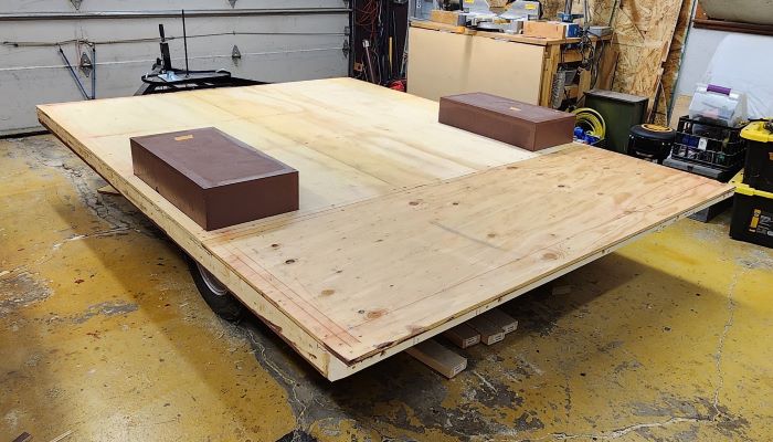

Got the deck mounted today. It is starting to look like a trailer!

I added 2x4's to 3 sides of the frame to give me a good base to attach the walls and the back curve.
These were bolted (1/4"-20 Carriage) and glued (Locktite PL3) to the frame.
( see previous post )
I used 5/8" ply for the floor. This gave me the structure and support I wanted, and allowed me to save some weight vs a more traditional 3/4" ply.
The floor was screwed and glued to the 2x4's using 1 1/2" screws and Locktite PL3.
The floor was also screwed to the metal frame using special Ply-to-Metal self tapping screws.

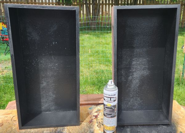

I made the wheel wells from the remaining 5/8 ply. Glued and screwed together. (Titebond 2 and Construction screws).
The inside of the wheel wells was covered in Rust-oleum Truck Bed Prograde Spray on bed liner. (My local Ace Hardware had them on clearance, $14/can down from $28/can). It took 1.5 cans to apply 2 nice thick coats.
Wheel wells with 2 heavy coats of bed liner

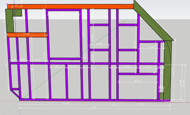

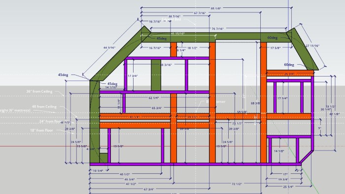

So... after sleeping on it for a few nights... I have decided to redesign and rebuild this wall. I was not happy with how it was actually going together, and it seemed... off...
So I went back to Sketchup and Started over... I started by laying out a grid with 16" on center vertical studs... and THATS when it Hit me! All of the windows, and doors, and luggage doors I had were designed for 16" on center installs... my first design I was trying to build around the windows and doors independently... this time around I laid it out based on 16 on Center and lo and behold, it is a much better, less complicated, and much LIGHTER design!
The other "benefit" of the redesign is the Horizontal Line where the seam will be for the aluminum siding is "adjustable" as there are no major components that rely on the horizontal support placements. This design gives me 47" for the top panel height, and 30" for the lower panel height, with room to adjust either way to account for "build accuracy."
Version 1:
Estimated Weight: 87lbs
Version 1
Screenshot 2024-07-11 104311 (Phone).png (20.25 KiB) Viewed 1935 times
Version 2:
Estimated Weight: 71lbs
Version 2
Screenshot 2024-07-11 104837 (Phone).png (37.77 KiB) Viewed 1935 times
So now it is time to head back to the garage and make some more saw dust!

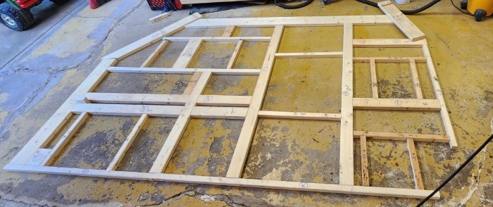

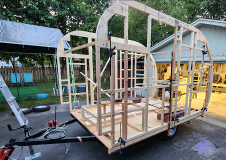

Well, I made it! After tinkering with the design, I plowed ahead and got the first wall built.
It went together in just over an hour! Much easier then the first design! And lighter.
Pass Wall Frame.JPG (68.54 KiB) Viewed 1867 times
There are a few small horizontal pieces missing from this image that complete the seam line support...
and the TOP edge will be a full 8ft 2x4. This will provide plenty of space (and strength) to mount a larger canopy if I decide to go that route.
I am primarily using 2x2.
The angled 2x6 on the front and back edge provide enough meat to cut the curve when I lay the template over it!
I have the driver side lay out complete, and cut list made, so I am hoping to get that together this weekend.
This side is estimated to be 71lbs.
DriverSide Layout.JPG (58.29 KiB) Viewed 1867 times

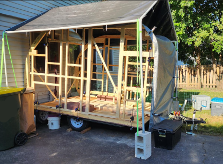

I have erected a 10x10 tarp shelter in the back yard to house the project through the winter...
10 x 10 tarp shelter up!
Oct update tent.png (316.74 KiB) Viewed 1596 times

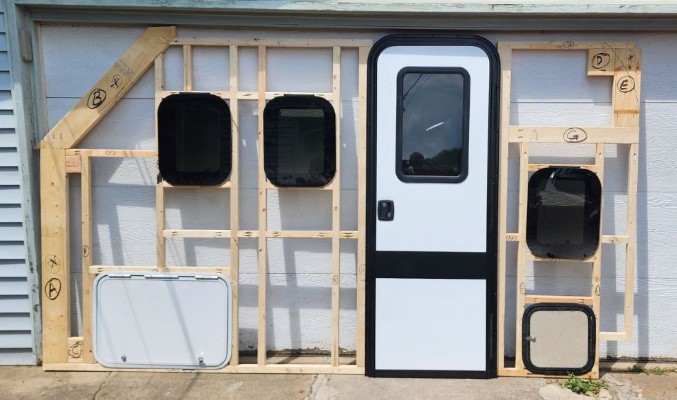

Both walls have been framed, and 75% of the interior walls have their panels. For the interior, I am using prefinished 1/4" birch panel from Menards. It was only after committing to these, and installing the first few that I finally found the local lumber yard that all the cabinet builders use! They also have prefinished birch panels, 1/4", 1/2" and 3/4" for the same price as Menards, but MUCH better quality! They also have bendy ply that I intend on using for the roof.
Walls Test fitted
Oct Update walls up (Phone).png (343.73 KiB) Viewed 1596 times
Inside wall panels.
Oct Update Panels (Phone).png (342.15 KiB) Viewed 1596 times

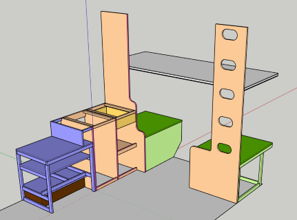

I have built 3 of the 5 interior "furniture" pieces that will support the walls.
For the internal "furniture" I am using 3/4" plywood that has been ripped to 1 1/2" wide, with pocket holes and glue.
These will be faces with the scraps of the 1/4" birch panels that are left over from cutting out the windows and doors from the completed walls.

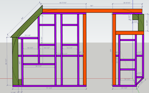

I have worked out a design for the front bunks that should add rigidity to the build, and privacy / functionality to the bunks for the kids!
Current Bunk Concept
Oct Update Bunk Idea (Phone).png (58.22 KiB) Viewed 1593 times
It will also give me a great place to use some of the Black Walnut boards that I was gifted as trim!
The two "walls" will be 3/4" birch ply, finished on both sides. These will attach directly to the exterior walls to provide good vertical support. The green sections are storage, with the one on the right being the "garage" and only accessible from outside. The one on the left will only be accessible from the top, which will be storage for blankets and bedding.
The blue (lavender?) color is the support for the queen size bed, as well as the housing for all of the electrical and battery systems.
The orange in the middle will be the housing for the AC unit, as well as two cubbies for XL milk crates for the kids storage. On top of that will be a home made butcher block counter made from oak/hickory from our family property.
12v Fridge compartment
Oct Update Furniture1 (Phone).png (204.47 KiB) Viewed 1593 times

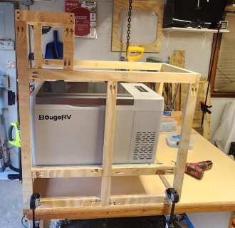

Inside the door, across from the "garage" will be a small compartment to store our 12v Fridge. This also doubles as more support for the queen bed.
Furniture layout
Oct Update Furniture2 (Phone).png (380.2 KiB) Viewed 1593 times

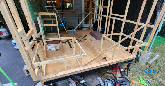

You can just make out the furniture I have completed in this pic.
A = Fridge compartment
B/C = front lower bunk storage sections.
You can also see the front "curb" I have added to the frame to act as a support for the roof/ceiling. It will also help give some physical support to protect any coolers or water jugs from smashing through the front wall of the camper "Kool-Aid Man" style should i need to perform any brake tests!
I am hoping to get back out to the garage and work on the camper some more this weekend! Watch this space for more updates!

The 10x10 tarp shelter is holding up well. Not ideal, but it is doing the trick for now.
We had to go back for more panels, and unfortunately, despite being the same manufacturer, they are a completely different shade of birch. Luckily, there is enough that only the front "bunks" will have different colored walls.
Two Colors!
Oct update two color (Phone).png (246.02 KiB) Viewed 1031 times
There will be a support wall that covers the seam between the darker back half and the lighter front portion of the walls, so hopefully, the color difference will not be too noticeable.
