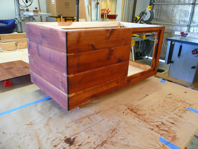

I finished the construction of a wood chest to house my Petcool on the tongue. The chest has a bowed top and two doors - one on the side and one of the end, that will open to allow intake and exhaust air for the Petcool. To give it an aged look, I used Transtint dye to bring out the color. After this is fully dried, I will epoxy and varnish the chest.

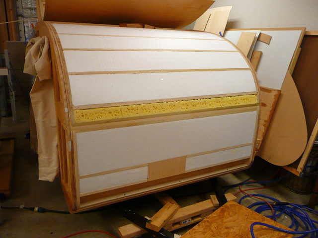

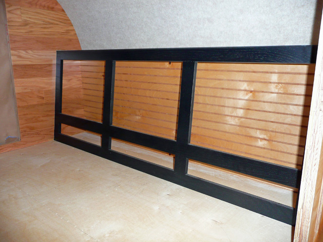

The teardrop cabin is fully enclosed. As you may recall, I used engineered flooring for my wall finish, but had barely enough to finish up the exposed area of the interior bulkhead. So, I used pre-finished birch paneling in the areas that will be hidden by the bulkhead and footboard cabinets.
Next, I completed about three-fourths of the roof insulation. Before the rest of the insulation can be done, wiring for the interior dome light and the Fantastic fan has to be installed.
(The plywood panel at the bottom of the teardrop is where the supply air from the Petcool will go through the wall to two supply grills in the top of the headboard cabinet.)

Looking great Tom! :applause:

Good work, Tom! You've gotten a lot done. It looks like you'll be camping in it this summer! :thumbsup: :applause:

aggie79 wrote:... I finished the construction of a wood chest to house my Petcool on the tongue...
That's one nice looking chest you've got there, Tom. Wait... That didn't sound right... :lol:
