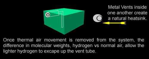

Postby wlivesey » Fri Sep 04, 2009 7:46 am
After a little more research. I don't think I care for the power vent method. A power vent can fail for any number of reasons - that's not good.
I found this page that shows the right way to vent a battery box.
http://www.bdbatteries.com/hydrogenventing.php
This is the WRONG way:
This the the RIGHT way: (I might be able to make this method work)
From the website above: "Several good methods for constructing this vent system exist, we particularly like to see 1/2 inch copper pipes inside 1 inch pipe. Any highly conductive metal pipe will work it will transfer heat quickly. Galvanized, steel, and other pipes that spark when rubbed aren't as great. DO NOT USE THESE IN EARTHQUAKE ZONES. "

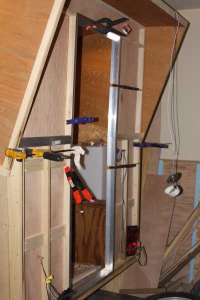

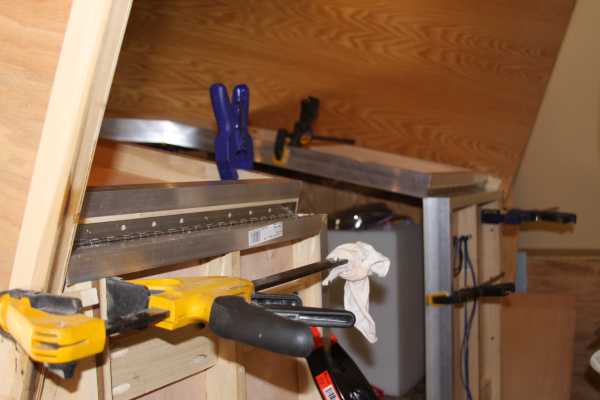

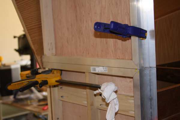

Postby wlivesey » Sat Sep 05, 2009 4:14 pm
I've decided to punt and just put my batteries on the tongue for now. I'll revisit the battery situation after I get a couple of camping trips under by belt.
So, we started on the door trim/framing. I decided to use 1x1/16 aluminum angle for the door casement. It allows the door exterior to be level with the wall.
The door casement also leads into the trim between the upper and lower walls. I plan on leaving the price tag. :)
I bought 36'' stainless steel hinges from Rockler and cut them to length. They were only about $2 more than 18 inch hinges from HD. The HD hinges would have been to short and honestly, I've been less than impressed with the quality of HD hinges. The Rockler hinges are top notch.
I bought some stainless screws from HD to attach the trim, but, now I'm thinking I should use the same screws I will use to attach the exterior aluminum. Any thoughts on what kind of screws I should use?
