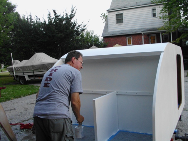

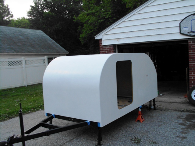

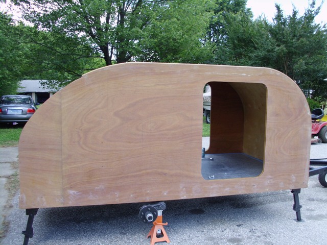

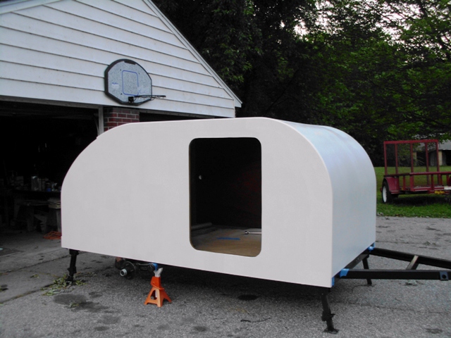

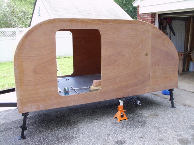

This will be a mini progress report. I haven't really updated in a few weeks, but I have been working on the teardrop regularly. Some things just weren't picture worthy and other days I was too tired when I finished.
Last weekend I spent 3 full days sanding, wiping, filling, fairing, more sanding, more wiping, and do it all over again. Like Paul Arnold, I just didn't think anyone would care to see pictures of me sanding. Three long days of that to get something this dull and homely.
Tonight I put on the second coat of primer.

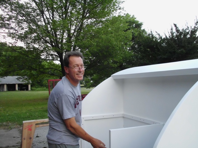

I enjoy painting with a roller, but I'm not that great with a brush. Lance is much better at it and likes to do it so I was happy to have his help.
The imperfections in the hull were more obvious after this second coat of primer. Nothing that I will lose any sleep over, but imperfect nonetheless. I will probably just roll on my paint rather than roll and tip. I'm afraid that tipping it off for that mirror finish will just make the flaws that much more obvious. A tiny bit of texture in the paint (not heavy orange peel, just not mirror smooth) might help to camaflouge a bit.
I have other parts of the build underway also, and I will post them separately over the next few days. I am on vacation this week and if the heat doesn't do me in, I hope to devote most of the week to the teardrop. We have made reservations for our first Tearjerker gathering for the weekend of September 28 so I have put a little bit of pressure on myself by creating a deadline now.
