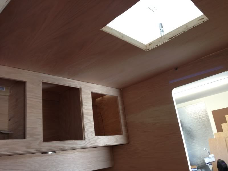

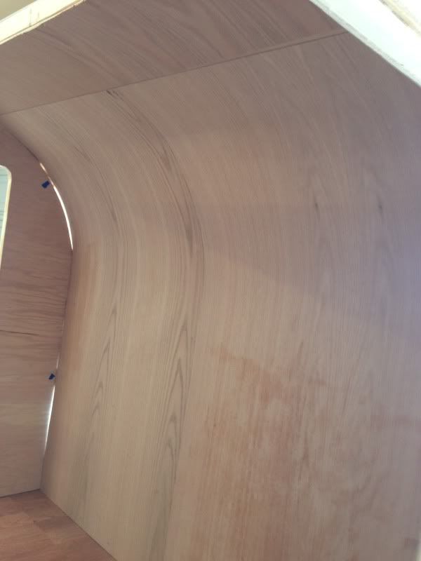

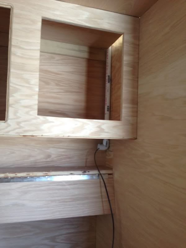

Finished veenering the interior. Not totally happy i had to do this... Just need to finish edgingall the corners, trim pieces and need to clear stain it also.Image
Ran the electrical conduit down the side also

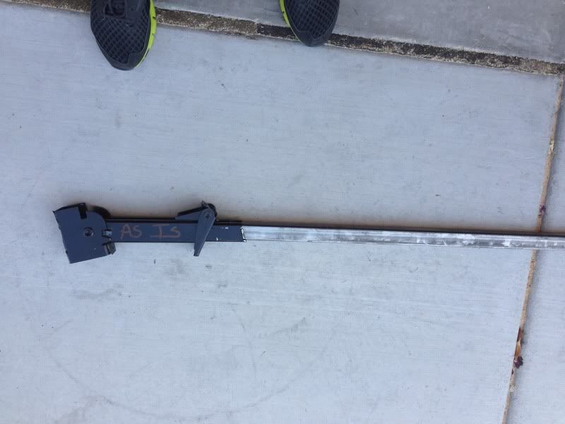

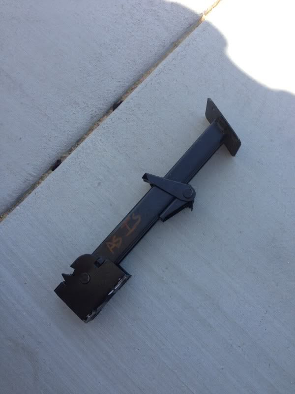

When i was at the trailer store the other day they had a used leveling jack
I really like this simple style just are not long enough. Well for 15 bucks had to pick up and play with it. And bam its 4 feet long lol.
Once the trailer is loaded down i will cut it down to length and make a swivel foot.

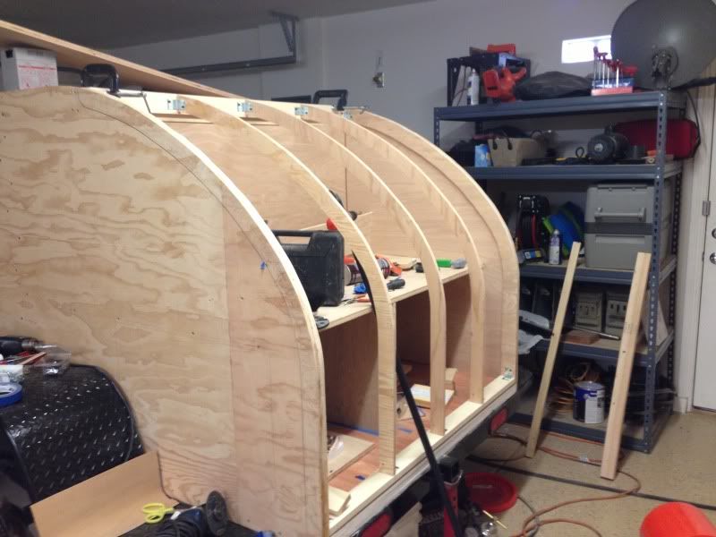

Got the galley walls up
Cut all the middle galley hatch ribs out sanded to match each other.
Soo i will have a total of 5 including the two exterior. The interior are 1/2" and the exterior is 1/2 and 3/4" glued together.
I trimed about a half inch off the 3/4"for a lip that sits down on the interior.
Kind of hard to see the lip. Soo now to start putting the hatch together soon. Also a buddy is giving me some heavier samurai springs to make a bastard pack out off.

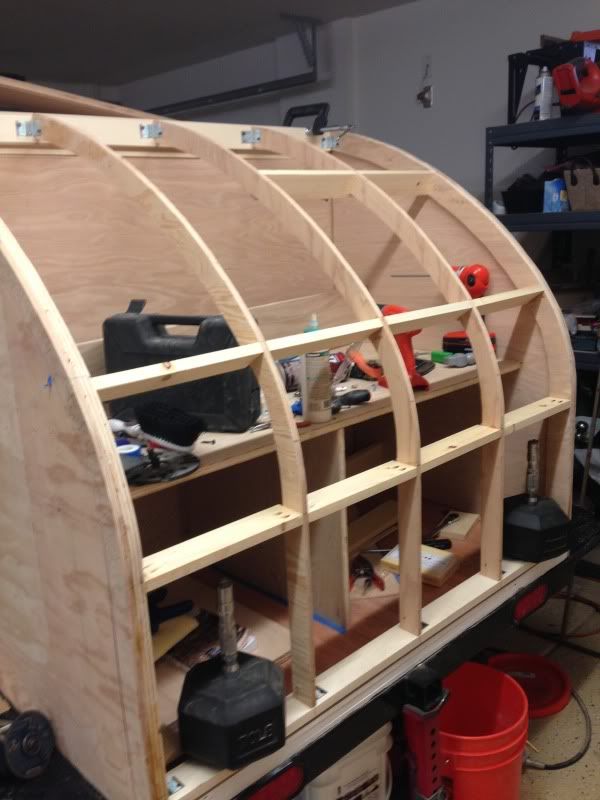

Started mocking the hatch up. Need to get more wood for bracing

So Im on my 6 day finally woohoo!! Been working on the hatch a little. Here is the progress
My wife has one day left of teaching before summer vacation and i will have more time to work on it. Bad news its now over 100 degrees everyday.
