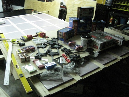

PubUltraStar wrote:Thanks for the information, I think I'll rely on the welds alone. I won't be able to work on the tear this weekend, so I got some wood bent on the template. It's amazing how may clamps I've accumulated for his project. Think you have enough clamps? Nope, you need more clamps.
Here is my template clamp pile. Sadly, this isn't all of them.
Oh my,.....you just discouraged me....guess I will be headed back to Harbor Freight.

I Guess you have so many for forming the wood though?

Yes, mostly for steam bending and clamping those boards. I wouldn't need 90% of these clamps if I wasn't bending.

Parts update
Postby PubUltraStar » Tue Nov 11, 2014 10:54 pm
Although it's getting really cold here in Wisconsin, I've made the commitment to keep work on the teardrop as I can, and have some space in the basement to keep steaming. I've recently got a ton of new parts, most of which I won't need for a long time.
- Porch Lights
- Brake Lights
- Interior Dome Lights
- License Plate Light
- Galley Strip Light
- Galley Accent LIghts
- Marker lights
- Switches
