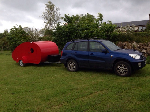

From the outset, I was interested to see if the design was going to match the "thing I built;" of course the proportions of the teardrop match the drawing but I was interested in the proportions to a RAV4.
I'm genuinely delighted. The CAD drawings don't have a wide angle lens (bend) but it's about right.
Thanks again for all your support over the year it has taken to build the TD. This is a particularly positive forum. I've just joined other forums for the Land rover and they tend to be a little more "snippy" and "sneery". I've really liked being able to ask a dumb question or post something without someone having a go. :beer: :beer:

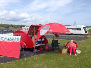

Glorious sunshine in Crail, near St Andrews, Scotland. Raised a few eyebrows en route and have had the first tour on our first day.
Maiden trip and so far so good
We used extending paint roller poles to support the galley lid.

Postby mallymal » Sun Jun 01, 2014 5:32 pm
If there was a prize for colour coordination, you would win first prize! The tear, the umbrella, the chair, the clothing of the person in the chair, et, etc !
Hey great tip with the extendable paint pole... Very lightweight but strong. I shall add that one to my virtual scrapbook :thumbsup:
