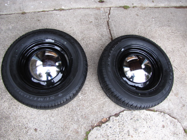

Wheels and Tires arrived today! I think they are going to fit without spacers.

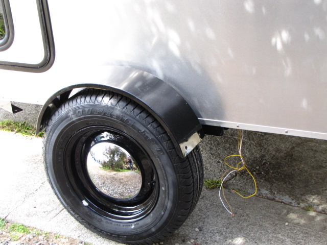

Bought these wheels and tires, there is no clearance!, will likely need spacers. How much spacing do I need? and best place to get them? Will I have to modify the hubs and studs to make this work.

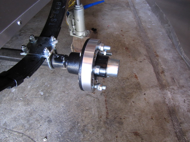

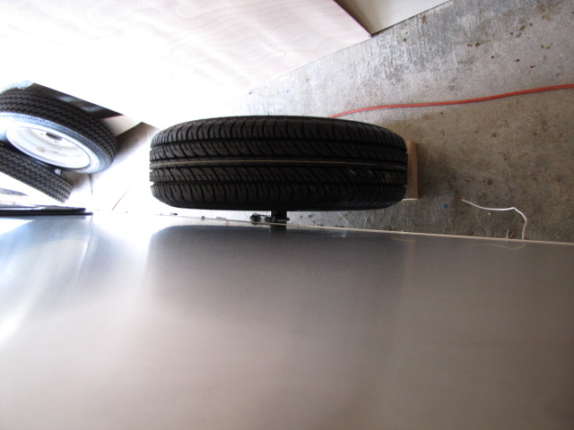

Wheel spacers on, $47 on ebay, free shipping. I had to grind about an 1/8" off the studs but very easy to install. They give me about an 1" of clearance.

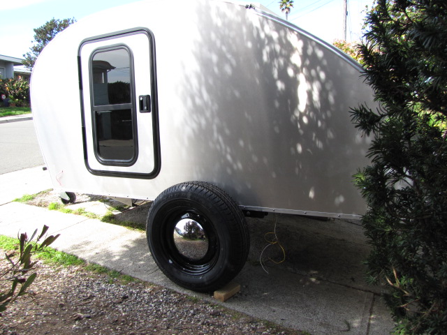

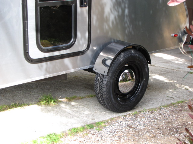

These fenders are not going to cut it! they look too small . . .

Postby dano » Thu Feb 20, 2014 8:53 pm
Hey Drew sorry you don't like the fenders but wow the tires and wheels look good. :D

Postby KCStudly » Thu Feb 20, 2014 9:17 pm
dano wrote:Hey Drew sorry you don't like the fenders but wow the tires and wheels look good. :D
+1. :thumbsup: :thumbsup:
The black paint ties in with the door frame making the manufactured door "work" really well with your profile.
I didn't look back in your thread, but did you make the fenders?
Sometimes it is trial and error to get the look you want. I like the idea of flat top fenders for their usefulness setting things on them in camp, but I really prefer the look of simple round fenders with a formed (radius) lip.
I'm going to have to go thru similar tribulations when I get to that point because the Jeep style fenders I bought aren't really big enough for my tires. They need to be longer lengthwise and shorter in height to look right.
So I feel for you. Keep chugging. What you have there has the makings of something truly great. Simple and clean, but just right, so it is worth seeing it through!
Re: Building the "Heart of Gold" - started!
Postby drewh1 » Fri Feb 21, 2014 12:44 pm
Hi KC - Always appreciate your thoughtful input! The fenders came with the NT Trailer and are made to fit the 12" wheels. So of course, they are small for the wheels and tires. I am definitely going with black. I thought originally that I would go with an off-road look and use the flat top fenders but now am wanting to stay with a more classic look. I am just being "budget conscious" but agree with you. I need to see the design through and not cheap out on fenders but rather get the right ones. I am going to risk driving it around without fenders for a month or so cause I am ready to try it out camping!
