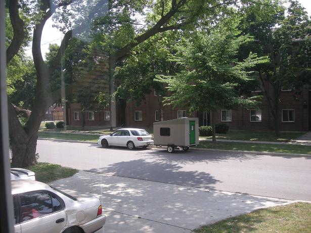

Back from our first road trip with our trailer! We traveled just over 5,000 miles in 16 days, and spent nights in ten different towns and cities as we visited Mark's relatives. Some of his family invited us to use their guest rooms, but I told them, "Thanks, but I'm like a kid with a new toy. I want to sleep in my trailer!" :D
The trailer was perfectly watertight, no leaking anywhere. The first night, however, we discovered that mosquitos could get around the edges of the door! :shock: In the morning we visited a hardware store and bought some weatherstripping, which solved that problem. Then it turned out there was a gap in our commercially made windows, which let them in! I covered that gap with masking tape for the duration of the trip- I will have to think of a more permanent solution. We had no trouble with bugs after that.
Our gas mileage was 18 miles/gallon. I had hoped for better, but perhaps that will improve next spring, when I build that wind deflector in front.

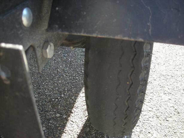

On the trip back, I detected one other problem; the tread is wearing off the tires. I have posted a photo of this. We are trying to figure out why they're wearing out so soon. As you notice, the inner side of the tire is wearing off first. Any suggestions? :thinking:

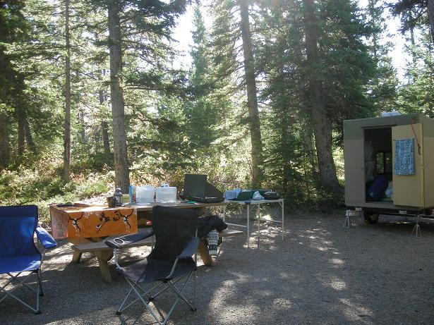

Postby Shar » Fri Oct 10, 2014 11:25 pm
We just got back from a camping trip, the last weekend of the season here in Alberta. The temperatures went down to 5 degrees above freezing at night, but were mild during the day. We kept warm at night with piles of duvets on top of us! The insulated floor of our trailer seems to have worked well; we didn't feel any cold from that direction. Next year I might bring a small heater with us, if we stay at campsites with electricity. Let the adventures begin!

Postby noseoil » Sun Oct 12, 2014 10:27 pm
How many miles did it take to wear down the tires like that? There are several possibilities. The inner edge is "scuffing" on the pavement, so I would check a couple of things.
First, alignment. When the axle was set, did you measure from the tongue to the center of the axle on both sides? The axle needs to perfectly straight with respect to the tongue, both wheels need to be the same distance from the front point of the tongue to the center line of the axle.
Second, Alignment. Park on a perfectly flat surface (concrete apron which looks very flat). Use a framing square to see if the wheels (tires) are perpendicular to the pavement. They should be straight up and down (no gaps at the top compared to the bottom), when the trailer is in the towed position behind the car and loaded like it is for a regular trip.
Third, tire pressure. Check the load rating of the tire. It will say something like 800# at 60 PSI (just an example, read the sidewall!). Figure out your rolling weight and see how it matches up with the combined total of the tire capacity. If the capacity of the tires is 1600# at 60 PSI and you are rolling with 900#, try dropping the pressure a bit (a little, not a lot). Normally, over-inflated tires will wear in the center. Under-inflated tires will wear on the outside edges.
Please let us know what you find about the tire wear, I'm sure others would like to know the results.
Hopefully, someone else with more experience will add to this post and provide better information and perhaps a solution. You could also do a bit of research on the web to see what's out there about uneven tire wear on trailers.

Postby Shar » Wed Oct 15, 2014 4:01 pm
Thanks for the feedback, noseoil. The tire wear was after a single trip of slightly over 5,000 miles. Everything was brand new at the start, so clearly something is not right.
When we assembled the trailer frame, we did check it for square, but not in relation to the axle/tongue; we just checked the four corners of the frame itself. I called the trailer company that made it, and they suggested checking to see if there was too much play in the bearings, as well as the ideas you suggested. I will admit that it's been such a busy summer that we haven't checked for any of those things yet. :lol:
I wonder if it's already time to pack the bearings again, since we took such a long trip. :thinking:
