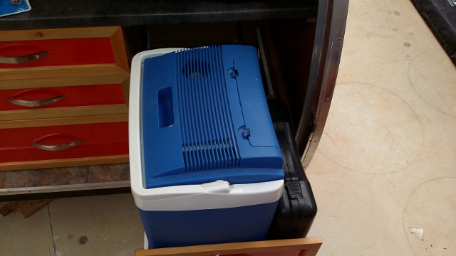

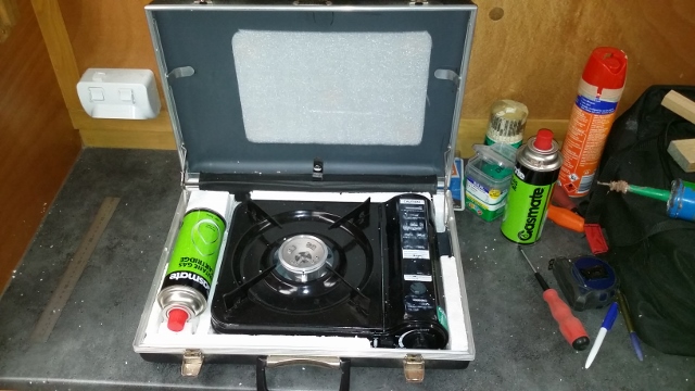

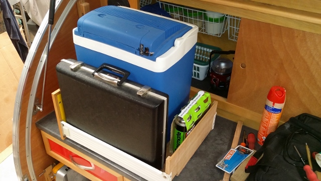

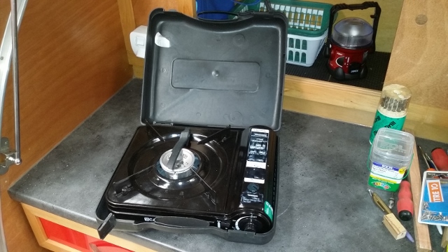

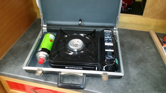

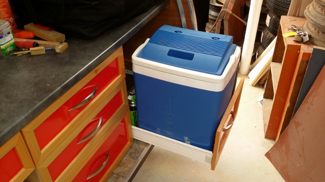

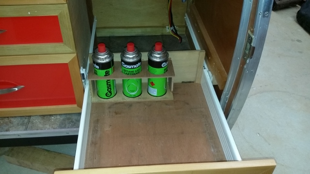

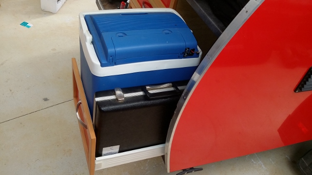

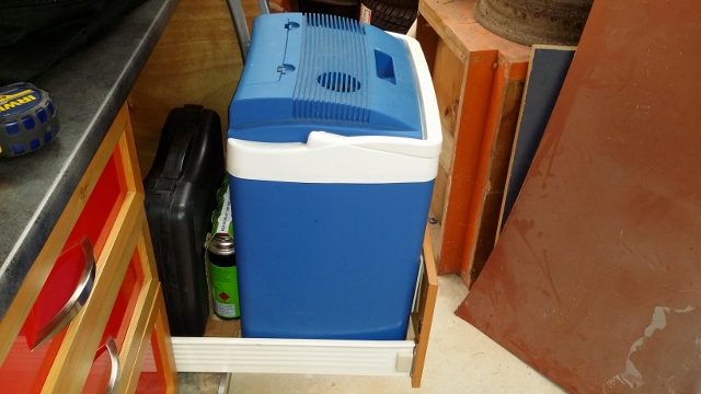

Today I got to re-organising the chiller drawer.
A while ago I had fitted a longer drawer unit that I had, and now found that I am able to turn the chiller around sideways and have room to fit the little gas cooker, in its case, beside the it and not around the back where it was rather awkward to get at.
The light plastic case it was in was falling apart and every time I picked it up today another piece would fall off.
I thought I would have to make a wooden box for it, then remembered a couple of brief cases that I no longer used and wondered if one of them would do the trick.
I found them in the back corner of the shed and one of them was perfect for the job. It is a strong molded plastic case with rounded corners, fits the space perfectly and holds the cooker and one of the canisters. It will also be good to take in the car for making cuppers when on car club runs.
I fitted and glued polystyrene around it so things wont rattle around.
I was also left with a space behind the chiller to put in a rack to hold the spare gas canisters, instead of having them floating around in their cardboard packaging.

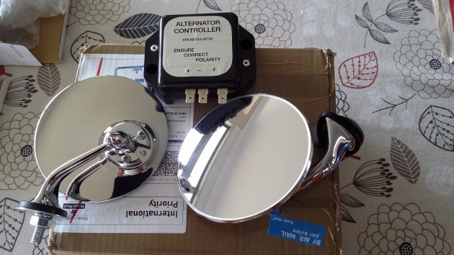

I called in to the post office today and yah a parcel had arrived from England for me. :D
I had ordered a new set of door mirrors and a voltage regulator for my '67 Humber Super Snipe a week ago and they are here already. :applause:

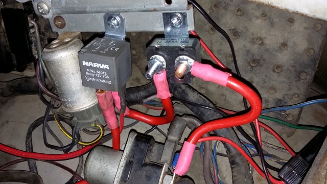

For our next trip we decided it was time to get the Humber Super Snipe out of hibernation. The old girl hasn't been on the road for a couple of years. We took her in and got a Warrant Of Fitness a couple of weeks back, then came home and made a list of all the other jobs that needed looking at. Nothing major, but a few of them are things I have been wanting to do for quite some time. First was to run wiring to charge the TD battery as we travel.
2015-03-26 08.27.59 (640x360).jpg (193.94 KiB) Viewed 3597 times
As with the others, I ran an 8awg wire from the battery to a 50 amp auto reset circuit breaker, then a 70 amp relay, (to shut the power off when the engine is stopped) then to the back of the car to a 50amp Anderson connector.

After testing all the other components in the Super Snipe charging system and finding they were doing what they were supposed to do, I connected the new voltage regulator that I had got from England. $>
2015-03-24 15.19.30 (640x360).jpg (183.97 KiB) Viewed 3556 times
I started it up and all looked good, then :EXP :x :EXP it started doing it all over again. The problem it has is, the ammeter needle flicking wildly from charge to discharge. It will go half to full scale about four times a second. :? The car is 1967 and my dad bought it in 1970. and it has been doing this for a long time. He had it looked at years ago with little success. $> I kept the car after his death, in 1992, and in 2007 had the auto sparkies look at again. $> It was ok for about the first 100 miles, then back to its old tricks. This time I decided to sort it myself :thinking: but again had hit a brick wall. So then it was ask uncle GOOGLE. :roll: :thinking: :roll:
I found a site with some guys having similar problems with Rover 3500s, which use all the same components, and then Jaguar E Type owners the same. One of them had described the exact same symptoms I was having. He had replaced his alternator, $> regulator, $> field solenoid, $> warning light controller, $> and ammeter, $> that's it the complete system, there is nothing else to replace :Oh Brother:
Then on google I found a memo that had been sent from Rootes Group (Humber who made the Super Snipe were part of the Rootes Group) to their service agents in 1968, more or less saying that this is normal, :x but making a few suggestions how to improve it. All the things I had already done. :EXP :EXP :EXP :roll:
