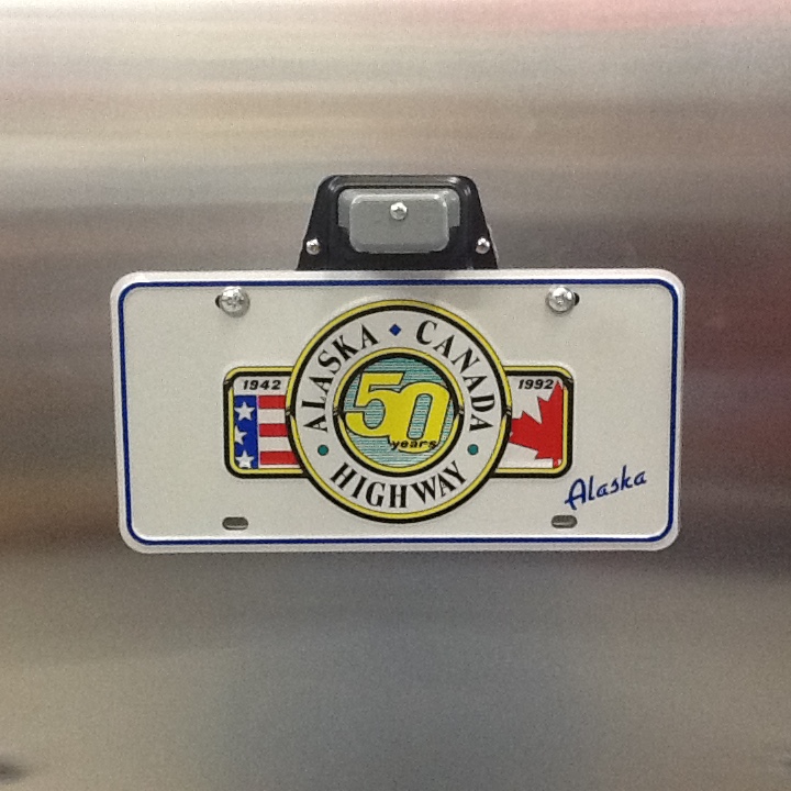

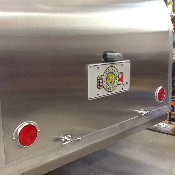

Alaskan Benroy
Postby ratrod71 » Thu May 05, 2016 8:57 pm
Just a cool picture. These were license plates that were sold as mementos for the 50th anniversary of the Alcan Highway.

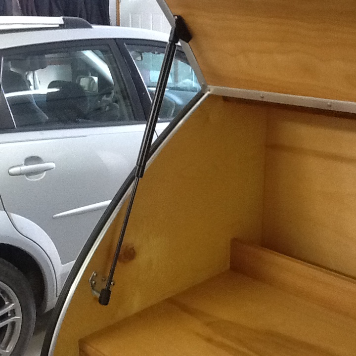

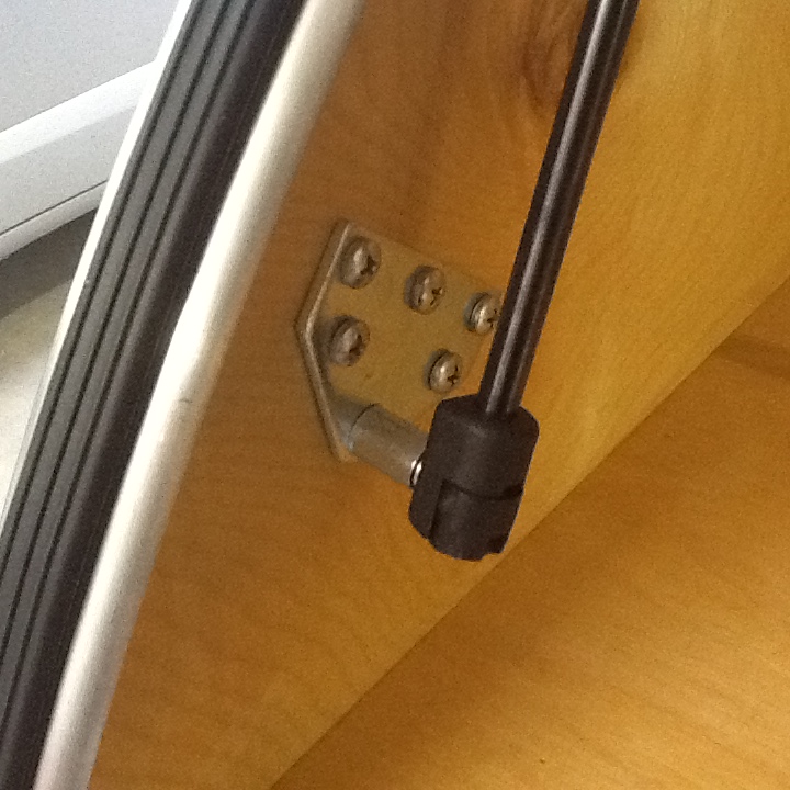

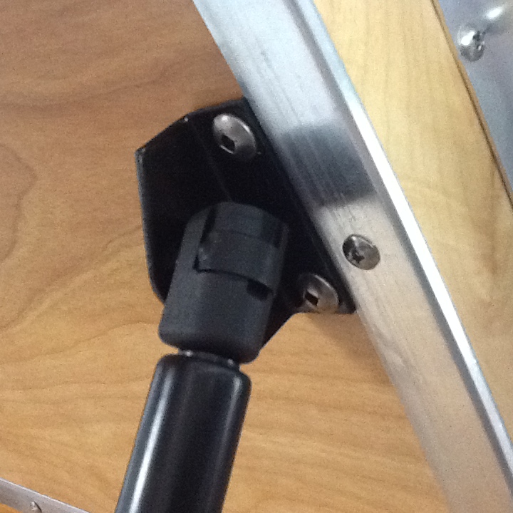

Postby ratrod71 » Sat May 07, 2016 5:10 pm
Installed the hatch struts finally. Another item checked off the final to-do list. I used 20" struts rated at 100 lbs. Distance from hinge pivot point to upper ball mount is 7.25". I used the hatch strut calculator on this website and it worked perfect. Wahoo! Bryan

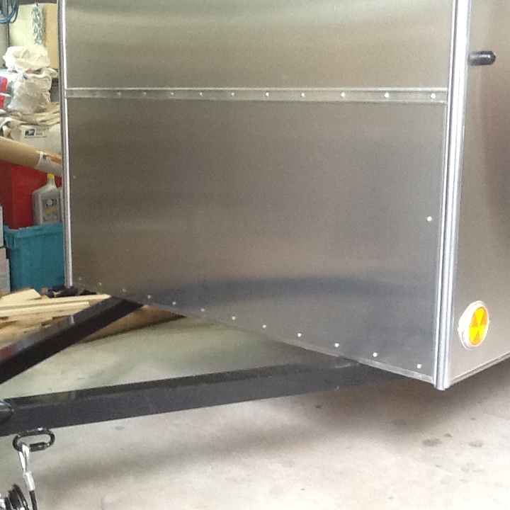

Postby ratrod71 » Sat May 07, 2016 8:18 pm

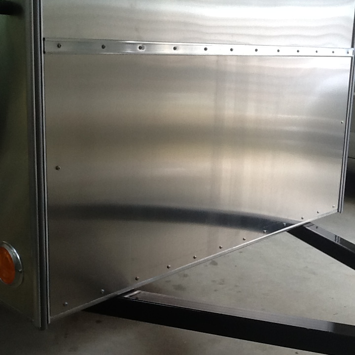

Also installed the front rock guard today. It is .090" mill finish aluminum. Lots of gravel roads in Alaska, hopefully this sacrificial piece will keep it looking good longer.
Alaskan Benroy build journal: viewtopic.php?f=50&t=61738

Postby hartk1213 » Sun May 08, 2016 12:20 am
Awesome looking great man..your TD is exactly what I hope to have mine look like it's great only thing I wanna do differently is i want my rock guard to be diamon plate other than that pretty much the same yours is beautiful and has been wonderfully built great job !

Postby ratrod71 » Sun May 08, 2016 12:39 am
hartk1213 wrote:Awesome looking great man..your TD is exactly what I hope to have mine look like it's great only thing I wanna do differently is i want my rock guard to be diamon plate other than that pretty much the same yours is beautiful and has been wonderfully built great job !
Sent from my Galaxy Note 5 using Tapatalk
Thank you for your kind praise. I think the diamond plate will look great. I am sure your teardrop will turn out super! Keep up the good work. Bryan
