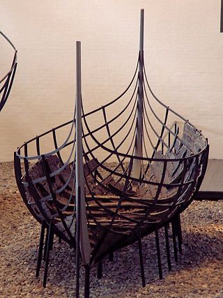

McGuffin wrote:Hi Dave,
That's a real work of art. It is a pity in a way to cover up all that lattice of steel so beautifully wrought!
Where is the original one that you are replicating and where was it built?Larry
thank you so much ! definitely more art than science here---- the missus has always maintained it's like a viking build. a very cool photograph.

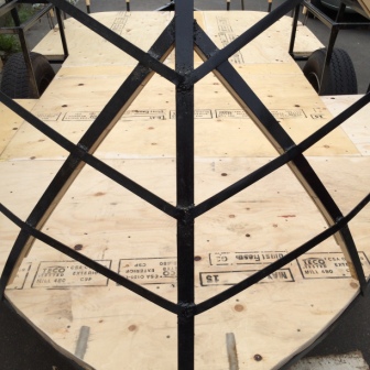

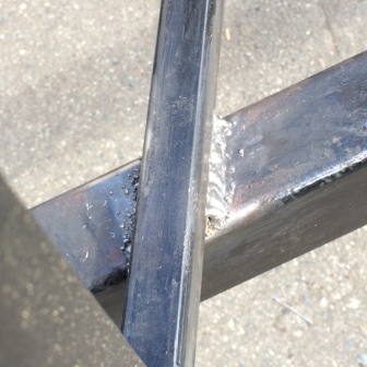

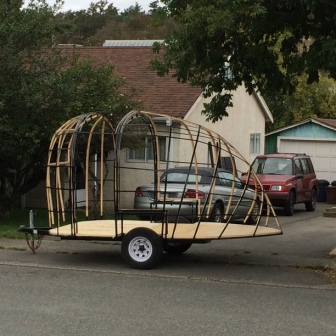

well, i welded the cage to the base today. i chose 10 contact points and had at'er. also templated the front floor section, and cut the plywood. tomorrow it will be installed along with the rest of the floor
cage welded to base.JPG (50.83 KiB) Viewed 1995 times

Postby dave campbell » Tue Sep 15, 2015 3:51 pm
update for today--- floor is in !!
bottom layer is 1/2 factory grade, exterior ply and the top layer is sanded 5/8 exterior ply. next i will be making paper templates for the door jambs, and using 1/2 ply scraps doubled up to fill the voids in the two bulkheads.
thought of a decent name for this unit------ Mahi-Mahi :beer:

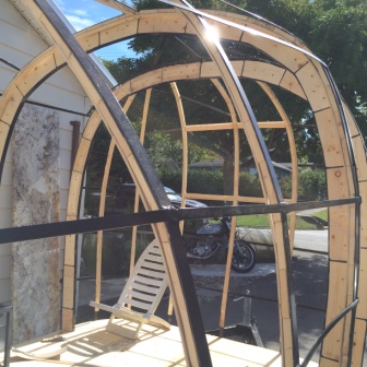

like a mahi-mahi.JPG (63.38 KiB) Viewed 1914 times
the cage.JPG (61.39 KiB) Viewed 1914 times

:thumbsup: Great! Did you use bunch of self-tapping screws to fix the plywood to steel?
OP827
Posts: 1596
Images: 414
Re: go ahead, call me crazy !
Postby dave campbell » Tue Sep 15, 2015 7:23 pm
KCStudly wrote:Looks great! Keep plugging along. :thumbsup:
thanks !! 'plugging' is fast becoming shambling which then leads to straight up knuckle dragging-- i understand.
OP827 wrote::thumbsup: Great! Did you use bunch of self-tapping screws to fix the plywood to steel?
yes i used self tapping screws (#10 X 1) and PL premium on all the beams, but quite honestly about 7% of the screws were bunk. i pre-drilled holes to make it easier as they just wouldn't grab. even then many tips broke off in the hole, which then i had to re-drill. over about 120 screws---4 lost their tops. i used a regular 18V drill, and not an impact driver to reduce screw damage. the second layer of ply is held on with superglue and deck screws at about 7" intervals, except in the doorway where they are closer to 4" apart---and the seams between the layers are all staggered. floor thickness is 1 and 1/8"

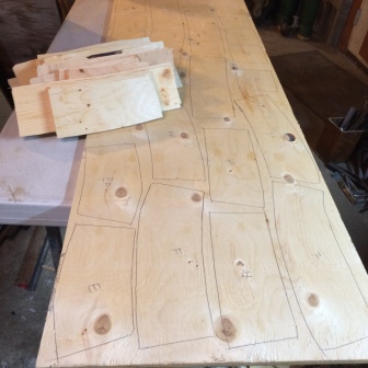

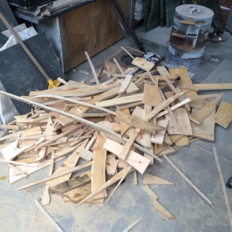

after making ram-board templates, i whipped up 18 chunks of 1/2"ply to be doubled up in the bulkhead. that got me 1/4 of the way through this phase
bulk bits.JPG (44.19 KiB) Viewed 1888 times
some peanut-butter---
bulk bits3.JPG (51.09 KiB) Viewed 1888 times
and voila !

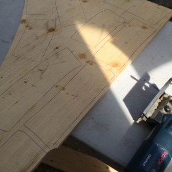

i'm not one to take a selfie but i couldn't resist today ;)
currently typing with my hand in a "c" shape from holding the jig saw for so long

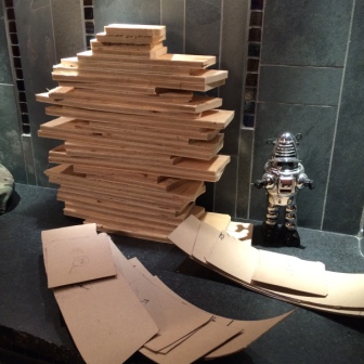

today was a slog !~it doesn't look like much but a LOT of time went into the bulkhead bulkout program.
first i completed the core----templating with ram board---transferring and cutting----re-marking and belt sanding to tweek the fit. X 72 different pieces.
from the factory they would have been 72 same pieces, but i'm not a factory---just a machine 8)
bulkhead core complete.JPG (67.37 KiB) Viewed 1819 times

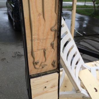

after the core, then the 5/8 wrap to both sides, for a thickness of 2 and 1/4". the door will be well hung
bulkhead bulkout.JPG (44.23 KiB) Viewed 1819 times
meep-morp :beer:

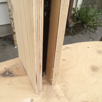

here's view of the jamb from the outside. plywood all the way through
bulkhead view from outside.JPG (28.69 KiB) Viewed 1819 times

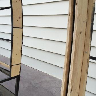

here's a shot showing the two sides of the door, and to the right of the jamb is the backing for the wall up front
door jamb morph.JPG (18.1 KiB) Viewed 1849 times

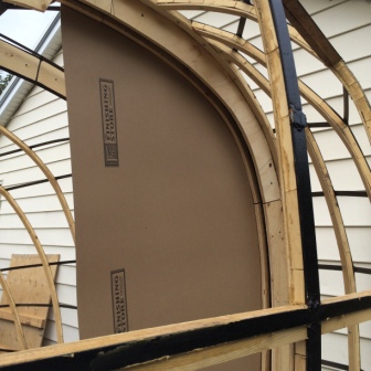

once i had one side flowing to my satisfaction (used the old eyeball, a pen, then jigsaw followed by 4"grinder with 40 grit sanding pad)
then i made a template, flipped it around to the other side, and copied
bulkhead template.JPG (53.74 KiB) Viewed 1849 times
