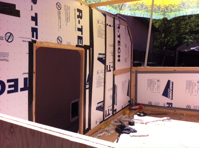

After a couple of weeks hiatus i went back to work.
I completed the wall insulation. I used 3/4 inch hard foam board and secured it in place with 3m extreme hold duct tape which is designed to maintain hold in high temps. The foam board came in 4x8 so I had to cut to fit, and tried to make it very snug, so i went just above the measurements for each space by about 1/8 inch all around. the foam board felt like it would hold without the tape.

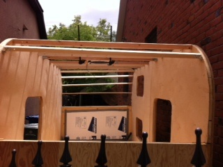

Today i was able to attach the inner sidewalls. They are 3mm Baltic birch. I glued and screwed them in. I used #4 1/2 inch brass screws for aesthetic purposes. The roof spars will be attached through them. The various cutting to fit has left some jagged edges that I will sand. I am not sure if I will paint or lacquer. It will depend on howuch there is to cover at the end :)

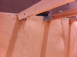

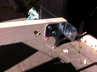

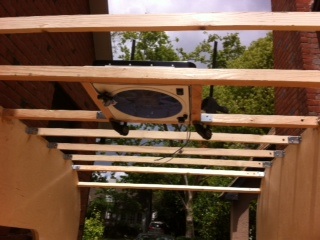

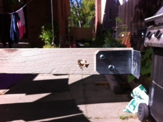

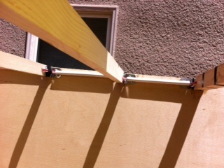

I cut and prepped the spars for install and measured out their placement. There are 14 1x2s and 2 2x2s for the vent fan. They will be placed at 14 inches from end for the 2x2s, 11 inches on center along the sidewall straight aways, and 8 inches on center along the curve. Each spar is cut to 57". I drilled a pass through hole in the spars that go from the vent fan (at the center of the camper) up to the bulkhead wall for the electrical wiring. there are a few different approaches to spar installation on the site, but I decided to go with joining the spars to the sidewalls using glue and an l shaped construction tie so that I can screw into the side of the spars rather than the end grain, and then into the walls. The temp spars I installed by screwing from the outside wall through into the end grain and it was very weak.

Postby mariannf » Sat May 21, 2016 4:37 pm
Today I did the spar installation, see my previous post with details about the spars and spacing. I installed all but two. I am thinkin of putting in one more window at the front bulkhead. I am thinking about getting a window that can open enough to use a small window air conditioner. I have seen many of the discussions about air conditioners and having a window that could accommodate a small one seems possible. What do you think?

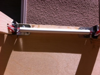

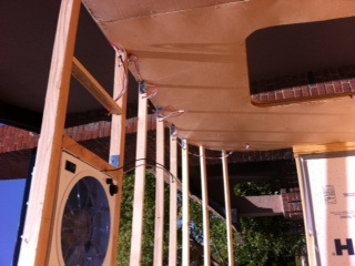

Postby mariannf » Fri May 27, 2016 4:00 pm
I started wiring today. I am using 14awg from the fuse box to each load. I decided on red wire for positive and white for negative. This just made sense to me. My four loads have different + - color combos so it wouldn't have been consistent to go with any particular combo. I had predrilled pass through holes in the spars, and passed the wires for two of the loads (fan and cabin light) through them. Then I cut section of a store bought plastic wire channel with adhesive back to fit between the spars. The channel is made with an opening running through its length to insert wire. Section by section I inserted the wires and then at the corners of the spars and wall frames taped them up. See pics. I will add two more loads, reading lights and the dual USB charger once I install a cabin shelf toward the end of the build. The fuse box will also be secured to the shelf and then only two wires an negative and positive to the battery will be channeled out through the floor.
