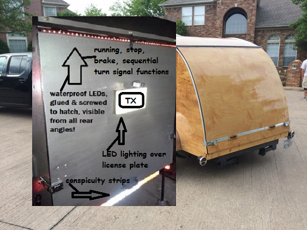

Postby working on it » Wed Jun 07, 2017 8:21 pm
Nobes wrote:...At lunch the eagle-eyed (not to mention lovely and gracious) Mrs. Nobes noticed a tiny insignificant problem with the license plate.
147918
Well that's no good. I began thinking of all sorts of ways to fix this, while on the road, with no tools or materials. Finally I realized a couple fender washers would do the trick, and hey look there's a Tractor Supply right here in Pryor, OK. Bought a washer, went outside. Then realized I didn't even have pliers, much less wrenches, so I went back in & bought a pair of pliers. Then as I began to make the repair I realized I needed a smaller washer because the bolt in the plate went right through the center of the fender washer. So a third trip back into the store--I got another fender washer for the other side, plus the two smaller washers. Back outside putting the washers on two different guys had to stop and talk, ask questions, get the tour, and so on. Anyway a 5-minute fix took 45 minutes. But we're on vacation right, so who cares? I should have a pic of the repair job but I just forgot....
  • I formerly had my license plate mounted under the left rear light on my car hauler (the -standard, inexpensive-lighting kits ALL come with a bracket to mount the plate under the clear lens on the left side light), and had to repair it repeatedly, due to dragging it over bumps and other road hazards. My friends had the same problems with theirs, and most just bolted their plates to the left fender, whether they had lighting there, or not. I chose to bolt my license plate to the underside of my left ramp, which rode elevated (almost straight up) behind my race car, and I furnished LED lighting for it, too.
  • Just before I started using my TTT, I had the plate hanging under the left rear light (again), and had it get damaged after only three trips (100 miles), before the interior build was started. So, I made a license plate frame, bolted it to the center of my rear hatch, and used three separate LED lights for illumination. Later on, knowing that my lighting was meager, at best, I added conspicuity strips all along the frame rear edge, between two red running lights. Still not satisfied with the visibility of my lighting, I added a "line-of-fire" continuous LED lighting strip, just below the top edge of my hatch (at 67" off the ground; up to 72" is legal in Texas), for very visible running, stop, and sequential turn signals. I added vertical reflective strips much later, after my trailer was nearly hit while temporarily parked outside my home.
  • After all the work we have done, creating our trailers, I feel that visibility (over-stated in my case) is needed due to the careless drivers out there; a high-mounted license plate, well-lit, is just a good beginning to achieve that end.
    POSSIBLE LIGHTING AND LICENSE PLATE CHANGES.png (651.19 KiB) Viewed 3679 times
    lights and reflectors everywhere!
