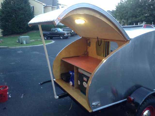

tony.latham wrote:Your hatch looks superb. Six-bits says it's dust free.
Thanks Tony. :beer:
I still have to stick some weatherstrip in the hatch groove, but, yeah, I don't see how anything can get in through there. I just hope it's spider proof. :frightened:

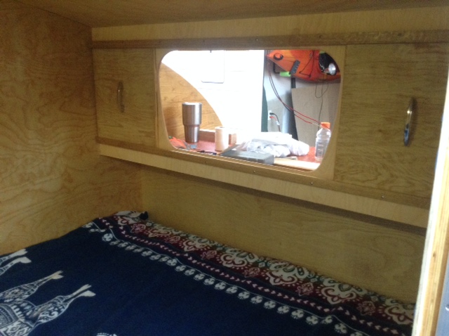

Over the past couple of days....Cleaned up the trailer/battery wiring, and wired the hatch light fixture. Installed the mattress and furnishings. Wired the main battery disconnect and primary fuse in the tongue box.
Galley 1
Galley 2
Cabin aft

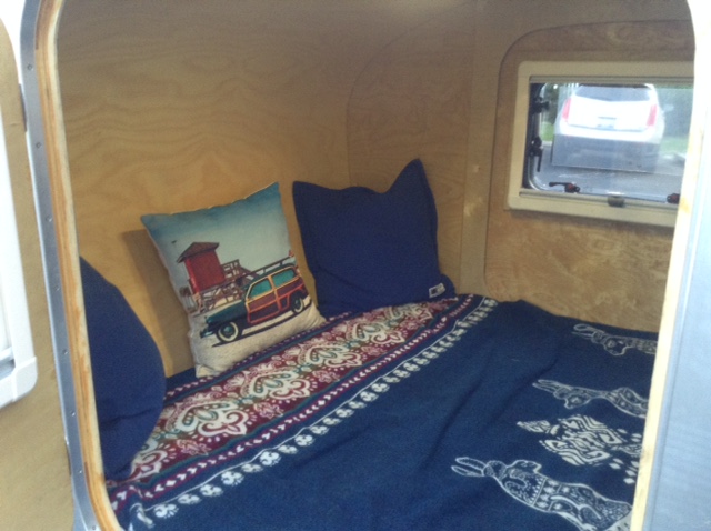

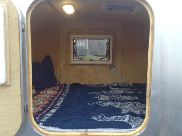

Cabin side view
Cabin forward

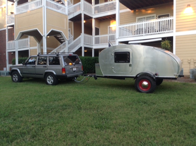

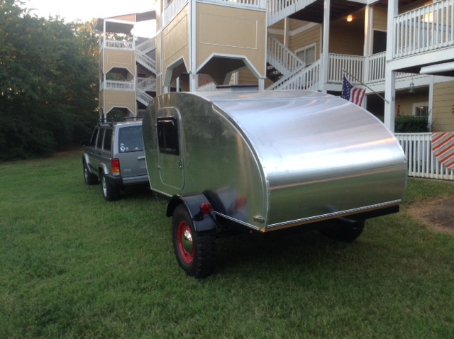

Postby kokomoto » Sat Aug 05, 2017 7:13 pm
Near campable.
1
2
3
