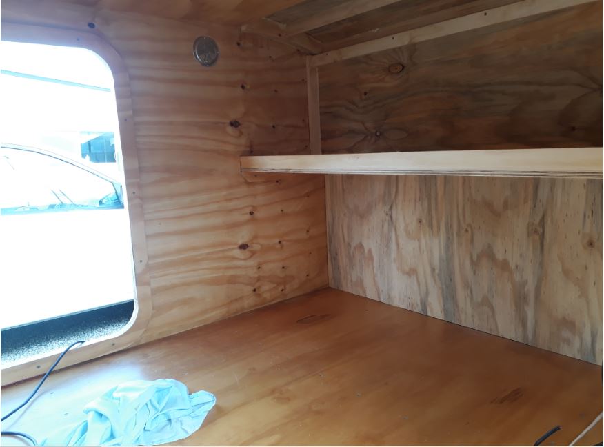

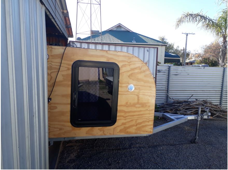

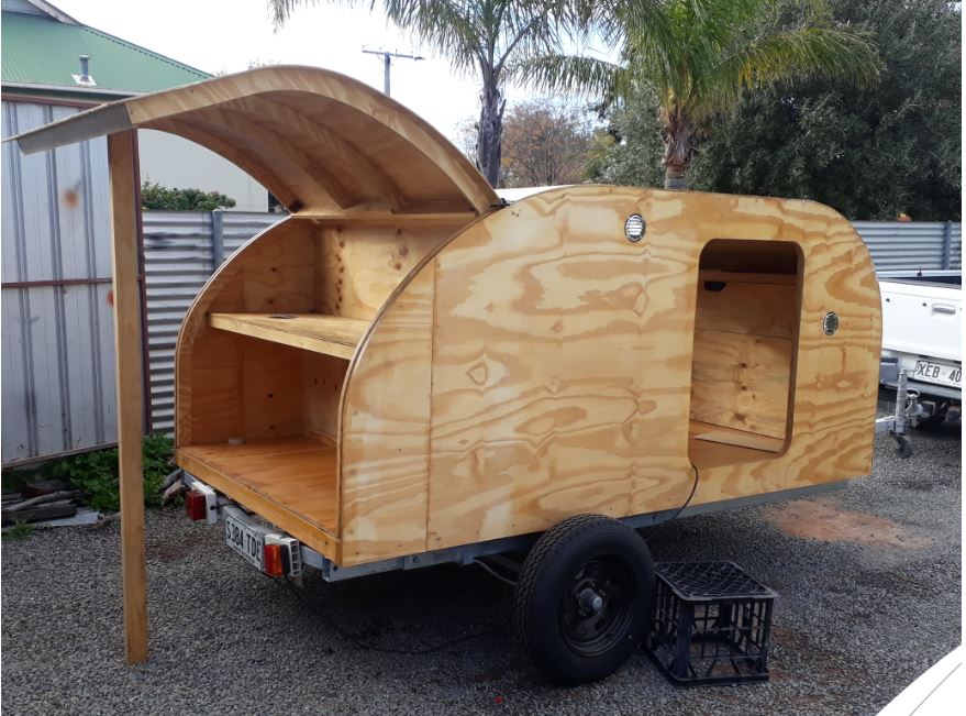

Postby MickinOz » Sat Jun 20, 2020 12:02 am
Woke this morning to find the missus in good spirits and, even better, not requiring a trip to the A & E department after yesterday's bad fall in the kitchen.
So I devoted the middle of the day to fitting the hatch.
Is it perfect? No.
Am I happy with it? Heck, yes!
Hatch closed quarter view.JPG (99.65 KiB) Viewed 4259 times
Hatch open.JPG (118.84 KiB) Viewed 4259 times
Interior aft stbd side.JPG (59.64 KiB) Viewed 4259 times

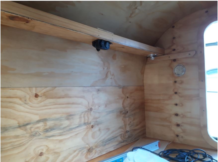

Postby MickinOz » Sat Jun 20, 2020 12:13 am
Interior has the forward shelf/tray in place.
Note I got my little butterfly vents. Cutting the holes for them saw me feeling almost religious.
If I believed in prayer, I may have offered one as the hole cutter hit the plywood
Interior fwd stbd side.JPG (56.25 KiB) Viewed 4256 times

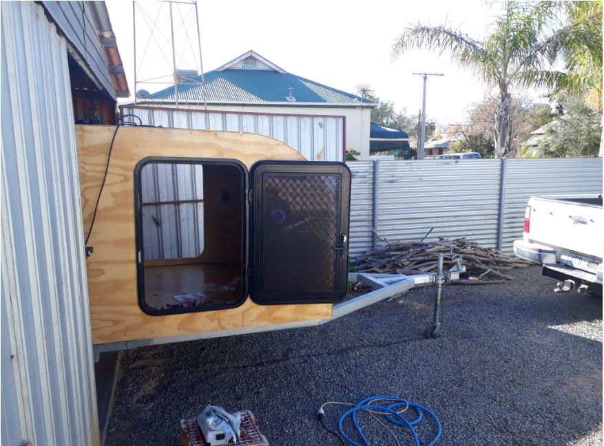

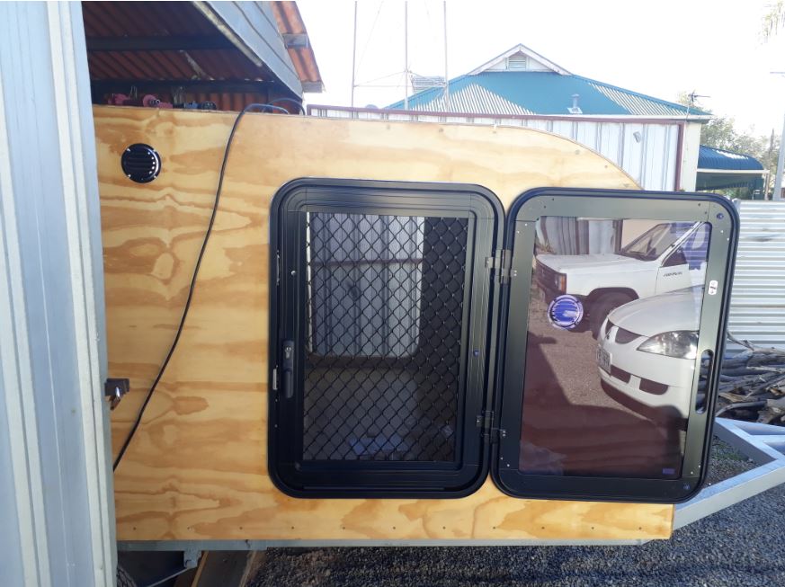

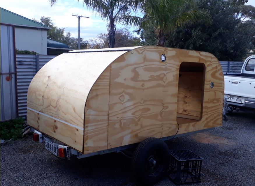

Postby MickinOz » Sun Jun 28, 2020 1:46 am
The day saw advances Trixie
RHS door 28.6.2020.JPG (102.93 KiB) Viewed 4109 times
RHS door screen closed glass door open 28.6.2020.JPG (96.6 KiB) Viewed 4109 times
RHS door both open 28.6.2020.JPG (125.63 KiB) Viewed 4109 times
MickinOz

Postby MickinOz » Sun Jul 05, 2020 4:24 am
This weekend saw the other door go in. I now have the sleeping compartment at lockable stage.
I wasn't super impressed with these doors when I got them.
I guess I expected that for $1360 they should have been a little more robust, dimensionally accurate, solid, somehow.
However, all is forgiven now they are fitted. They no longer seem flimsy.
Once the frame is shimmed straight in the opening and glued and screwed in place, things work very well.
Suddenly the doors latch properly and pull in against the seals.
I find if all the vents are closed, there is a little bit of resistance to opening until the seals let go.
And they shut with a nice satisfying little thump like a good car.
Progress is slow but steady.
I also clamped the boot lid shut and ran the trimmer bit in the router up both sides, so the skin now lines up exactly with the sides.
Still waiting for the stainless steel latches I ordered.

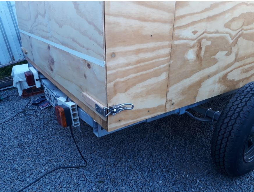

But I managed to fit the latches for the boot lid.
Temporary screws - have ordered one-way security screws.
Won't stop a real crook of course, but the casual opportunist should be deterred

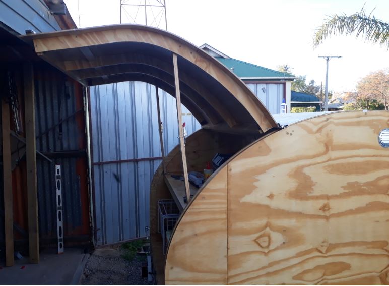

Postby MickinOz » Sun Aug 02, 2020 3:40 am
Was finally able to get back to the TD.
Had a go at making my own mudguards. Not pleased with the result - back to the drawing board.
Now, I went through high school rocking A's and B's in Maths, Physics and Chemistry.
I ain't no Triggernometry Tenderfoot. (Apologies to the late Louis L'Amour http://www.louislamour.com/audio/thattrigger.htm )

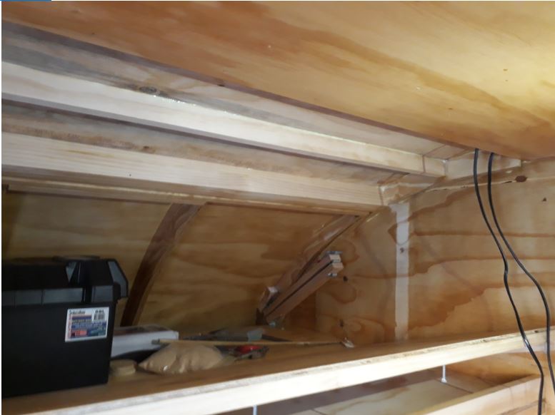

But, I still couldn't come up with gas strut geometry that works with my profile, bench position and hatch layout without undue stress on my hinge.
So I built these.
Hinged manual struts.
I hope the pictures tell the story.
We'll be here all night if I have to write it.
I didn't use glue when I installed the top bulkhead panel, in case I needed to get at something. Glad I did.
attachment=0]hatch open new struts.JPG[/attachment]
hatch open new struts.JPG (66.97 KiB) Viewed 3907 times
strut left closed.JPG (52.2 KiB) Viewed 3907 times
right strut half closed.JPG (41.52 KiB) Viewed 3903 times
MickinOz
