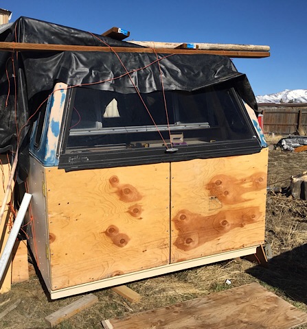

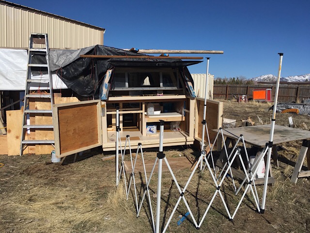

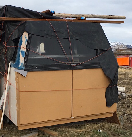

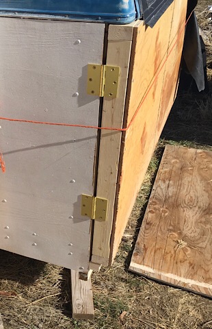

Good progress today. I’m worn out. The permanent rear doors are built and installed.
Here shown open. There will be a shelf on the left door, at the bottom, for the cooler. I found teflon glides to go under that shelf and slide on the floor as the door opens and closes. Both doors sit on a 2x2 when closed for extra support. The stove goes on the right door, on a shelf that will slip OVER the countertop.
I have to laugh at myself... I can’t install the countertop now. I have to remove that vertical support in the center of the galley first. That won’t happen until the rest of the insulation and paneling are in place.
I used ordinary door hinges and left enough space for a good seal. I may add a third hinge if necessary, and a support leg, mainly to keep the doors from swinging in the breeze. The rear of the trailer is close to the ground because I have the tongue HIGH to allow melting snow to run off (windows still need to be sealed) and the left tire is flat.
Doors and hatch closed. The hatch overlaps the doors for security, just like it would on a pickup. Fits perfectly. I am amazed.
Tomorrow, the first coat of exterior paint will go on the doors.
Note: you can see the tan paint on the rear edge of the shelf and the rear part of the floor. I like it a lot.

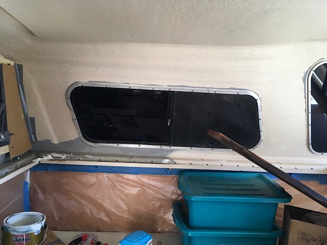

A little progress today. I got the original front window out and temporarily installed the awning window in the front. I also figured out how to fill the remaining space from the old window (with fiberglass) and how to support it while the fiberglass hardens.

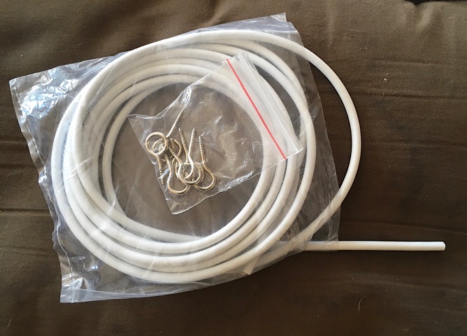

Anyway, I got some stuff that I think will be great for the curtain hanging system too. It is a coil spring with little hooks that screw into the ends. Looks like clothes line. The plan is to have wood above and below the windows to screw the hooks into.
The idea is to string a strand of this above and one below the windows with the curtains pocketed top and bottom so they slide open or closed. The stuff is commonly available in Europe, and is bare, no covering on the spring. I finally found some here, on Amazon I think. But the coating makes it ‘not stretchy’. I plan to strip the coating a bit to allow some ‘spring’ tension.

Postby edgeau » Wed Mar 04, 2020 3:39 pm
That stuff works. My Mum used it a lot back in the 70s

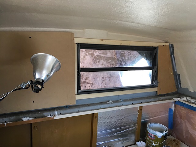

OK, pics. The first one is of the front window. I removed the existing topper window and installed the awning window by framing the entire window opening with 1x2 lumber. This will give me a good attachment point for hooks and hangers as well as reinforce the width of the ‘hole’ left from the window. The left and right sides are temporarily covered. They will get a piece of fiberglass (salvaged from an old camper shower surround) that will be fiberglassed into the openings (cut to fit of course). I’ll be using this same method to the left and right of the door opening.
The wood frame also gives me a good spot to attach the curtain ‘springs’. The space to the left of the window, between it and the door casing will become a ‘closet’ and I would like to make a corner cabinet on the right side.
I also decided to add a 1x2 to the top and bottom of the side window. It will go from the rear vertical window to the slanted bump in front of it, top and bottom. Again, a place for the curtains and a place for hooks and such.

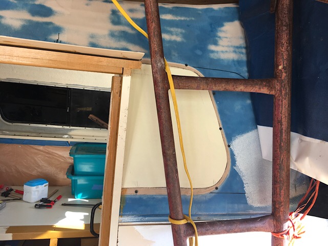

This is how the fiberglass will be fitted. I plan to cut and fit a piece for each of the 4 ‘holes’ left from removing curved windows and installing a rectangular door and window. I want to get all 4 pieces cut and fitted so I can take the trailer out of the shelter I built. I need to do that for access to them. But, I will need a week or so of good weather before I can do that.
Anyway, here is the first piece fitted to the hole. The shower fiberglass seems perfect. The inside is quite similar to the existing interior of the topper and the outside will be sanded and roughed up so it will hold paint.
I had made a pattern for that piece, but I’ve since realized that the windows I removed are perfect patterns... I’ll use those to lay out the remaining 3 pieces.
