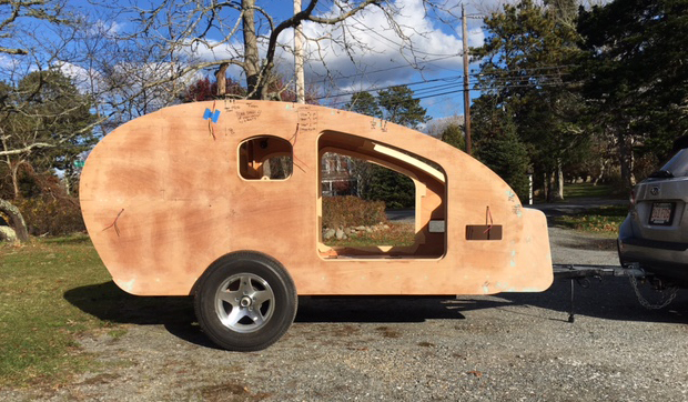

11.25.21

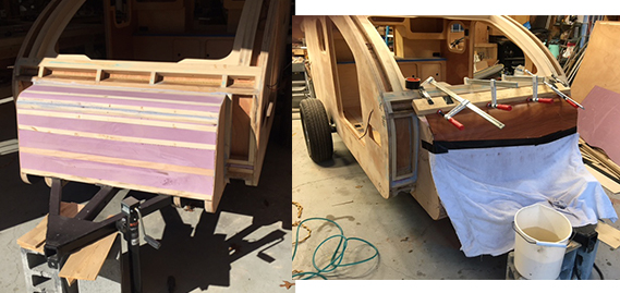

I decided to add another layer of ply to the front bump out. I noticed there was a bit of unevenness when holding a straight edge across the surface, a high spot in the middle, a dip at the corners..... etc. Bending the ply around the forms did not work so well with the first sheet with some cracking happening....... so..... with this additional layer of okoume I kerfed the underside where it would bend around the curves of the roll pans and the top curve. I also added some strips of ply to the existing surface to build up the low areas (think lath walls under plaster), sanding them down to be even with the high spots and then bondo in areas to build up. I put some hot water on the areas that bended and stapled it in place with PL adhesive. This worked out much better. Pretty flat and even with no cracking around the bends. Happy.
Also completed the insulation in the ceiling. After some bondo and clean up around the seams I'll install the roof ply.
Thanks for looking.

Those tight bends can be tricky, sounds the the water did the trick.

Bending poplar is good stuff to use for those tight bends. Instead of having 3 skins which run perpendicular to each other, they are all in the same direction, so it bends into a sharper radius than a normal 3 ply lamination.

Postby Capebuild » Sat Nov 27, 2021 11:51 am
noseoil wrote:Bending poplar is good stuff to use for those tight bends. Instead of having 3 skins which run perpendicular to each other, they are all in the same direction, so it bends into a sharper radius than a normal 3 ply lamination.
Thanks Tim.... I wish I had gotten "something" that would like to bend a little more easily (bendy birch or the poplar you mention)... for now I think I'm done with the pieces that need such tight radius bends..... but next time I'll be ready :)

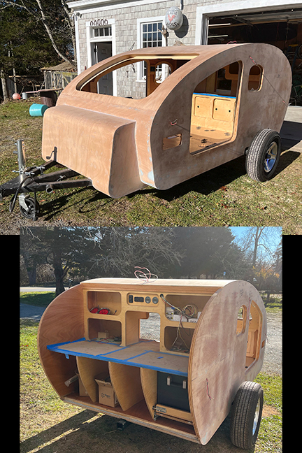

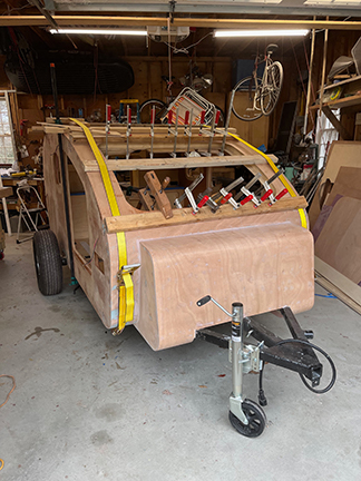

Postby Capebuild » Tue Nov 30, 2021 6:15 pm
11.30.21

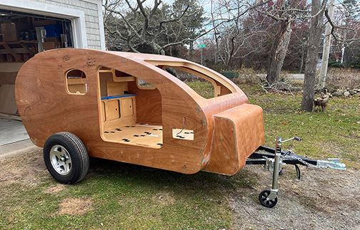

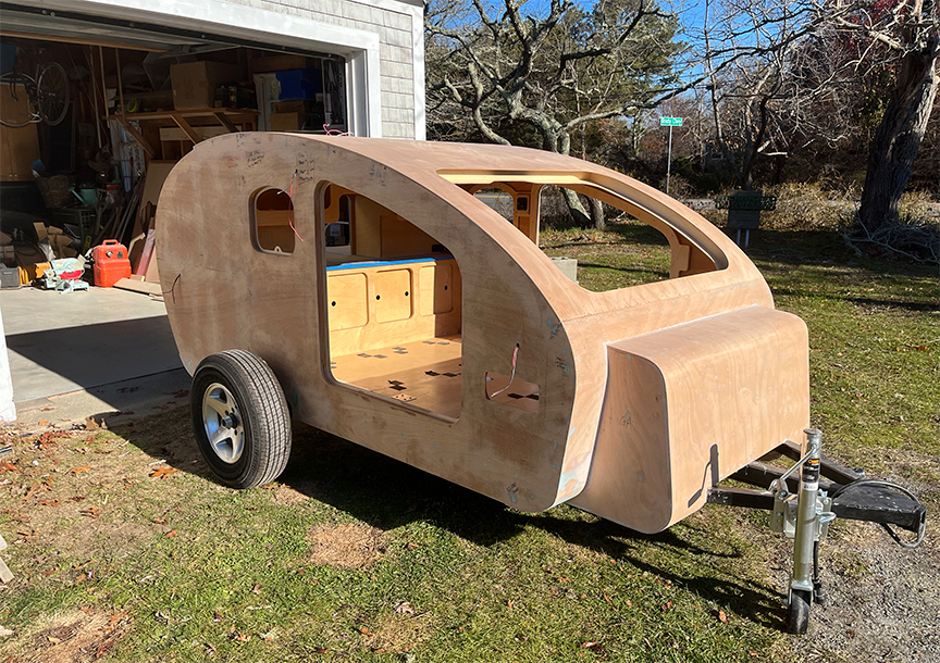

Big milestone.... .installed the roof yesterday and removed the clamps today. Routed the edges flush and cut out for the roof fan. Did some touch up here and there.
Next I'll start thinking about the galley hatch.
John
roof clamps.jpg (145.37 KiB) Viewed 1099 times
roof .jpg (645.59 KiB) Viewed 1099 times
other side 3_4.jpg (313.64 KiB) Viewed 1099 times
Capebuild

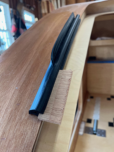

Got a few days of good weather last week and put 3 coats of urethane on outer ply layers.... so now ready to install the aluminum sheathing when the good weather rolls around..... like in April. :(
Today received another sample of window gasket for the front window. This one seems to be just about perfect. I wanted to cut the polycarb a bit larger than the opening and have it sort of sit on top of the aluminum (above the aluminum). The only downside is the recess that mates with the cabin body is sized for .125" body. When I add the okoume plyand the aluminum the thickness winds up at .196"..... it seems to tightly fit the okoume without the aluminum ..... so I'm probably going to have to cut the aluminum back from the okoume opening. So be it.... if that's what works.
The scrap piece is the same thickness as the polycarb I'll be using.

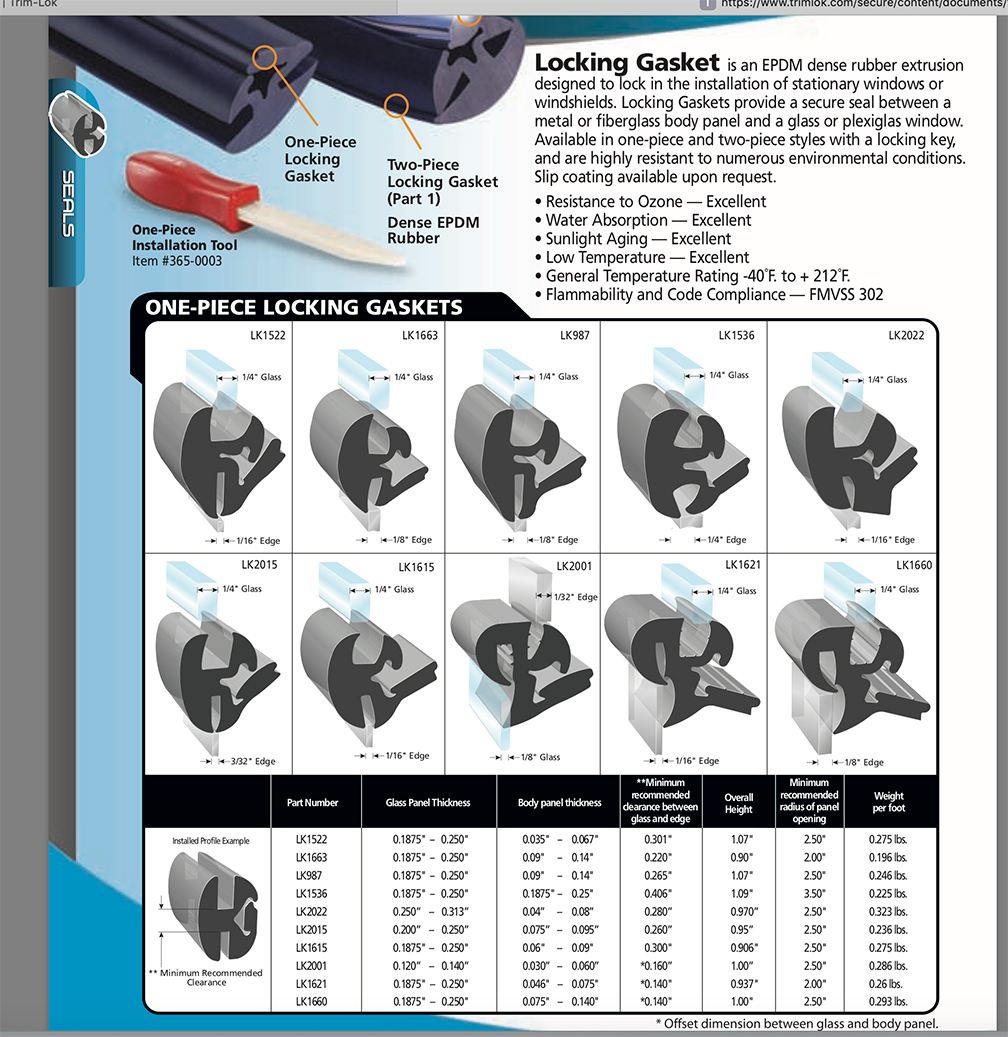

Postby Capebuild » Tue Dec 07, 2021 5:06 pm
Onajourney wrote:What was the reason not to use the TRIM-LOK EPDM?
Hi Chris.... I'm using .040 aluminum. Not sure where the .070 figure showed up.
Regarding the window gasket, the one shown in the picture from the previous post is Trim Lok model LK1660. It is EPDM material. It accepts .250 glass and accepts a .125 body panel.
My issue is, the glass fits great. The trailer's body where I as going to fit the trim is to be .196". I get that from the .156 okoume ply layer and add the aluminum sheet (.040") to get .196". So that's
a bit bigger than the .125 spec.
I think what I'll wind up doing is cutting the aluminum a bit wider than the window opening, and gingerly size the aluminum so it fits just inside the edge on the seal.... the gasket will only be
trapping the .156 okoume ply... which seems to be stiff enough. I've attached a screen shot of the Trim Lok catalog (page 38) with the LK1660 I'll be using.
John
locking gaskets.jpg (485.7 KiB) Viewed 1026 times

My mistake. I thought your skin was .125. That why I figured .07. But I guess my question is why the LK1660 and not the LK987 which I think you sketched up a while ago? BTW- I order a sample kit from Trim Lok which I think includes all of therm. We shall see.

Postby Capebuild » Wed Dec 08, 2021 5:49 pm
I was considering the 1536. I then thought it a good idea (which another builder suggested) to have the window sit slightly higher than the aluminum siding, which also requires the window to be a tad larger than the opening. I had thought an “S” shaped gasket would help but then I found the 1660 which offsets the window gasket recess from the body recess on the gasket.

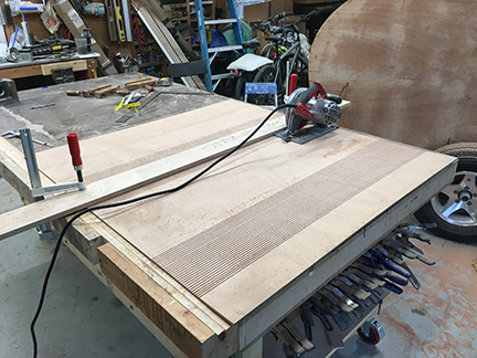

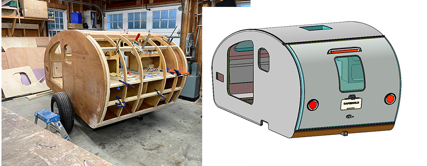

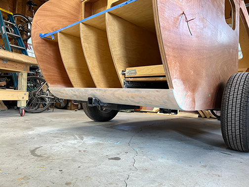

I've been working on the galley hatch (at least the design of it). Last March I had roughed it out in CAD but now that I'm getting to building it, I'm working out the finer points... adding taillights, locking mech, hatch underside puck lights, etc. into the CAD so I have a "go by" to work from.

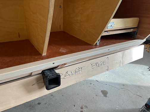

One thing that bothered me and has been causing some headaches along the way is when I first built the floor base layer and installed it, there was a slight crown that developed in the middle. Wasn't much but enough to be annoying. So as things moved along I always had to work around that high point, fitting things to account for the curve. When I installed the rear roll pan I noticed a slight gap in the middle, that crown rearing its ugly head once again......right above the rear receiver hitch. So.... thought I'd document how I fixed it.
When I placed a straight edge along the span of the roll pan there was a high point in the middle (a gap)... wasn't much, maybe .100". I'll be sheathing it with aluminum so I'd not like that gap to transfer to the aluminum. By putting the straight edge up there to span the length of the roll pan I could insert a shim into the gap up to the point where the shim went tight and I could draw a line across the shim. That way I could measure the thickness of the shim and know how much I needed to shim out in the dip. I noticed the gap was larger at the top of the roll pan than the bottom, so moving the straight edge down to the bottom did same shim measuring to get the gap at the bottom.... if I remember correctly the gap went from about .100 at the top and about .060 at about midway down and then to zero (no gap) at the very end edge of the roll pan.
I double backed 2 thin ply strips on the work table the correct length of the roll pan's curve with double sided tape (the model maker's friend) and using a belt sander, removed enough material to get the strips to taper from .100 to .060 (or there abouts).
I applied these two strips to both sides of the receiver hitch and placed the straight edge back across to check. The two ends of the roll pans and the two strips should all be on the same plane with no rocking from the straight edge.
You can see the two shim pieces on both sides of the hitch receiver and the gap which is what needed to be filled.
straight edge.jpg (145.03 KiB) Viewed 962 times
Then applied bondo over the entire surface using the 2 installed shims as reference markers as to how high the bondo filler needed to go. From the strip(s) to the outside edge of the roll pans, the gap spots could be filled in. Of course there was a lot of sanding and refilling.... and kept checking with the straight edge. I also made a curved template using the profile from the side of the trailer to check the curve along the way.
It eventually worked all to being fairly straight and a fairly consistent curve. (unfortunately didn't grab a pict of the bondo surface).
Then installed a second layer of .156 okoume ply over the roll pan shape. I wound up gingerly sanding the bottom edge of the okoume where it wraps around to the bottom kind of tapering it into the curve of the profile so there's no errant edge sticking out..... it just sticks out .156 where it meets the galley floor, which is fine since that needed to build out.

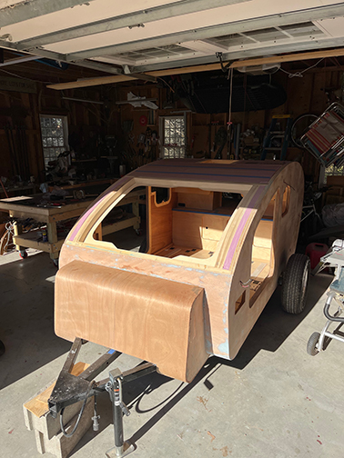

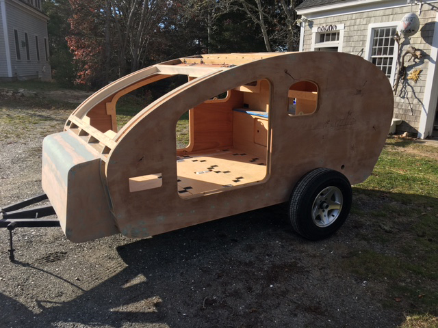

Been working on the hatch and roughing it out. Attached are some pictures. Everything is just dry fitted now(friction, clamps or double sided tape). I settled on a .250 gap on each side (there's shim's there but probably not visible). Need to notch out the horizontal spars which will mate with the notches on the vertical spars. The top on bottom horizontal end members will be oak so will need another trip to the lumber yard. There will also be an aluminum plate on the bottom of the hatch door which will land on an aluminum plate on the floor.
Thanks for looking.
