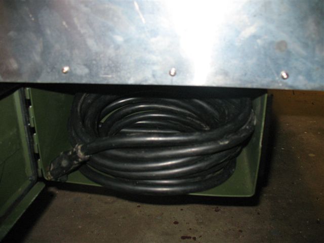

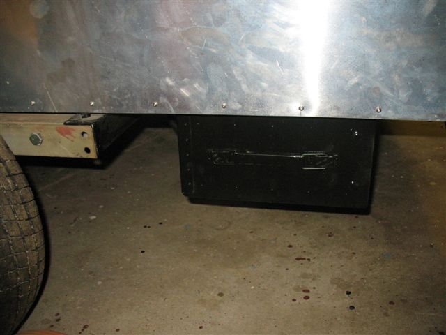

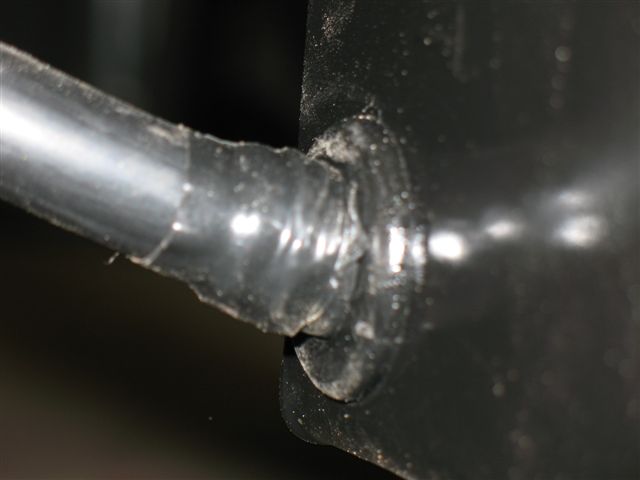

Finished up most of the rest of the electrical, except for one 110v outlet left to do. I did something a little unique with my shore power cable. Since the RV load center I got from Doug Stukey had a good cable on it, I decided to use it rather than cut a hole in the side of the trailer for a $50 RV plug. Instead, I just ran the cable out the bottom of the floor. That's the black cable (and ground) running out of the bottom of the load box.
From there, it travels over to the side of the trailer and through a grommet into a .50 caliber ammunition box. I chose this because it seals up tight and latches closed well. The rest of the 20+ feet of cable coils nicely inside the box. When we get to the campground, I just have to open the box and pull out the cable.
I painted it black to match the frame and (eventual) fenders. It's visible for sure, but doesn't detract from the overall appearance of the trailer.

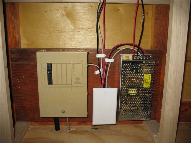

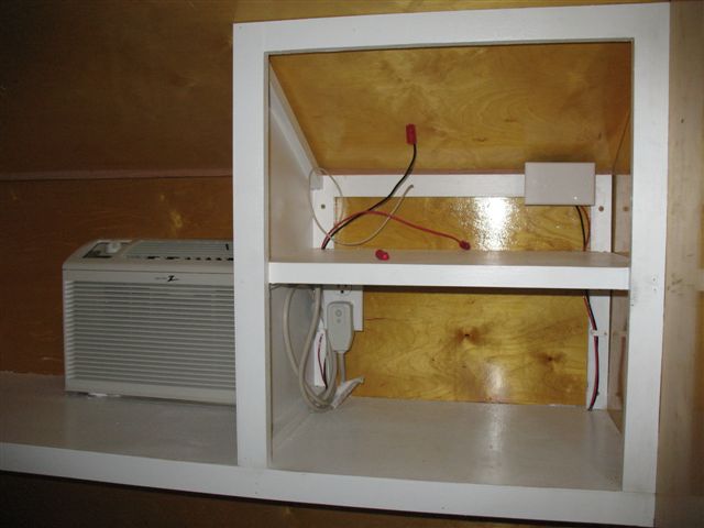

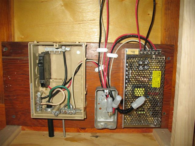

I also got one side of the cabinet frame in for the inside and wired the 110v for the a/c. The box in the upper right of the cabinet is the 12v junction box. The wires in the upper left will supply the 110v outlet for the galley, which is not in yet.
I'm still pluggin' away. I hope to have the gas springs installed and other inside cabinet frame in by the time we leave for the Show Me State.
