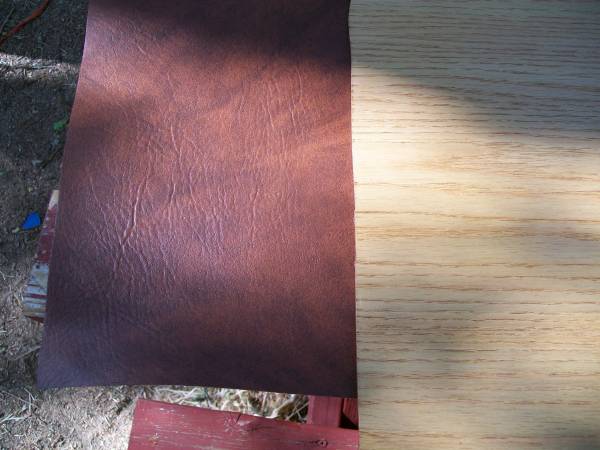

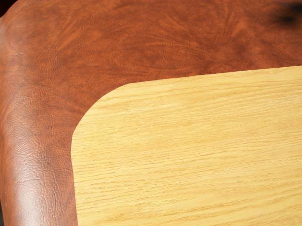

The vinyl headboard will be a light brown color that will contrast with the oak panels.
Here is what it will look like against the oak panels in full sunlight.

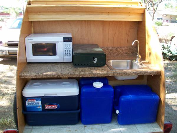

Hey there folks: I have not had much time to spend on the build lately. I did get a microwave oven at Wal-Mart for $39 the other day. I needed to have it here so I could configure the galley cabinets. I placed the big stuff on the counter to see what remaining area I had to work with for cabinets. I bought a new 28 quart cooler that is large enough just to fit in the galley. The one I already have is way too big to fit inside the galley.

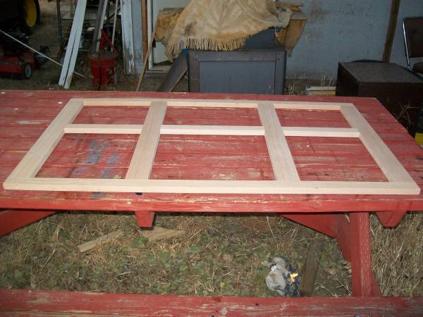

I started to build the cabin cabinet face frame out of red oak that I will seal it with marine spare varnish. I won't stain it so the color stays light. It will have a cupboard on each side with two shelves each. The upper center compartment will house the 12 volt and 110 AC electrical outlets and the wall mounted RV stereo system. The lower center opening will just be a shelf that I can set my laptop on so I can watch DVDs. I have a TV tuner set up that I can hook up to the lap top and cable when I stay at a camp ground that offers that service. Most of the time, I can watch DVDs.

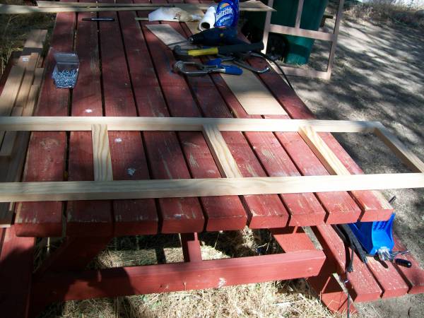

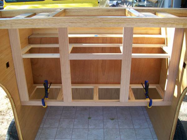

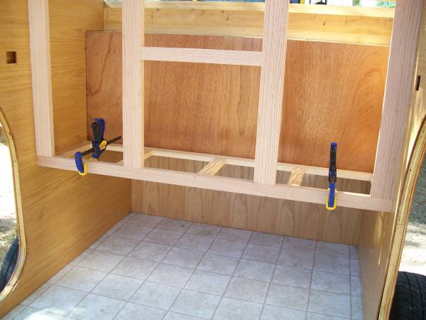

I started building the two shelves for the cabin cabinets this morning. I used my Kreg Jig set up to assemble them. Here is the lower shelf after it was put together. I made them out of pine because it won't be seen and I had a bunch of it because I used oak & poplar else where.
I just put the oak face frame in there, it is a friction fit. I will need to sand it to make it fit better later. I measured the distance to the rear bulk head to the back of the face frame and I built the lower shelf frame to that dimension.
I built the upper shelf next and it also is just setting in there. I will trim the front of the upper shelf with the oak glue on tape veneer to make it all look right.

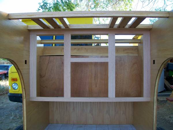

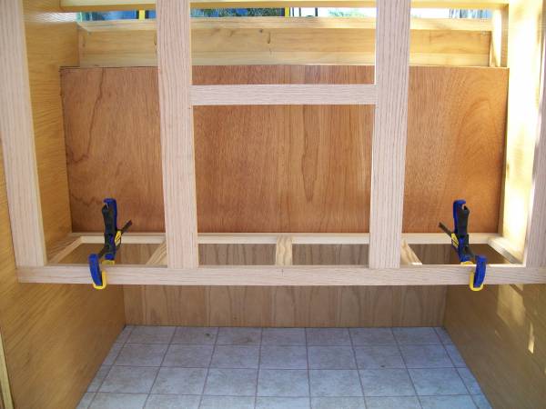

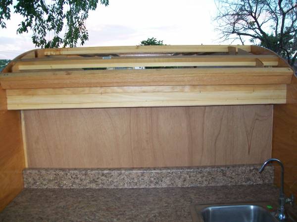

I did add some cross bars on the cabin cabinet face frame. The first picture is how it looked before and the second picture shows how it will look better finished this way. I added the two pieces of oak to cover the front of the top shelf fronts on the right and left compartments.

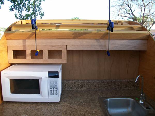

In the galley, this is what it looked like before I started to build the cabinets inside the galley.
On the left side of the galley, the three spots that are open(left to right), I will add the 120 volt fuse and master shut off switch. The second place will be for a 12 volt outlet and the cable TV hook up fitting. The third space is for a 120 volt GFCI outlet. I will add a couple of 120 volt outlets inside the cabin that will feed off of the GFCI outlet. I will make this panel so it swings up on two hinges to gain access to the wires behind there if needed. The oak will trim the pine that is behind the oak to make it all look more finished. I will leave the gap under the electrical panel so the microwave oven has adequate ventilation.
The right side of the galley I will build some cabinets that have two sliding doors on the front.
I will get more of this cabinet done asap and post more pictures when I can. Thanks everyone and take care...
