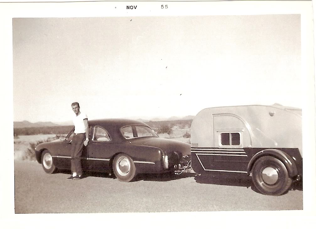

This thread has inspired me to start fixing up my original Benroy, thanks guys! :thumbsup:
Here's a photo I tracked down of a Benroy back in 1955, hope you enjoy.
