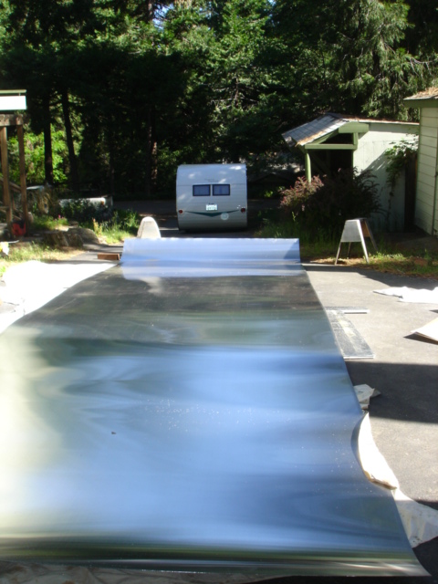

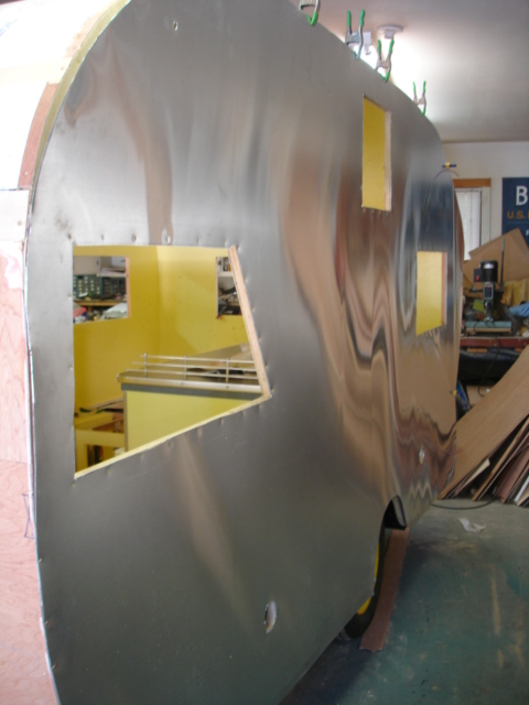

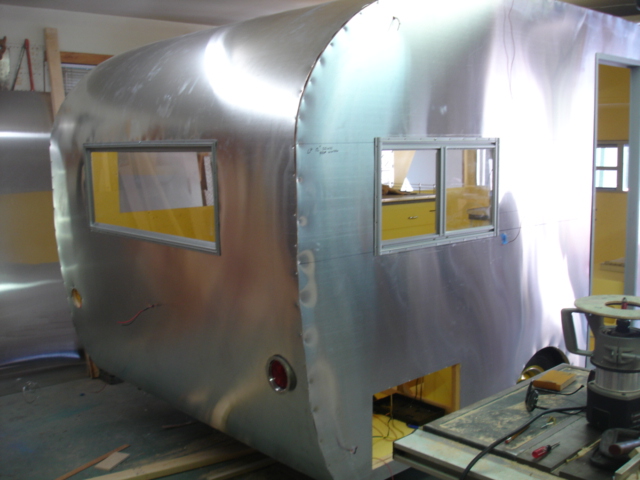

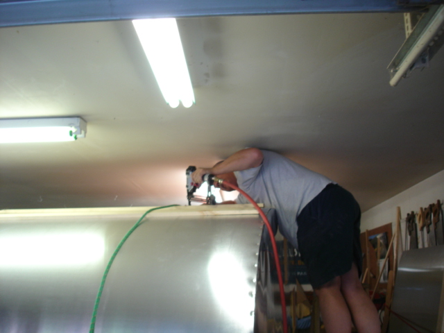

Yesterday, Steve E came by and we cut up the roll of aluminum and got 2 sides hung. 6 x 12' side pieces are a hassle to move around and get installed. The electric shear worked wonders and made the shaping relatively quick. Unfortunately, it was like 90F and with the aluminum in the sun, Steve had to hold a sheet of plywood over me so that the reflection on the aluminum didn't block out the line I was trying to follow.
Today I'll go trim up the windows closer and rout them and shoot some staples into the rest of the siding. We just got them up and hanging, windows cut out. The router doesn't like the .040 aluminum unless it's just cutting a small strip, I think a spiral bit would be a big plus but don't have one. I did the Nomad with it and it worked fine...but it was .025. We cut the remainder of the material up into sheets for the roof. It was a full day and I'm feeling beat up today. Doug

Why separate sheets for the roof instead of one continuous piece?

Greg..I have no place to paint a piece that large and I'm going to be doing a lot of this by myself. Not that it would ever happen, but if there were any major damage to the roof, a section piece would be easier than trying to cut up/repair a large single piece of material. There will only be 2 seams across the roof. None in the flattest portion. Doug

Re: Kamp King update 5/12 some aluminum on
Postby doug hodder » Sat May 25, 2013 8:03 pm

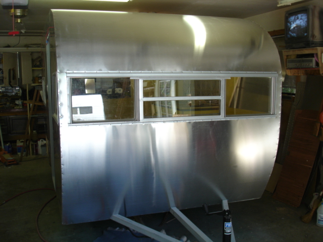

Steve E came by today and helped me get the rear and front pieces of the roof on. I have 1 last piece to put up, but it's going to have to wait until I lower the trailer. We cut it to size so it'll be ready to paint. I'll pre-paint it then do the install on it. I'm also going to put in a couple of pieces of 3/4" square aluminum heavy wall tube across the top for snow load. Older Aristrocrats had a piece of material up there and with this large roof and the snow I get, (also the original had collapsed the roof), I figured it would be a good idea.
Next step...fit up the door, build the storage hatch, scuff sand the entire trailer, and prime. It's going to get 2 colors of primer on it...dark grey for the bottom and, white for the primer under the yellow and silver section. Doug
Not a lot of room to work with on the roof.
All edges get a trim cap...it'll hide a lot.

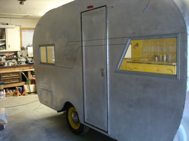

Re: Kamp King update 5/25 front and rear skinned
Postby doug hodder » Sat Jun 15, 2013 9:18 pm

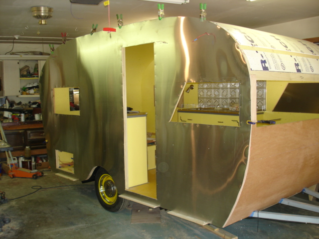

I had gotten kind of burned out on the whole thing...went to the Dam Gathering, took a business trip 1 weekend and then the weekend at Fallen Leaf Lake where this trailer was supposed to be completed for. Guess that didn't happen. It was good to see about 40 other vintage trailers out and being used so it got me re-inspired.
Today I did the final fit up on the door and cargo door, scuffed the 2 sides for paint, and got 5 windows installed plus roughed out the graphic stripe that is going on it. It will be a dark charcoal metallic on the bottom portion, light silver on the stripe with a small name badge in the vertical portion, and a yellow on the top side and roof. Plan is for a black pinstripe on all the paint contacts. Bought all the paint on Friday so as soon as I get the sides done, I'll shoot them. 3 colors of paint and 2 of primer will keep me busy masking.
I also found what I think will be some fun interior decor items. Doug
