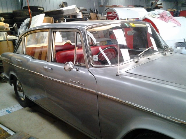

I fitted the door mirrors on the Snipe and I'm very happy with them. It took a bit of head scratching before I decided on the exact position. :thinking: After all, once the holes have been drilled to bolt them on is is not easy to move them and fill the holes. :shock:

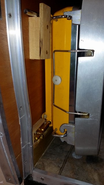

The BBQ has bounced out of its rear hanger a few times so a slide bolt was an easy fix. ;)

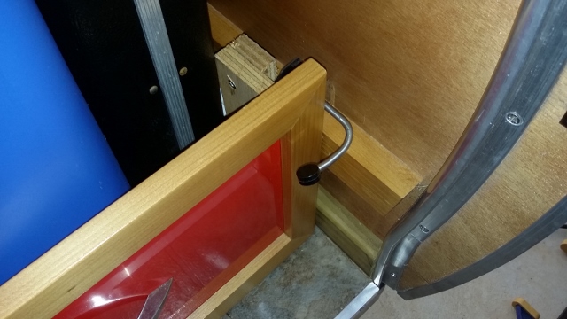

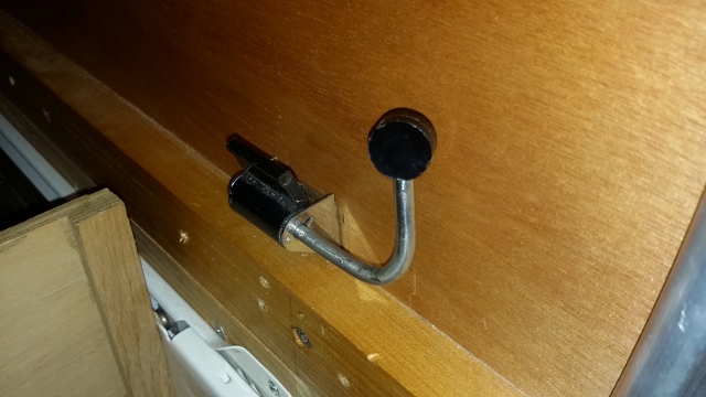

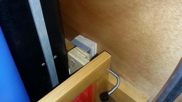

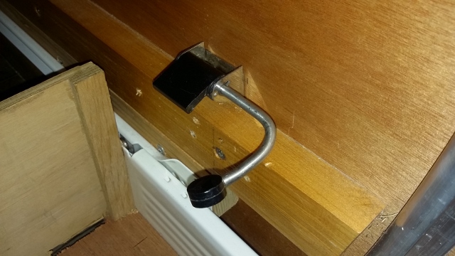

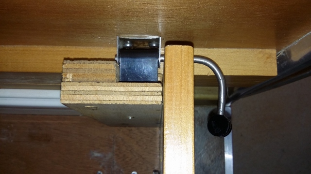

Next thing was that the magnetic catch on the chiller drawer was not strong enough to hold it, when bouncing along the road. :roll:
I didn't want to put a slide bolt on the front of the drawer and it was going to be awkward to access a catch hidden behind the face of the drawer.
After hunting through the hardware shops I went digging through a few boxes in the shed and found this. In a former life it was a stand on an electric fry pan.
I re-bent the handle, and added a couple of blocks inside the drawer :thumbsup:
I also put an alloy angle on the wall for the block to slide under to stop any bouncing.

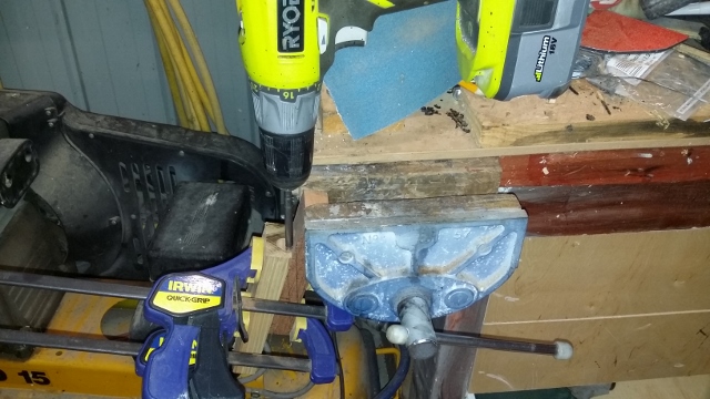

Dale had been wanting another tea towel holder in the galley, so I made her one of those glass marble ones.
I used a couple of scrap pieces of mahogany and found an old glass marble.
I started by clamping another scrap of timber to it and drilling a 16mm hole on an angle for the marble.
The other piece of mahogany I cut a step out of at less than the 16mm so that the marble will not fall out.
Then glue and screw them together, sand everything smooth, apply a coat of varnish.

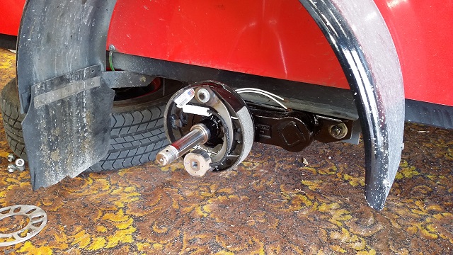

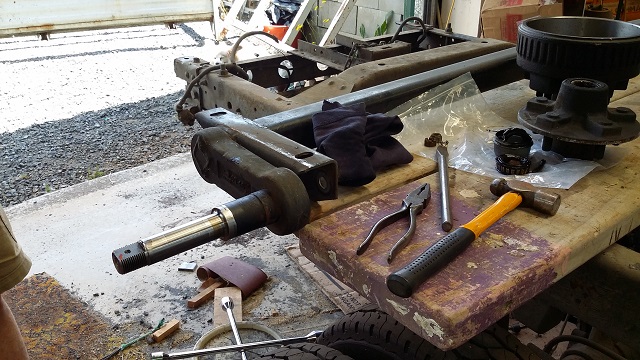

Our teardrop is fitted with a #9 Dexter torflex axle. They are not very common in New Zealand and finding components for them here at a reasonable price is not easy. The companies that were listing parts for Dexter seem to only have parts for the larger axles that would be on large caravans and 5th wheels imported from the USA.
I looked at the possibility of adapting locally available parts, but because of the Dexter having a parallel instead of a tapered stub axle the bearings in a local hub wouldn't work. I decided to go with electric rather than hydraulic or mechanical so that I could retain the ball coupling that we had, rather than fitting a big ugly override unit. I went on line and found Red Neck in the USA and sorted out all the components that I would need, including the mounting brackets for the backing plates. I emailed them to check that they were the correct parts for our axle and to get a price for shipping to New Zealand. The brake parts were about $350 our dollars, but UPS wanted about NZ$1300.00 postage :shock: :? :cry: At that rate I even looked at the thought of flying over to get them. After a lot of hunting on the net we found "You Shop". Part of New Zealand Post, they have a depot in Portland Oregon. You get the items sent to them, they load it in to containers with everyone else's stuff and fly it to NZ. That ended up about NZ $180.00 8) :D and they were here in about a week.

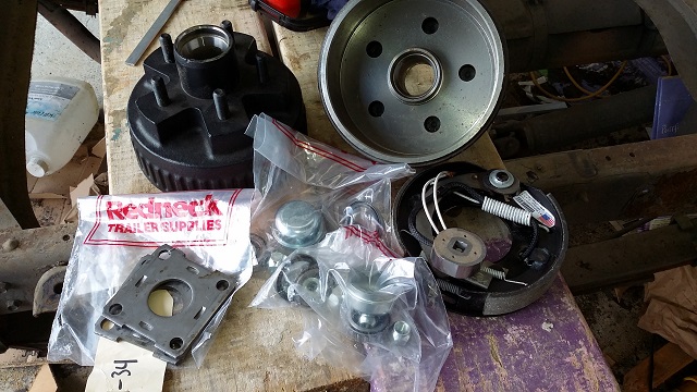

All the parts required. New hubs and drums, bearings, seals and dust caps. Backing plates with the shoes and magnets all fitted and the mounting brackets to go on the stub axles :)

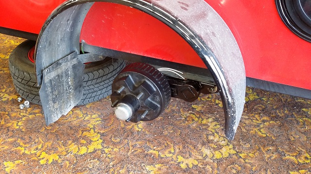

Jacked up and wheels off.

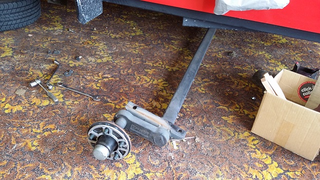

Axle removed

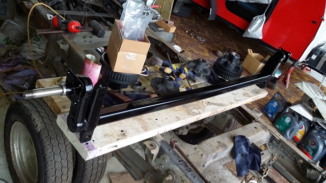

Axle on the work bench, ie. A couple of short planks over the chassis of the truck I have been working on.

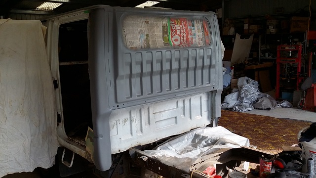

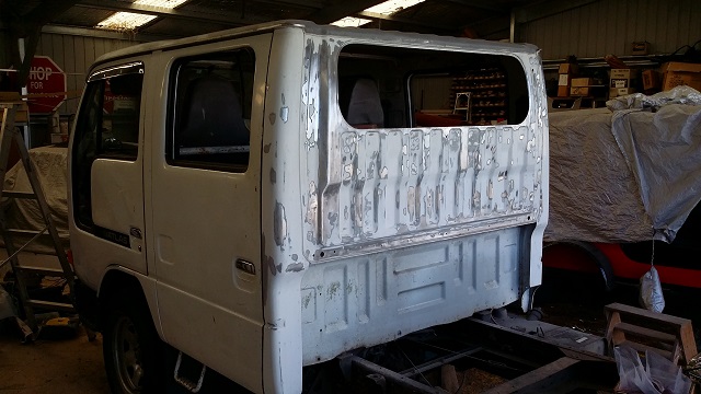

Also stripped back the paint on the back of the truck cab.
Axle in and backing plates fitted.
Drums/hubs fitted, now just need to fit the controller and do the wiring.
Rolled the teardrop out of the shed and sprayed the primer on the back of the cab.

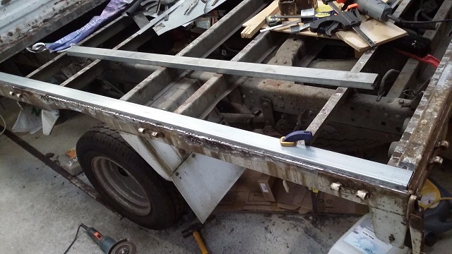

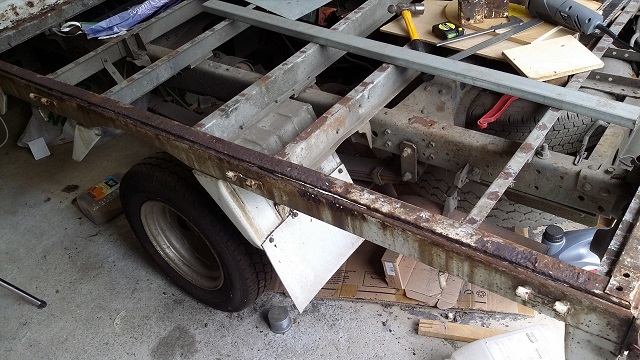

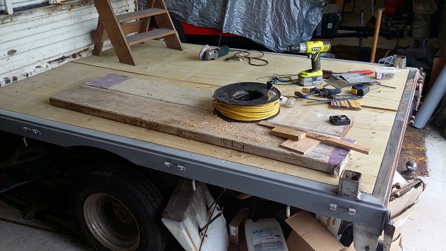

This is my old work truck. The corogated steel deck was getting a bit rusty. I chiseled the old decking off, but the side rails were a bit sad where the decking attached.
Easy solytion for that in the end was to cut out the rusty strip and weld in a length of galvanized rectangular hollow.
Ply decking and it is as good as new.
