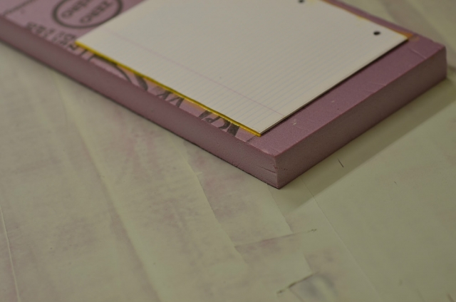

Finished rough sanding then faired the roof with 3M Premium filler, made a poor man "onion board" (to do the filler mixing) out school paper stack by gluing the edges with TB2. Next is sanding. Did a better job with fairing and mixing this time and should be no issues with sanding :ok:
Local supply shop is selling this "onion board" for over 30$, looks like this :
My home made "onion board" to mix the filler looks like this and works just as good:

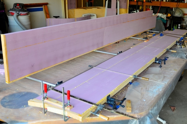

Back to the build. Glued up panels for ~13' long lifting roof sides today. There is quite a bit of extra foam material, they will be cut with a curve on top to match the roof, later. I used planer on the foam again and cut groves in the foam pieces edge for 1/8" ply inserts so when glued up they are more or less precisely aligned. Those panels must be the last big panels I needed for the build, it means I no longer need the big floor as a working table. Plan to rough cut the roof line with a good margin then laminate them flat then start with permanent installation of walls. All the best.
