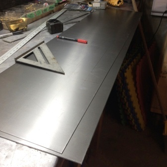

bought metal for wheel wells---made jig for same---fabricated, then moved on to sealing all the exposed wood (minus the underbelly) as the weather is about to go sour for a week and i will be busy with a juicy tile installation somewhere......so here is how the day went------
here's the 20 gauge steel
well metal.JPG (38.72 KiB) Viewed 2000 times

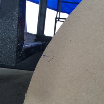

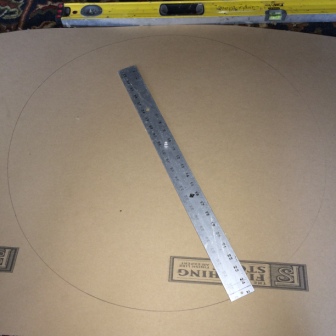

a quick compass--thumbtack, ruler, pen-in-a-hole measured to the width of the wheel well
ramboard compass.JPG (35.19 KiB) Viewed 2000 times
made a mistake here--- that pen mark should've been a few inches lower to facilitate water sweeping-away-action. oh well i can fix later

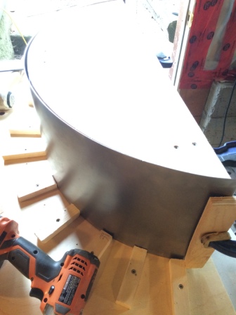

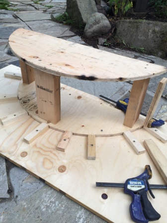

so....after determining what portion of my paper circle i wanted turned into a steel semi-circle, i then cut two pieces of ply and three 2x4 spacers. plus some chunks to hold the steel in place around the curve. the clamps and 8" sticks of wood really helpd hold the ends nice and squarish.
well jig 2.JPG (74.94 KiB) Viewed 1998 times

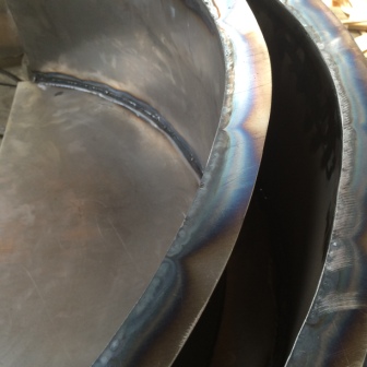

after the piece is secure, just plop on the cap and zap zap zap
well jig.JPG (46.96 KiB) Viewed 1998 times

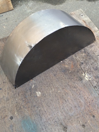

a few tacks is all you need an then it pops off the jig to be welded
well tacked.JPG (71.31 KiB) Viewed 1998 times

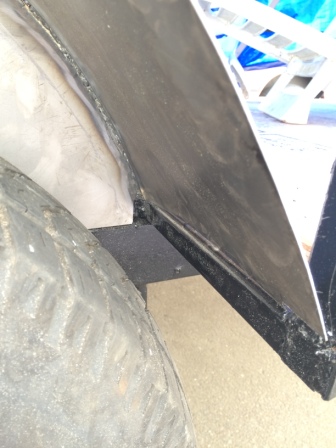

this was a mistake. i will zap and silicone on extensions later. at least the install is not a struggle this way. initially i thought it would be clever to sit the well on top of the 1x1 base but now that i have welded the two THIN pieces (and had a lot of trouble with burn-through) i think it would not be smart for me to try welding the 20 g to the square stock--as i am not the greatest welder. plus it would be better to keep potential rippage and accompanying leaks away from this spot

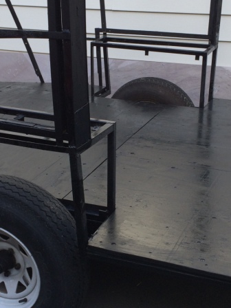

got out the old can of acrylic stain and sealed up as much as i could before the air is full of water. i didn't get to the underside but will next chance i get :beer:

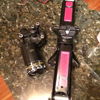

not much to report today---busy with other things but......i did go to a thrift shop and found a screw jack (5 bucks) and a windshield wiper motor (1.99 !) that works ! thinking way ahead here to the stabilizer stage....

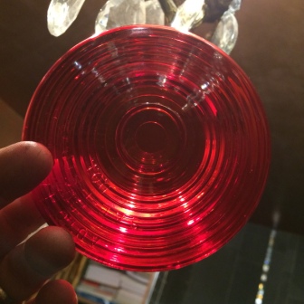

also picked up a red lens today for 3 bucks. i will be contemplating some custom bullet lights for a while....
brake light.JPG (47.54 KiB) Viewed 1948 times

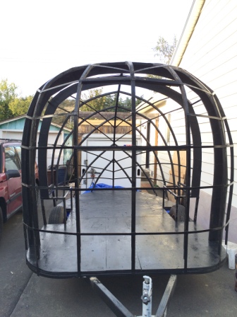

and one more shot while i'm here of the trailer cage blacked out for the wet weather. i still need to crawl underneath and seal up the perimeter, as there are gaps between the floor and frame, in the curved portions. i'm thinking of a wide (6") border of light gauge aluminum fastened to the plywood before i seal the bottom with (?)

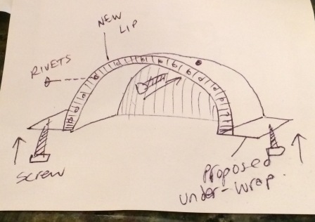

i made some progress on the wheel well design yesterday. added a lip to give the structure some rigidity, and a fastening zone at the outer skin. ideally i would like to be able to remove these wells in case of damage, or to inspect the wall cavity. the new lip will be just inside the aluminum skin, riveted to it. the other connection points will be---- behind the wheel (at the well's apex) via a screw into a tab dangling from the well cage (there presently but too short)---and on the underbelly of the trailer. when complete, the wells will wrap under the trailer at both front and back
well progress--lip.JPG (36.38 KiB) Viewed 1893 times
well scheme.JPG (35.47 KiB) Viewed 1893 times

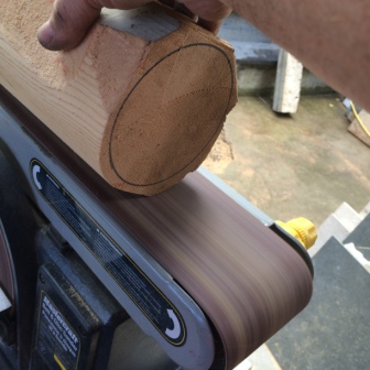

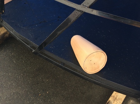

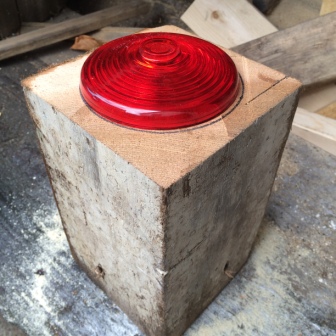

another thing i started was a brake light form. started with a random chunk of cedar and began reducing it until i ended up with this shape. i'm not sold on it yet, but it does have pleasing a-symmetry about it, and the proportions aren't totally bad, but.........maybe little pointier--we'll see

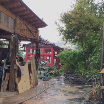

Nice work.
I'm curious about the red structure with all of the windows. Is that like a three season bonus house or pool/bath house?
Keep up the good work. :thumbsup:
Re: go ahead, call me crazy !
Postby dave campbell » Sun Sep 20, 2015 8:31 pm
KCStudly wrote:Nice work.
it's the three season bonus house !! sometimes a bedroom, sometimes a space to play ping pong, sometimes workshop---motorcycle parking, storage, and full time cat house.

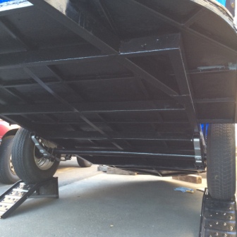

a sunny day, so i first hit the underside with an acrylic based wood stain, then hit it with some spray-on rubberized asphalt stuff. three cans today and some touch ups tomorrow, where i had to do a bit of caulking.......
seems like she's sealed up pretty tight !
